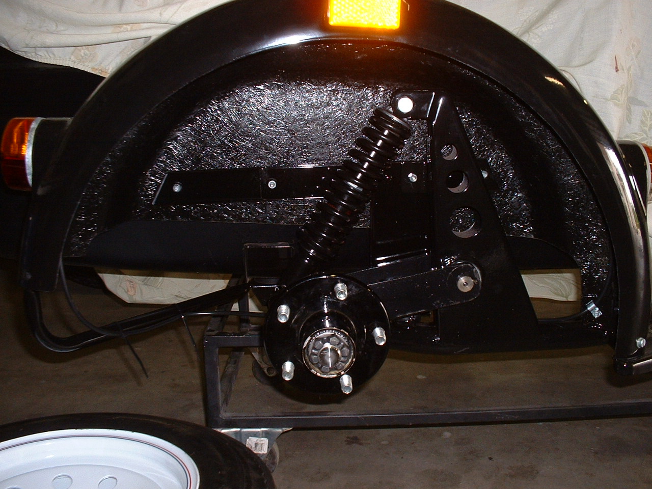

I use a proprietary heavy duty swing-arm in my conversion. The OEM swing-arm is too flexible and the shock positioning doesn't allow for adequate leverage to support the heavier motorcycles.

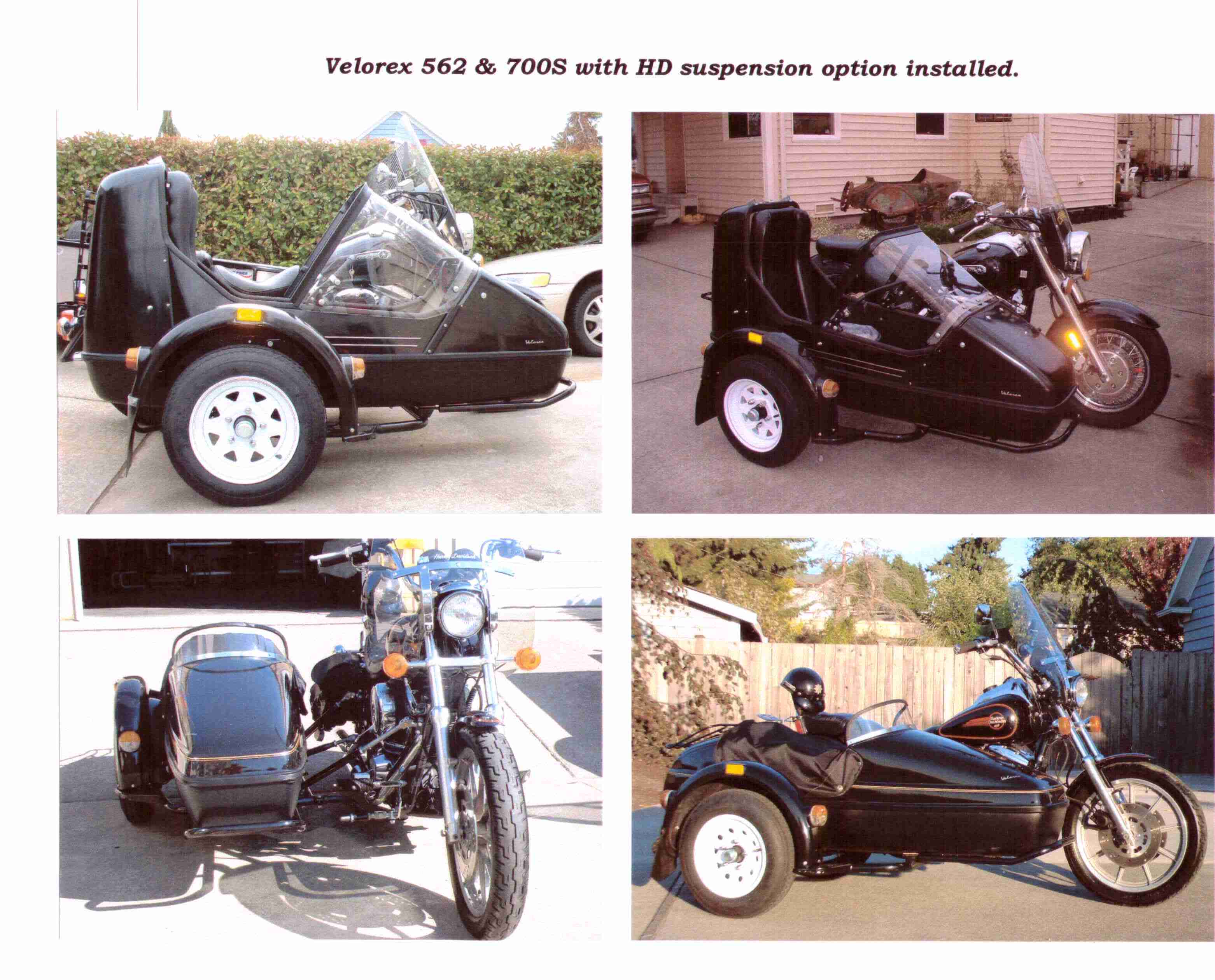

Here's how it looks with different wheel choices.

Conversion consists of redesigned heavy duty swingarm with 1" axle, high speed marine hub with Timken bearings and releveraged shock mounting.
We used to include the mounted wheel for $40. more, but now wheel/tire shipping almost costs as much as a wheel/tire combo does.

Yeah, I can understand that. I can't tell from the photos what size wheels those are. Will a standard 13" 5-bolt trailer wheel fit in there inside the fender?
Posted : May 2, 2016 1:05 pm
I use 4" on 4 hubs now since most preferred them and the 5 lugs were overkill. A standard trailer wheel fits as shown in the pix. That's what we used to ship with the conversion. Some preferred their choice of wheel and could get it locally.
Like 12" wheels, 13" wheel/tire combos come in many diameters and widths and the offsets vary between mfg'rs.

To be clear, if I buy a standard off the shelf 12" trailer wheel/tire it will fit inside the Velorex fender?

Yes it will fit, Bob, As pictured.
