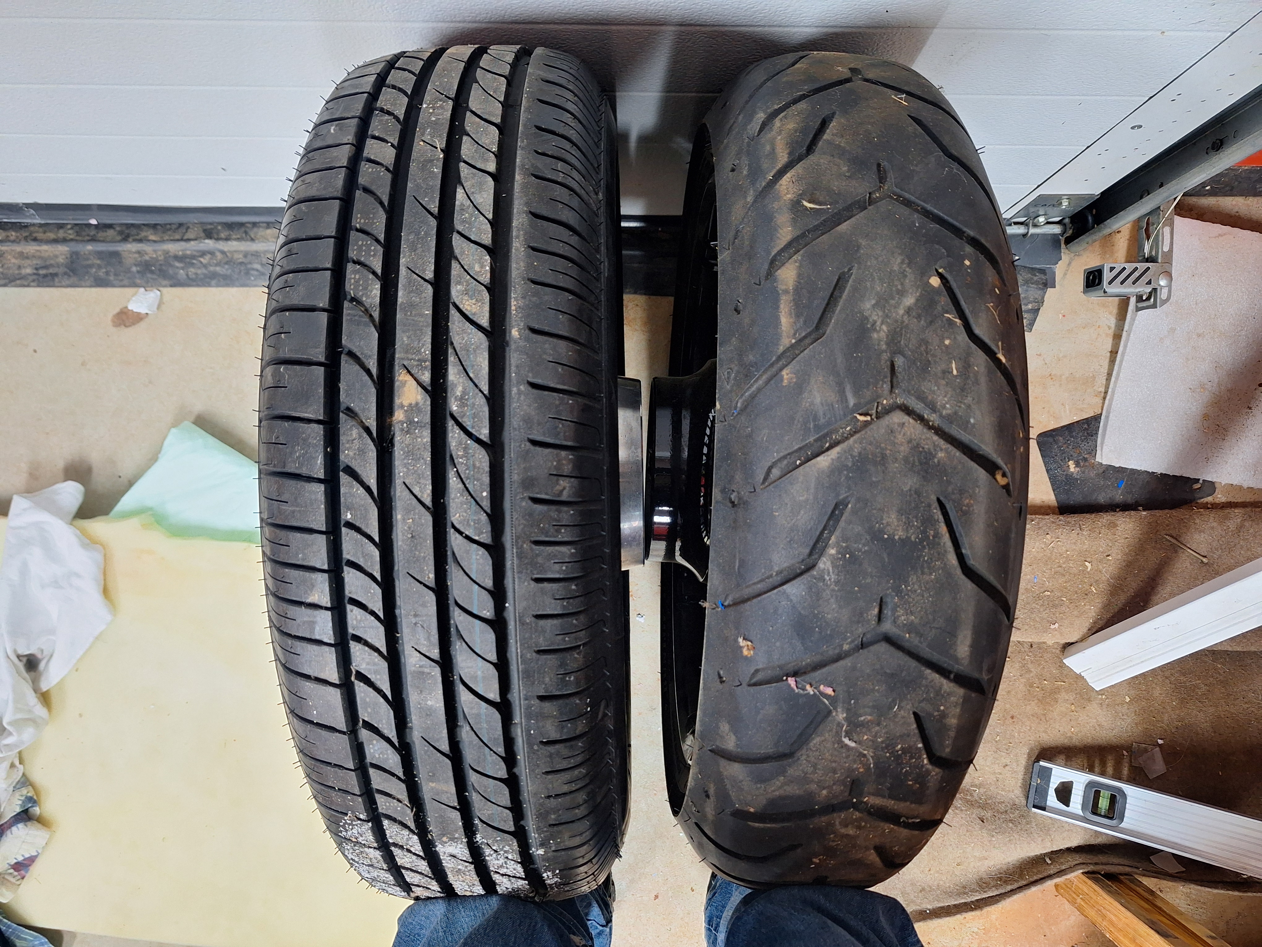

This was just installed today.
Stock is a 180/55 18
Car tire is a 195/65R 16
The change comes out same height and 6 tenths wider. I keep a factory wheel and tire ready if I take sidecar off. Side by side.
