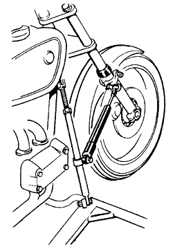

here is a very good diagram on putting on a vw steering dampner-- go to sidestrider.com and click on steering dampner.-- I may put one on my rig
Posted : December 16, 2008 5:04 pm
here is a diagram if it turns out-- best to go to sidestrider to get more details
Posted : December 16, 2008 7:02 pm
Personally, I don't care for the VW style if you spend a lot of time in city traffic or at slow speeds. It really makes steering a chore until you get up to about 30 mph. The better(pronounced Much More Expensive)ones tend to be very easy until they meet an oscillation. They can sometimes be a trick to mount though. http://www.exoticsportbike.com/arrow_steering_damper.htm
This one mounts below the gas tank, between the frame and triple tree.
Posted : December 17, 2008 3:15 am
The more expensive steering dampers that are made of billet aluminum and therefore obviously "better" are not just expensive they are ridiculously exorbitant. For example, from the link that you provided a damper for a CB600F Honda Hornet sells for $329.99 plus another $169.99 for the installation kit. That's $499.98 plus tax if any and shipping. That's out of sight!
I guess one reason I never have a problem with the VW style on my HD is that I never spend much time in traffic. Harley sells their damper for close to $100. It's really a Brazilian-made VW damper and it's the same as the ones that the auto stores sell for $29.95 or so.
The way the damper is mounted on the Harley, it is centered at the rear of the front fork with a very short length of leverage operating it. Mounted as it is, it really doesn't move very far so it's not all that bothersome at low speed. The links above show the damper mounted on the outside of the fork, fairly far away from the center with a much longer leverage distance. This would cause the damper to move farther for any given movement of the fork and thus have greater resistance, at least the way I see it.
I guess some folks will pay $500 for a steering damper. I prefer to spend my money on other things.....such as food, clothing and housing. LOL.

Do you have a part number on your damper? I have shopped NAPA, but they don't have one as long as mine. Also, the strange named fitting on the one end, does it have to be crimped on (swaged) or do they screw on? I agree with you totally that the less travel, the better it is. Plus, I do not have the geometry that it takes to follow the example. Send me something if you have it.
Thanks!
uber

Here are part numbers and sources:
The Harley steering damper (made in Brazil) is P/N 87141-83. they liost for around $100, a little less than I mentinoed earlier. Don't buy one from Harley, though.
The VW Steering Damper: Available at many VW aftermarket parts sources:
http://www.jcwhitney.com/VW-Steering-Stabilizers-Dampers/600007511.jcw
http://www.prostreetonline.com/m/volkswagen_steering-damper.asp
Just go to Google and type in keywords "VW steering damper". There are a couple of different model cars that they fit. Mostly any Beetle from around the late 60'sd to the early 70's would be OK. They are the same as the one that HD uses. they are ideal for a sidecar due to the low prices and availability from VW aftermarket stores and online. They are also very easy to mount. One end has a typical shock absorber mount with a rubber bushing. The other end has a metric thread at a 90 degree angle. you might have to use a piece of strap metal and adapt that end but it can be done.
The ones I have and all that I've seen are sealed hydraulic units and are non-adjustable.
Good luck.
