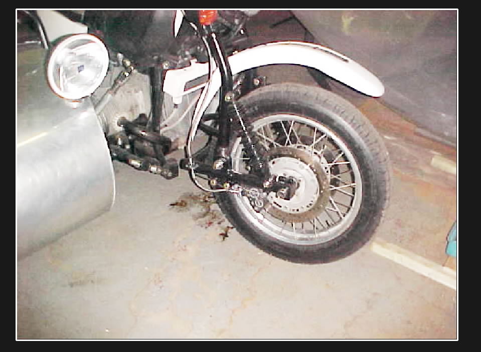

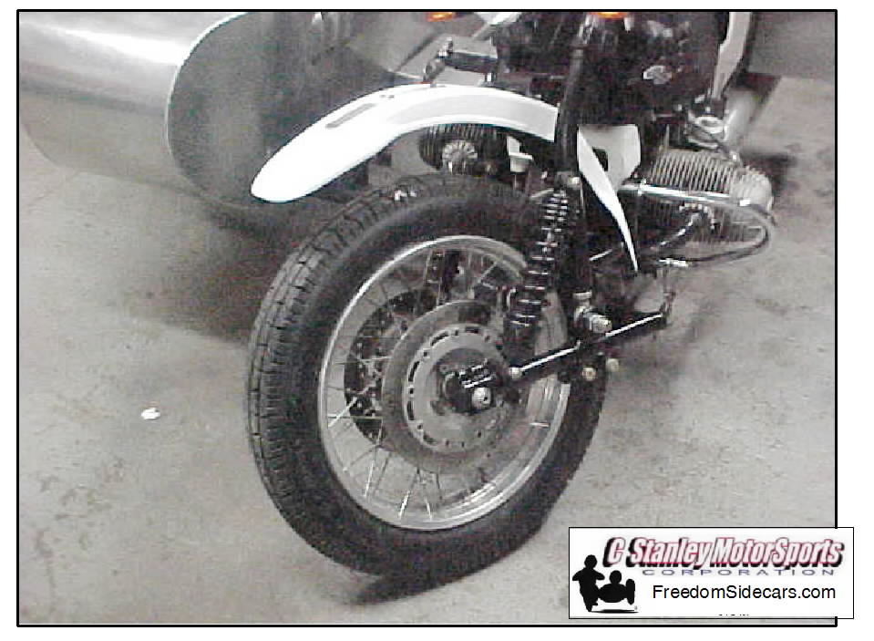

Some prefer more trail than others. Personally I prefer some feel of the road so run a tad more trail than some may like. There is no macho deal either way and if able to do so you will settle on a trail setting that feels 'right' for you. My rig has about 1 1/2" of trail. Racers may run down to zero static trail.
Lots of things to consider in addition to just trail.
1)Floating vs fixed calipers is a big consideration of course.
2)What to use for pivot bearings?
3) What materials to make th eforks tubes and the swingarm out of.
4) Pivot point location on swingarm related to amount of bend in fork tubes.
5) Shock spring rate
6) Fender mount design
7)swingarm angle after initial sag is set
If the trail on the front end you have now is known you can just measure from the front axle back to a reference point on the bike. This will allow some easy calculations to reduce the trail by 'x' amount when you do your leading link regardless of rake angle etc. You must make sure the ride height remains the same to be abel to compare apples to apples.
You could make the trail adjustable of course. Various holes will work placed maybe an inch apart for mounting the fork tubes to the swingarm.
As far as the pivot point location goes I am just about convinced it is a Chevy vs Ford argument. There are leading link designs out there with the pivot point placed all over the place. In theory the trail will change more on bump and rebound with a short effective swingarm but heck the sidecarcross racers run a very short coupled design as a rule and do well. Of course short means less chance of flexing etc...yadda yadda.
If you click on the link below you will see quite a few different leading link designs.
http://www.advrider.com/forums/showthread.php?t=308801&highlight=leading+links
or if that did not work click here:
http://tinyurl.com/4hrxkl
Attached is a picture of one of our CSM leading links. This one is on my own rig and has adjustable trail.
