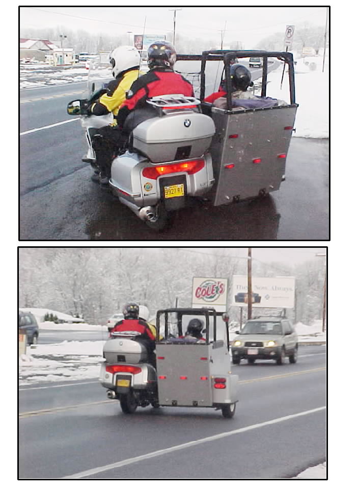

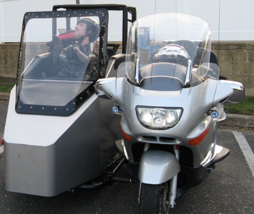

I have attached some pics below.
First one is a collage of Life Motors (Tomco)rigs.
Other 3 are pics of a rig we did for a wheelchair. In fact this family showed up at the shop yesterday on the rig to say hello right after we got 6" of snow. See last picture.

That looks like Rumpstun's Valkyrie in the top photos.
Posted : November 22, 2008 5:02 am
Originally written by SidecarMike on 11/22/2008 11:02 AM
Dunno Mike...pics at life motors:
http://www.lifemotorsinc.com/wst_page6.php
Posted : November 22, 2008 5:18 am
