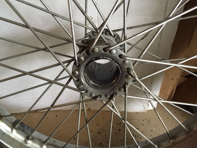

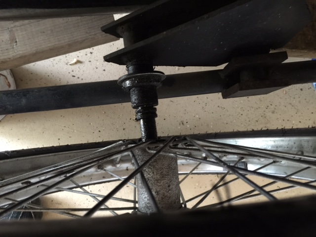

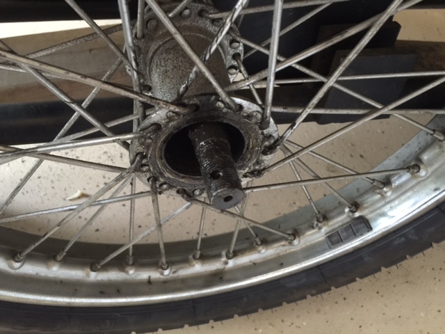

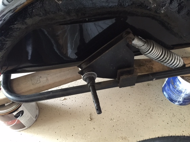

I have a 2004 Honda Shadow with a Texas Easyrider sidecar. I was out riding over the weekend and it was making some weird noise. I pulled over to take a look at the tire on the side car. The tire was completely off of the rod that it slides onto. I was told I need new bearings but I'm having trouble finding someone that will fix this for me. Does anyone have any ideas on how I can fix this or what to do? I'd appreciate any info that I can get. I need to get this fixed asap so I can get back on the road again! Thank You!!!

If the hub is undamaged, remove any remaining outer bearing races. Obtain two sealed bearings that are a press fit into the hub and will slide over the spindle. They may be ball or Timken bearings so check bearing sources for tightening specs.

To get new bearings for the rig you will need three dimensions: ID, OD, and thickness. Also, insure both sets of measurements (inboard side of the wheel, and outboard are the4 same). The measurements will need to be fairly precise. Use a vernier caliper and measure to the nearest 0.001 inch if it is an inch and 0.01mm if metric.
ID of the bearing is the diameter of the axle. OD of the bearing is the size that will press into the wheel hub. Thickness is how much room there is for the bearing on each side of the wheel.
As 'Hak'n" wrote above, you must remove the race from the wheel to replace with new sealed bearings.

And don't forget that many sidecar wheels have a spacer tube and potentially some shims between the bearings.
