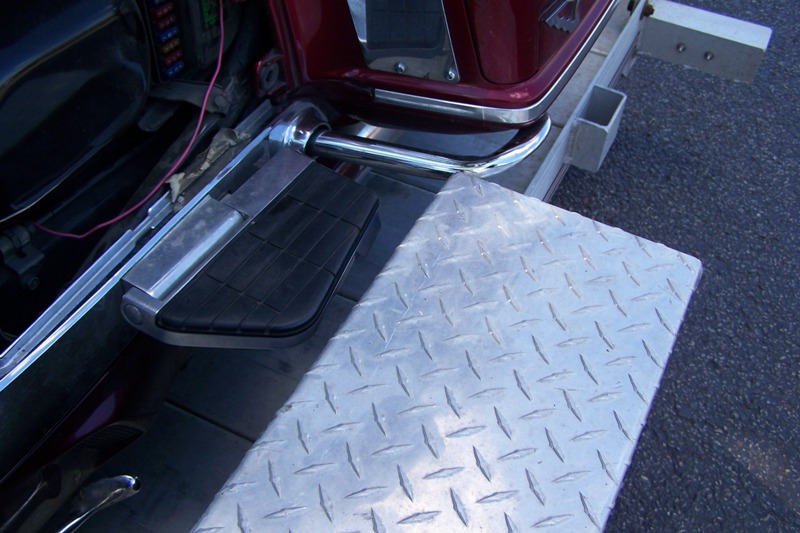

Remember too that the wider you are the more stable, i.e. not having to worry about the sidecar coming up unexpected. My Goldwing/Friendship 3 won't fit between the fenders on my 80 inch wide trailer.
Posted : November 28, 2012 1:19 pm
"Remember too that the wider you are the more stable, i.e. not having to worry about the sidecar coming up unexpected. My Goldwing/Friendship 3 won't fit between the fenders on my 80 inch wide trailer."
Thanks for the tips & pics! I'm disabled so extreme offroad isn't an option. From that, I can't go anywhere that I couldn't go in my full sized truck. As long as I stay within its dimensions the outfit should be good to go wherever I'd want to go.
Stability is a major issue because the roads I travel most often here are wild twisty mountain roads, very challenging and demanding. The rig can use all the track width possible, just so it fits on the roads!
Edit to add: Very nice outfit, very nice trailer!!
Posted : November 28, 2012 1:57 pm
