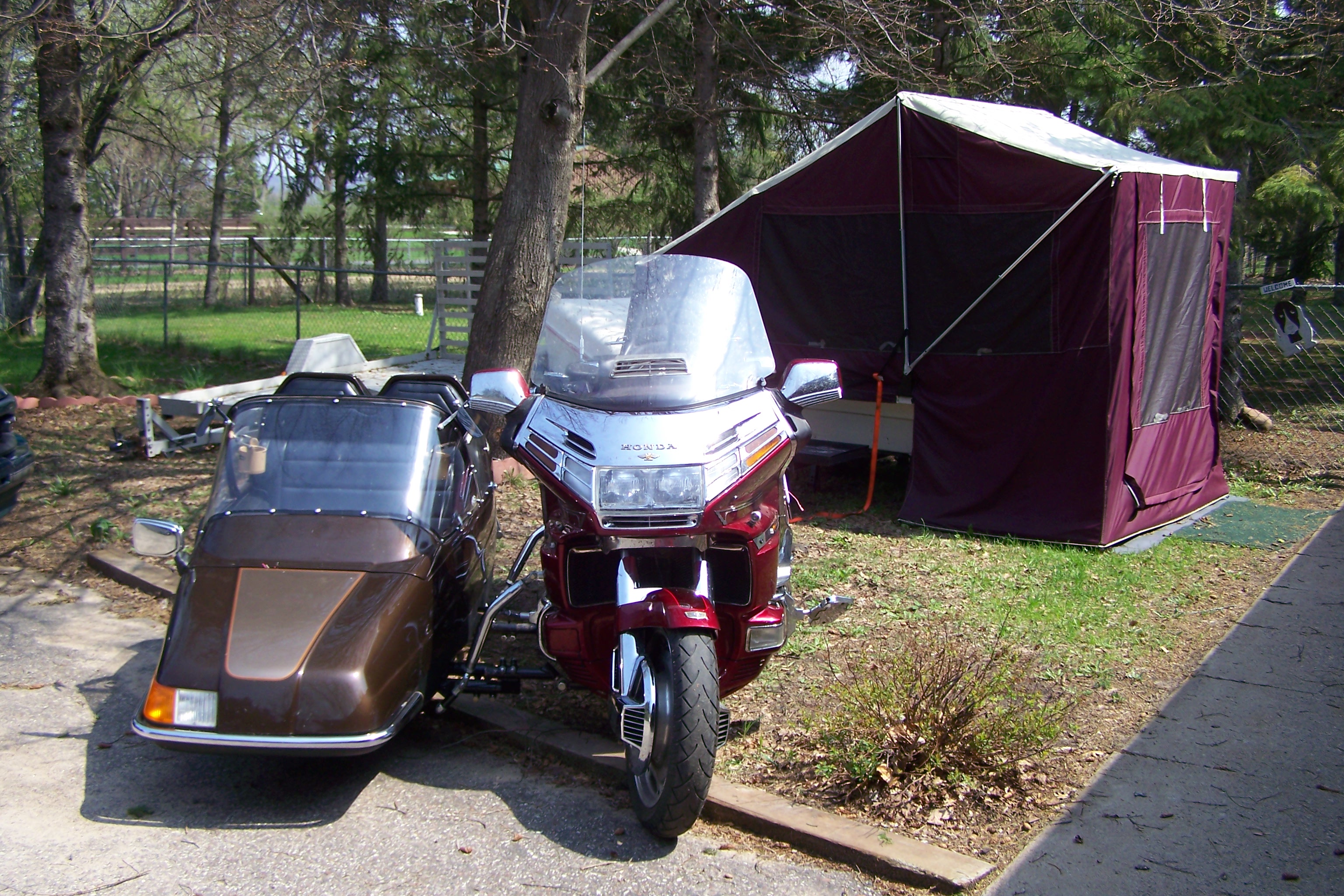

I was quoting you in your opening question. Just the same, the 1/3 figure is the most common used. My Goldwing weighs 804 pounds, but goes over 1000 by the time I get on it with all my gear. My empty sidecar, which is the way I usually travel, weighs 225 pounds.

Doggone it, Mike, then ya gotta go and post up that pic of a great outfit and that very cool tent trailer, just feeding fuel to my latest obsession! Right square in the center of my plans: a long distance road tripper hauling a trailer which I'm also currently designing.
Mine's to be a cargo rig, vaguely similar in body lines to your pic. If you shaved off all the accoutrements on top like windshield and aero mount, and lopped off the raised headrest etc. and eliminate passenger accomodations that's real close to my plan. To simplify things I'm going with flat aluminum sheet top, sides and bottom in an aero wedge-nosed design that also has some taper end effects in the rear, stretched over a 1-1/2" x .1250" angle-iron subframe, on top of a 1-1/2" x .1250" DOM tube chassis. Tug is my '96 Kawasaki KZ1000P-15, all original.
Hope it will look okay but function is way ahead of form here. First is aerodynamics, then good size for ample cargo, separate compartment for 6 gallon poly fuel cell, deep cycle battery, small compressor etc. and as inexpensive as possible to build.

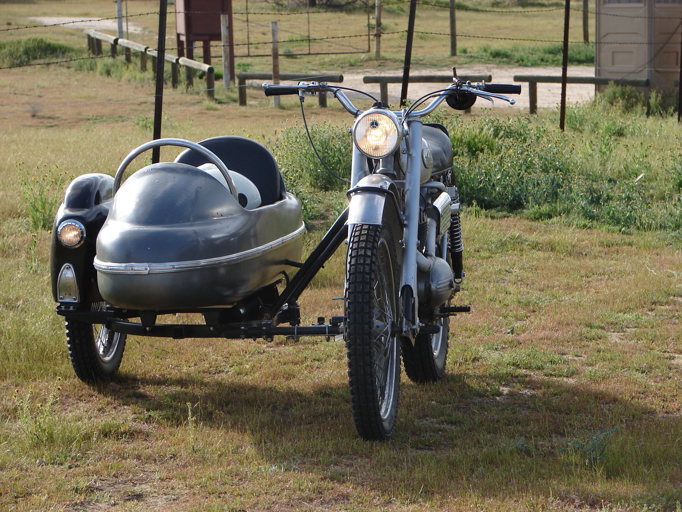

When I built my Greevorex I followed the lift rule.
Standing beside the bike, one foot on the streetside peg and both hands on the bars, you should be able to lift the sidecar off the ground with reasonable effort.
Not easily but with effort. The rear shocks were the trick for me. The stock trials shocks (1960 Armstrongs) were way too soft, I used a set of BSA B50 MX shocks set at the highest setting.
That eliminated the wallowing I initially experienced and allowed me to set up a proper preload so the bike assumed the correct leanout with me aboard.
The Greeves only weighs 215 or so as a solo, and I pared the 560 Velorex down to 130 lbs. Seems to be a good rig and has proved to be very capable.
Don in Nipomo
