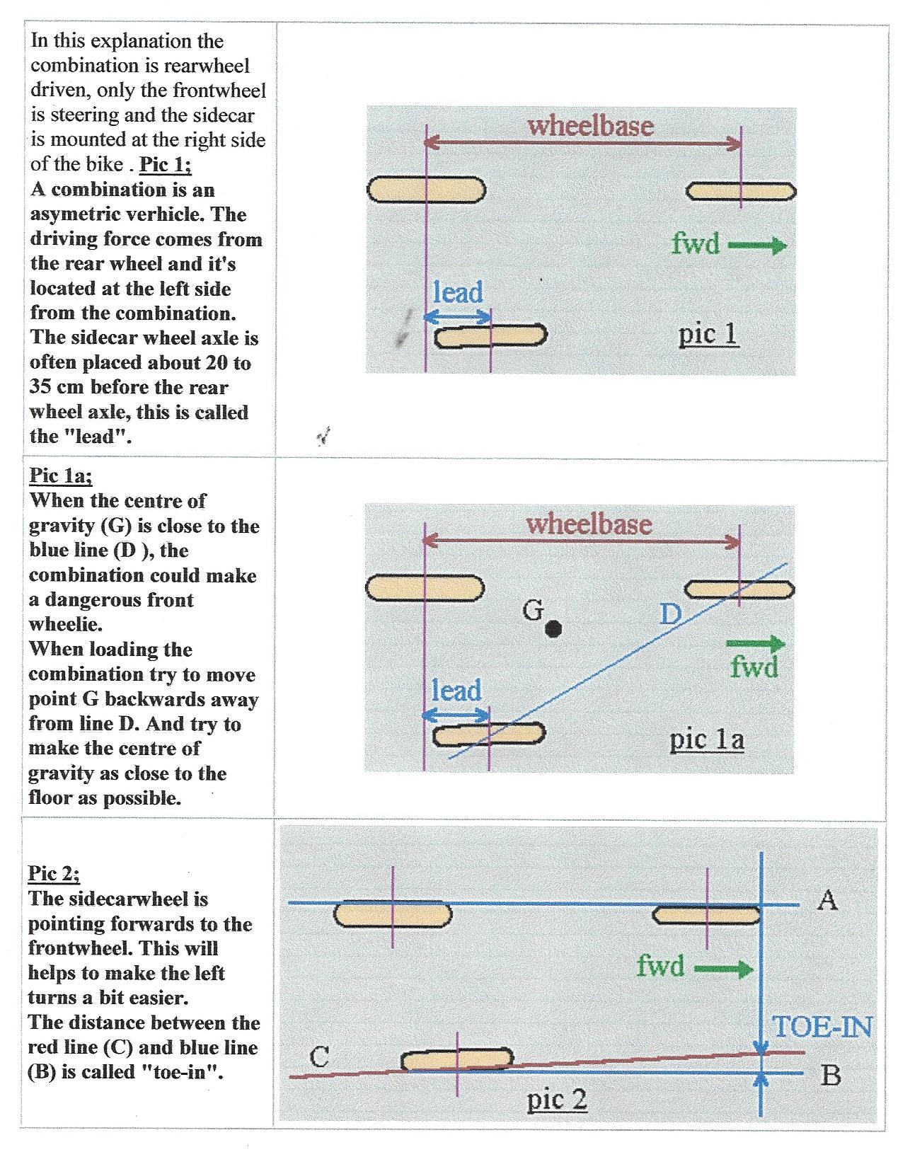

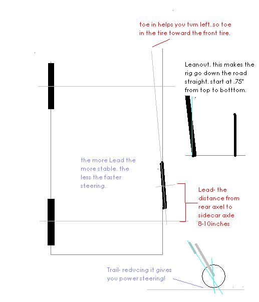

I hope this might be of use to you.

Thanks Tom. I will try to up the front tire pressure to see if it helps with head shake.
My heavy steering is due to the damper so I am looking at the possibility of taking a suitable air cylinder going hydraulic with light oil and putting in a bypass valve that I can adjust to apply just sufficient damping to stop the head shakes. I have the steering bearings pretty snug but that did not really help much. I would love to get rid of the damper, so I keep trying. I have got sufficient miles on the rig to find everything that comes loose and have pretty much done the blue loctite or nylock thing to cure that That check list is really a good piece of info.
Question is a little occasional head shake normal or can it be completely eliminated         Thks Chuck
