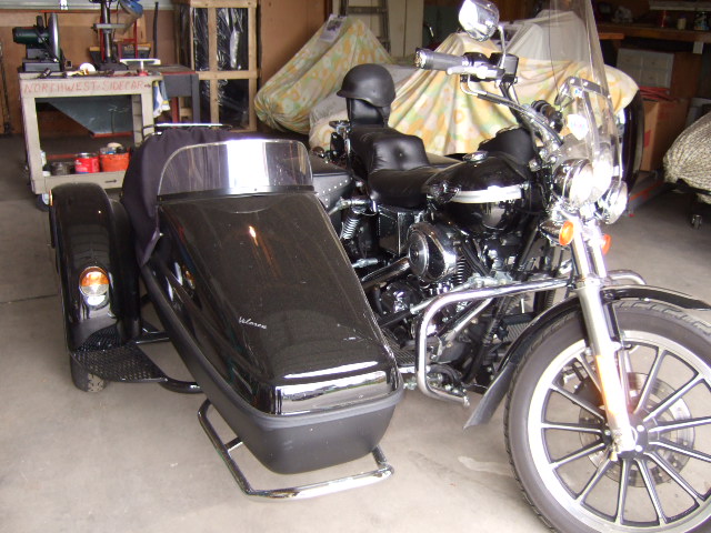

Thanks for all the info. I did pick up a piece of Lexan and cut it with a sabre saw with a "wood" blade. No problem at all. Drilled the mounting holes and bolted it up. Looks good and I still have the original in case I need to change it back. Thanks again for the help. I hope to meet some of you folks at the rally in June. Allen

On my smoked lexan screen, I used some windscreen trim from cyclegear.com.
http://www.cyclegear.com/spgm.cfm?L1=&L2=&L3=&L4=&item=MRX_WT1_G&tier2=14
Looks great and the fit is very tight. You can see it in my user profile photo.
