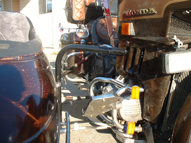

I have a 1981 Goldwing 1100 I with a Honda full fairing and motor guards.
The motor guard on the sidecar side appears to be in the way. Is it necessary to remove the motorguard so that the upper mount can be attached? Is their some way I am not seeing in order to attach the upper mount bracket?
I guess since I won't be have to worry about damage to the motor on that side, removing the guard is probably the answer I am looking for, but isn't the motor guard necessary to keep from burning ones leg against the motor head? I also have pegs on the motor guards so I can stretch my legs out when cruising down the highway I'd like to somehow keep. without the motor guard, I won't have a peg on that side to stretch my leg out to.
any suggestion or remidies?

Remove the gard and use the mount to put your lage on that's what i did

Usually the right side engine guard is removed since it's function is it save the cases from damage if the bike is dropped. This shouldn't be a problem with a hack mounted. Some have attached a footrest to the upper strut. Some use the strut itself. Some mounts go around the guard.
