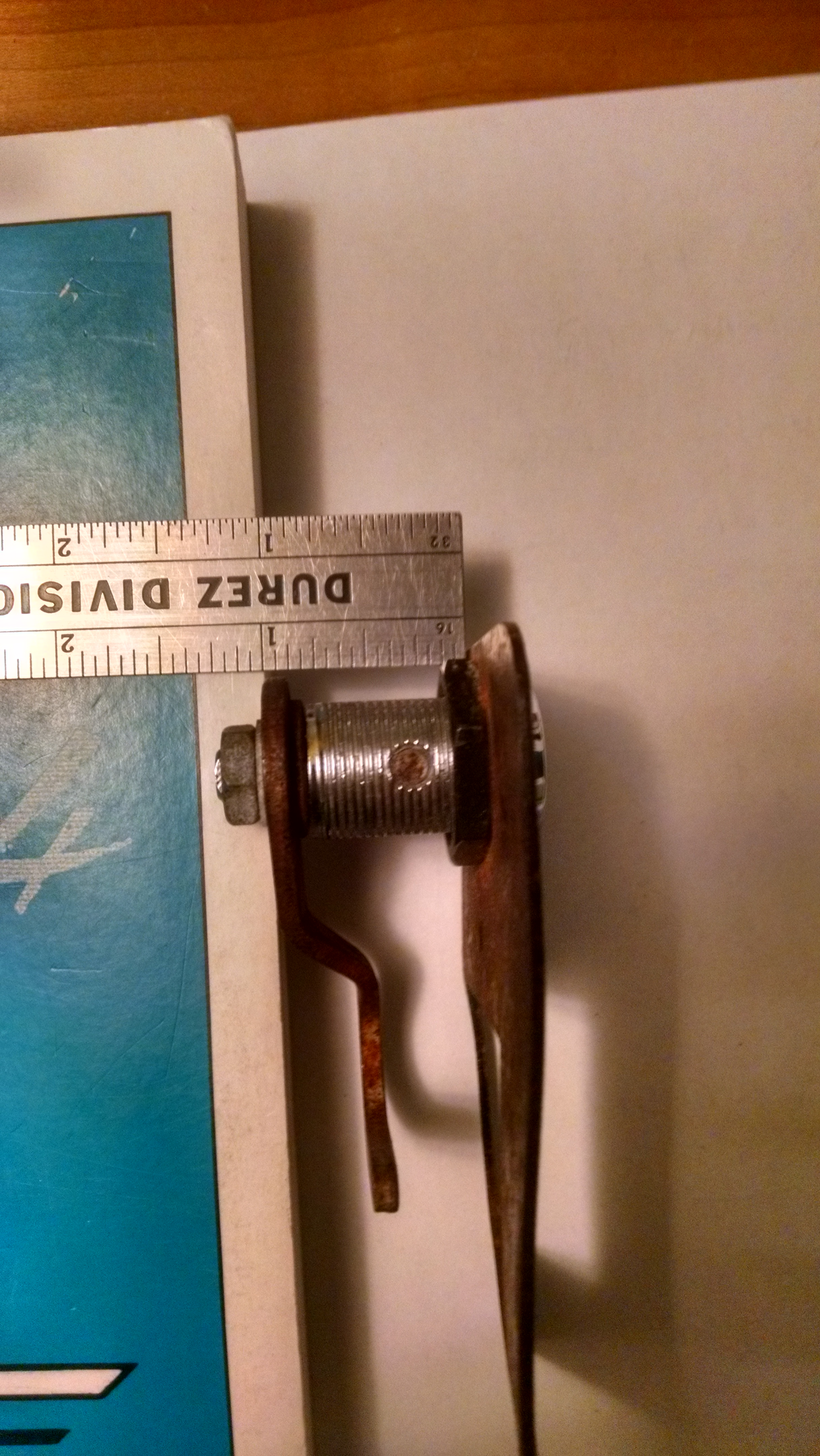

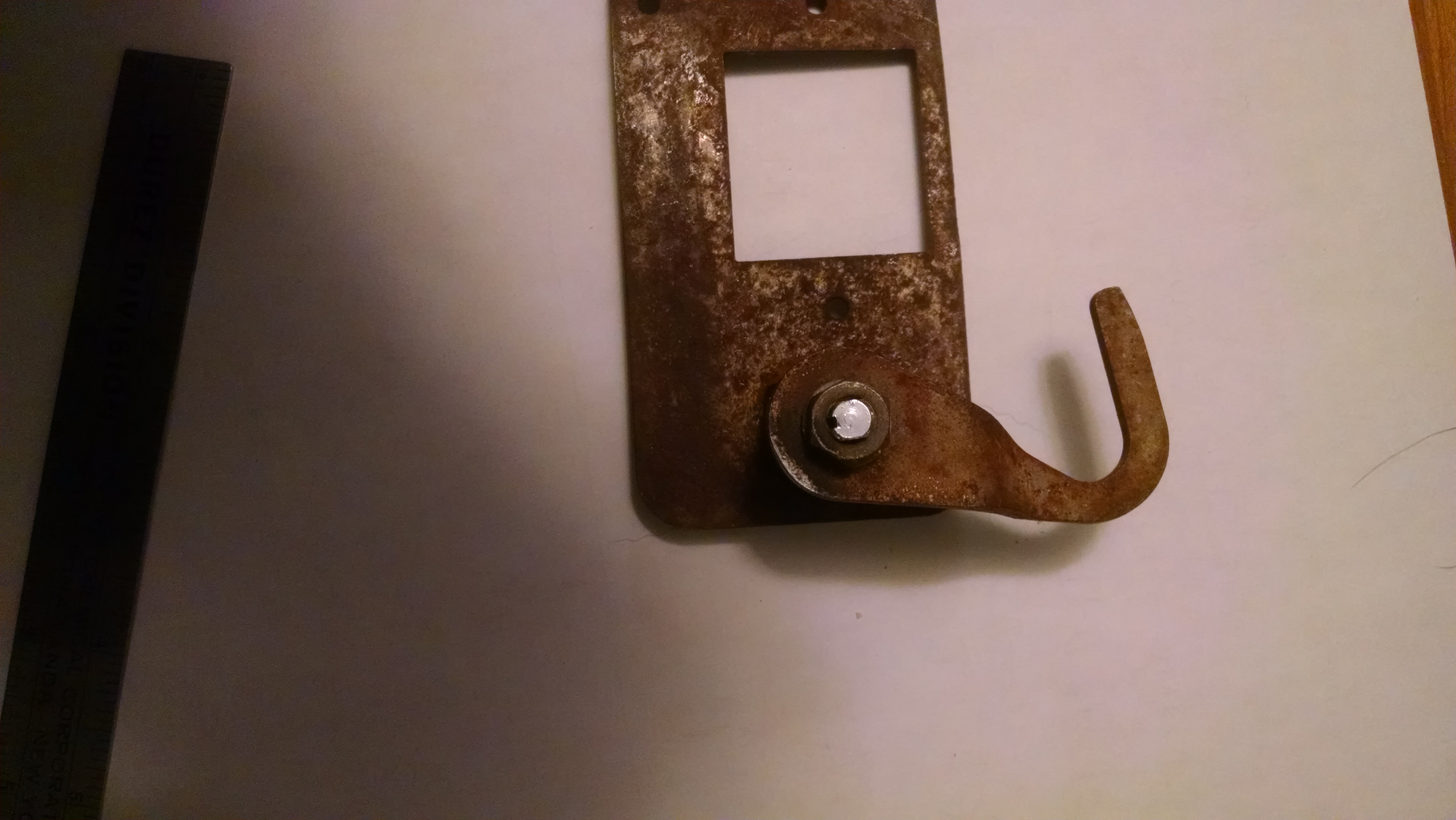

That lock IndSlim posted above will probably work for you. I rebuilt my seat and took the lock and cable system out but I kept the parts. Here are a few pictures from the 1993-94 parts book and the parts I have. There is also a seat on eBay that I think has this type of lock system. Look at that one and these pictures and you should be able to figure it out. I think all you have to do is unscrew the front plate and put the new lock cylinder from eBay in there and you're good to go.

The seller on eBay said it was for the touring pack, not the sidecar. However, it might be worth a try; that seat's looking a bit rough for the price they want, and that's a bit more than I care to pay for just the lock assembly. These pictures and diagrams will help quite a bit - thanks!

Yeah, I wasn't suggesting buying the seat, I was wondering if that is the seat you have in your sidecar. The guy with the lock on eBay does list the correct sidecar seat part number. Looking at the listing on eBay it is the same lock cylinder I removed from my sidecar seat. There are a couple of other locks listed on eBay like that for a lot more money. Good luck.

It does indeed look like the same seat; hubs is the expert on locks, so we both appreciated the photos above. 53584-92 is the right number for the lock itself?

I don't know if you can order the lock by itself anymore, I couldn't find it on www.boardtrackerharleyonline.com It looks like you can order the lock assembly, 53593-92, $36.00 from them. They used the same lock on the non-ultra sidecars but located up on the outside of the sidecar body with a lock plate on the seat back. The eBay one might be a bargain at less than $36 if all you need is the lock cylinder and key.
