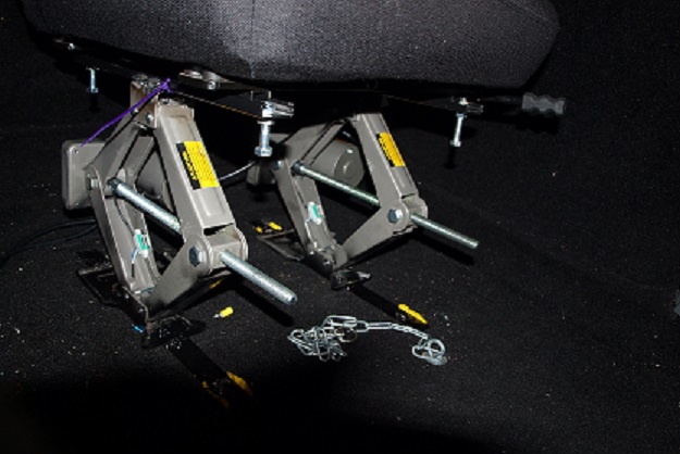

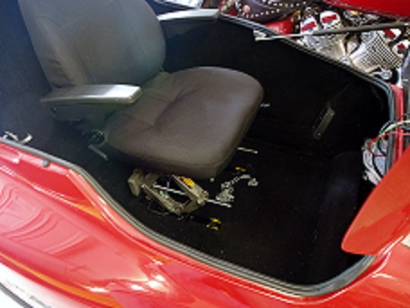

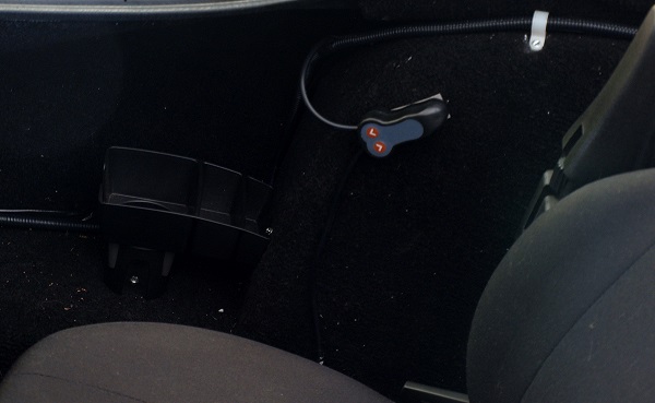

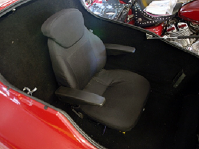

Well I finished my scissor lift. I used two 12volt Black Bull scissor jacks, lawn tractor battery, and a battery tender for a total of $200.00
Posted : July 3, 2015 12:54 pm

(@oldschool_iscool)
Posts: 463
Nice!! Let us know how well it works. I may just have to steal your idea... er, I mean, use your build as "inspiration" 😀
Posted : July 8, 2015 7:07 am
 taco
(@taco)
Posts: 42
It works swell, I'm a little over 200lbs. and it will lift me with no problem. I do wish it was a little faster.
