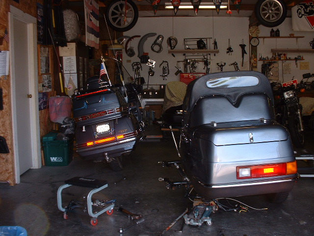

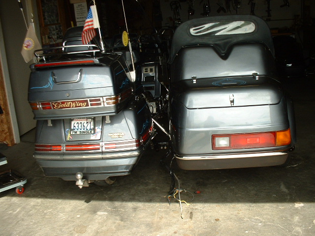

Attached is a pic of another 1500GL FS III rig (with a behind the bike hitched trailer that I repaired after it had gone off the shoulder of the road in the Coastal Mountains of Oregon when the lady pilot met oncoming traffic in the middle of a tight turn.

I saw this rig this spring - Don't know if you relocated it, but the trailer hitch is no longer located behind the bike. - Now we know why. 🙂
