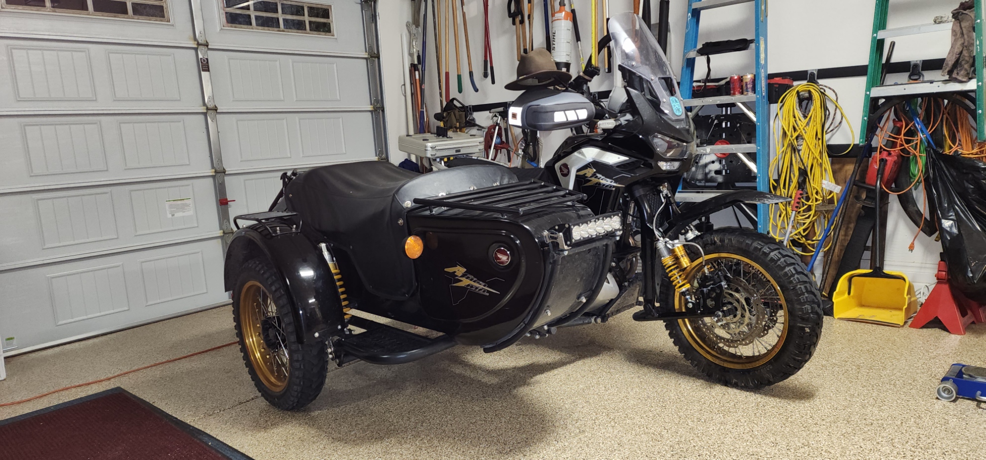

For what it is worth, I posted some pics of the LL build, in a separate thread.  I think it may be the build referenced at the beginning of this thread.
You know, it is possible that we measured the near zero trail wrong, but a lot of eyes were on the technique.  A couple of things make me think the actual measured 0.4" of trail may be pretty close to accurate.
  1.  Wheel base of the bike starts out at 62" from the factory.  When we finished the build, it was at 66", with the chassis set level with a digital angle finder.  Four inches of wheel base increase might imply a 4" decrease in trail amount, all other things being equal, which they may or may not be.
  2. We put a laser through the steering stem to try to spot on a piece of graph paper where the line would hit from @Drone's diagram.  We  then measured axle center line dropped straight to the graph paper.  It showed a small amount of trail, maybe .4" or so.
Now we did not have the wheel on, with the weight of the bike compressing the suspension.  That may introduce some error in the measurement, but probably not a lot.  Maybe another 1/2" or so?
I don't know.  I was pretty surprised at how the rig handled with the theoretically greatly reduced trail.  Chuck tacked everything in position so I could test drive the rig and get the feel of how it handled, prior to finalizing the trail setting.  However, it was so sweet that I had no intention of changing it...
I have read where hack racers like to run close to zero trail, with the idea that they like the steering to be very quick and are not so concerned about being able to relax a little while riding.  I generally won't remove both hands from the bars of anything I ride, however, a few days ago, at about 65mph, I felt the need to zip up my collar.  Zipper was kind of stuck, so I used both hands, with the cruise control on.  I still cannot believe that I can take both hands off the bars without immediately diving into the right ditch, but it does seem possible.
I felt like I learned a lot, going through the LL build process with Chuck Loftkin; I suspect that I am just seeing the tip of the ice-berg, so to speak, but I sure like how my rig handles, now.
