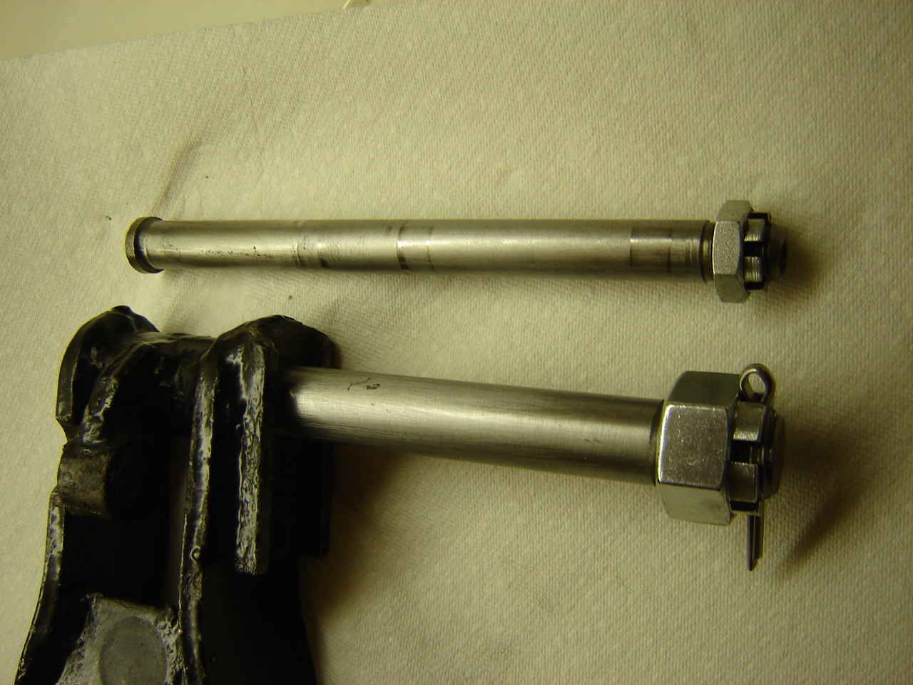

OK, I found a good machinist this am and decided to let him to it.
Here's what will happen:
20mm 4140 rod to be ordered
Swing arm bored to 20mm for press fit
End of axle to be knurled, cemented and then press fitted into swing arm
I'm pretty sure this would be a lot stronger than my present setup.

The new axle is installed. It's 20mm, 4140 rod, knurled, press fitted and cemented then tapped at the inboard end and bolted with a fender washer and with red loctite.
Next is to find or make beveled 20mm fittings that ride against the bearings for the hole in the backing plate and inside the castle nut.
Any source for these and the pieces of felt that fit over them?
Howard
