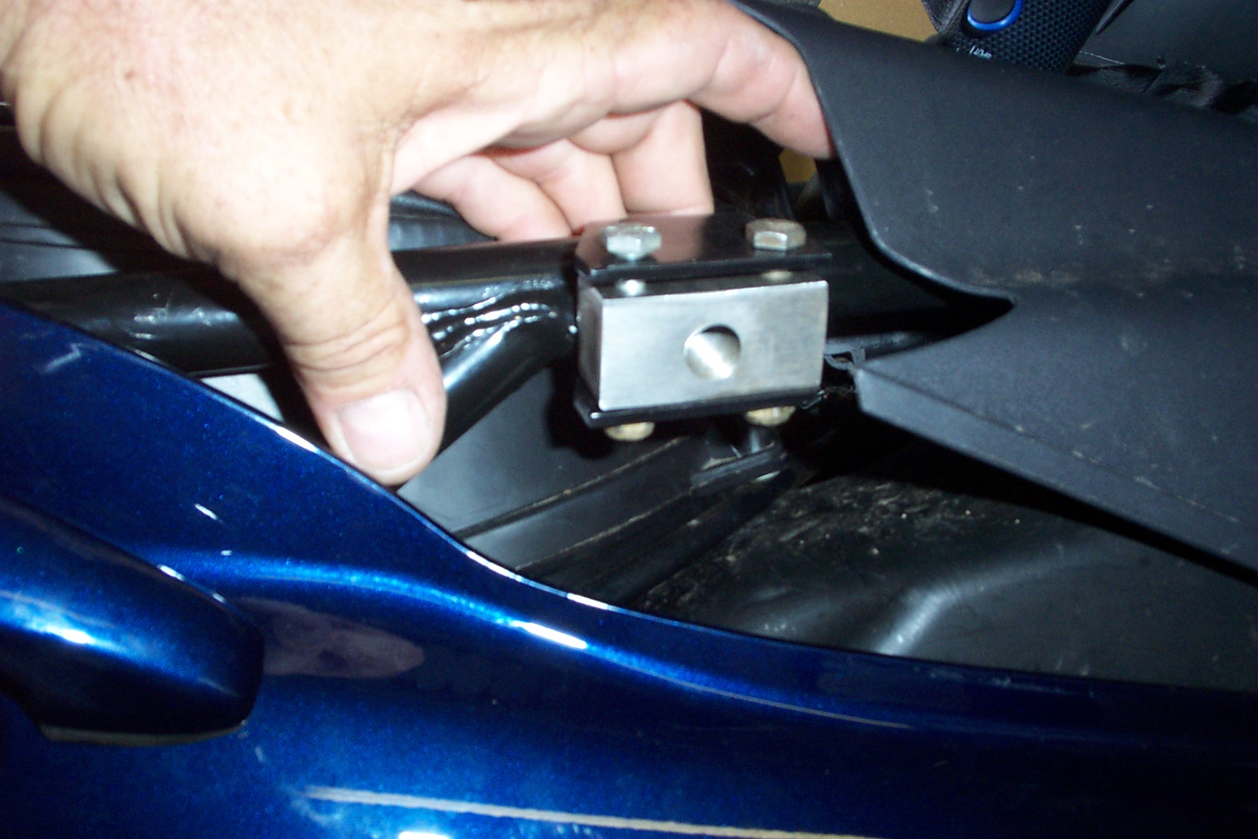

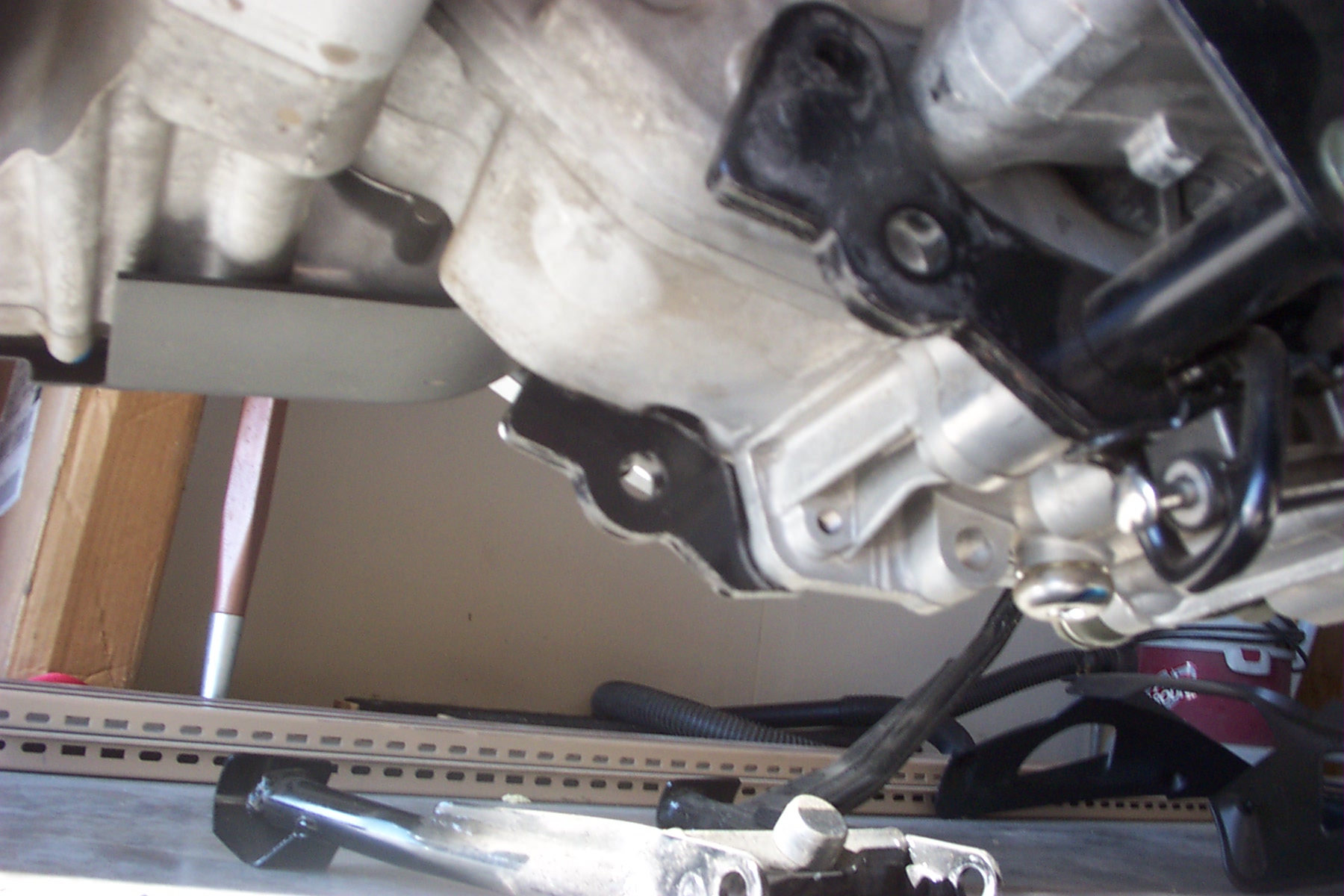

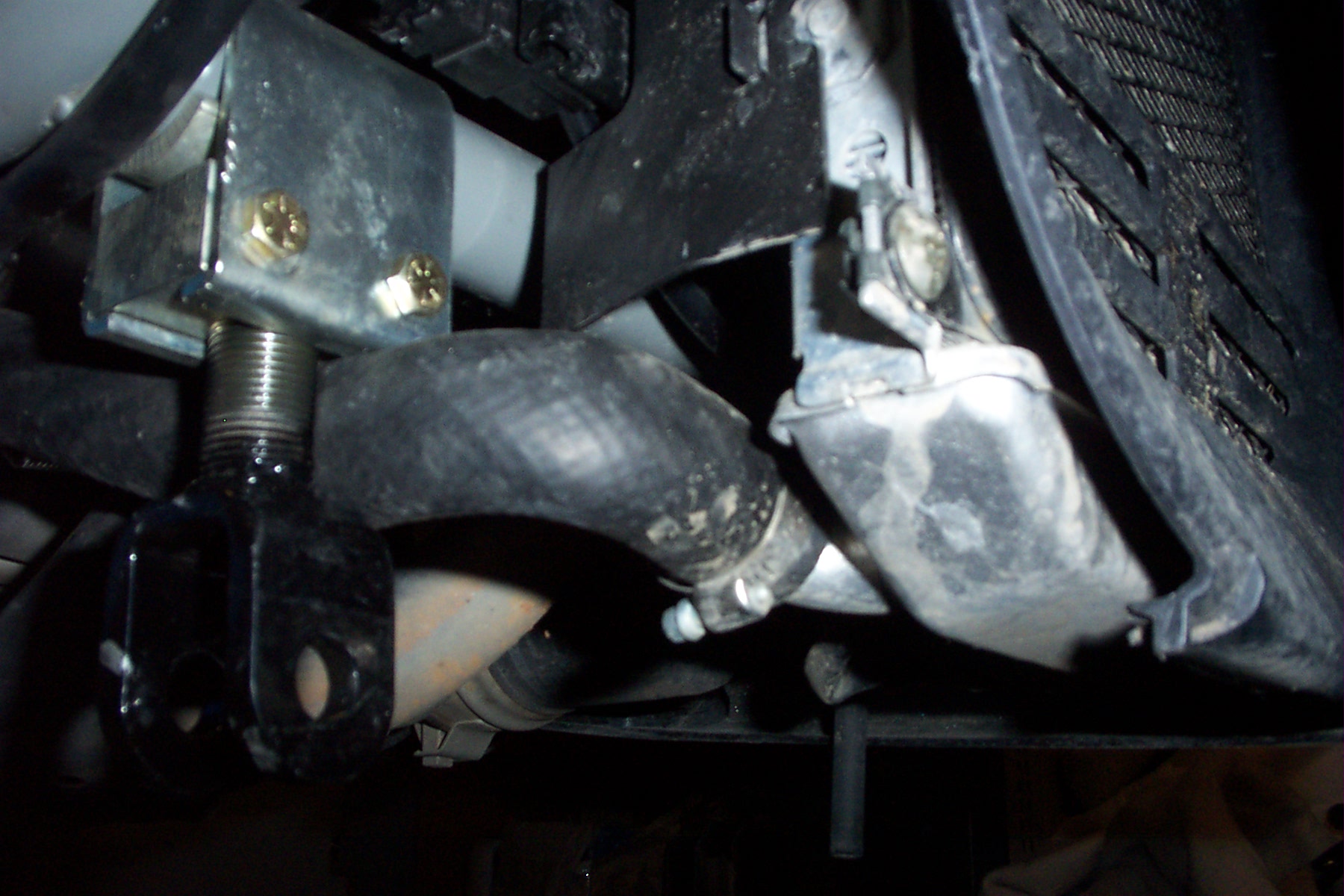

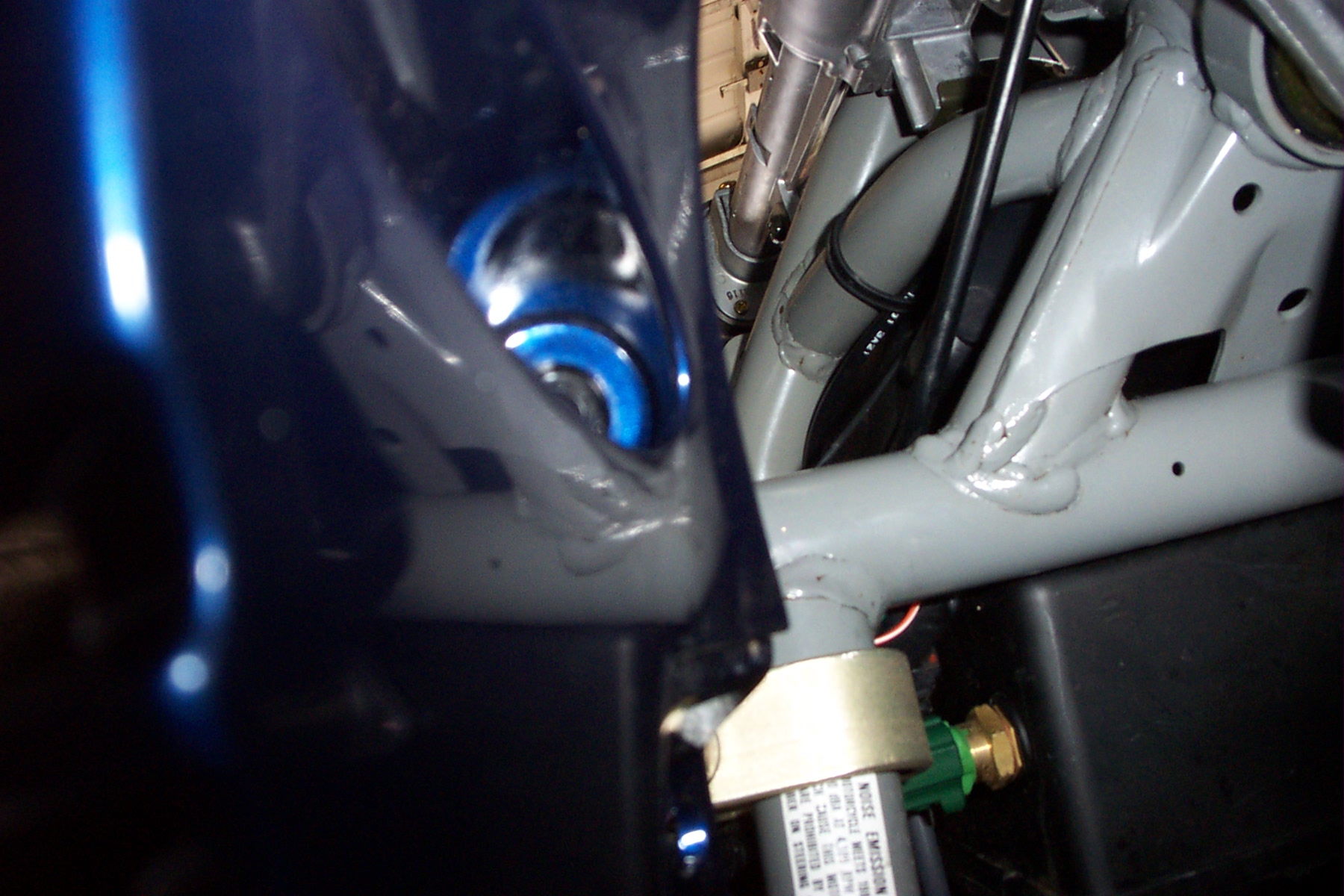

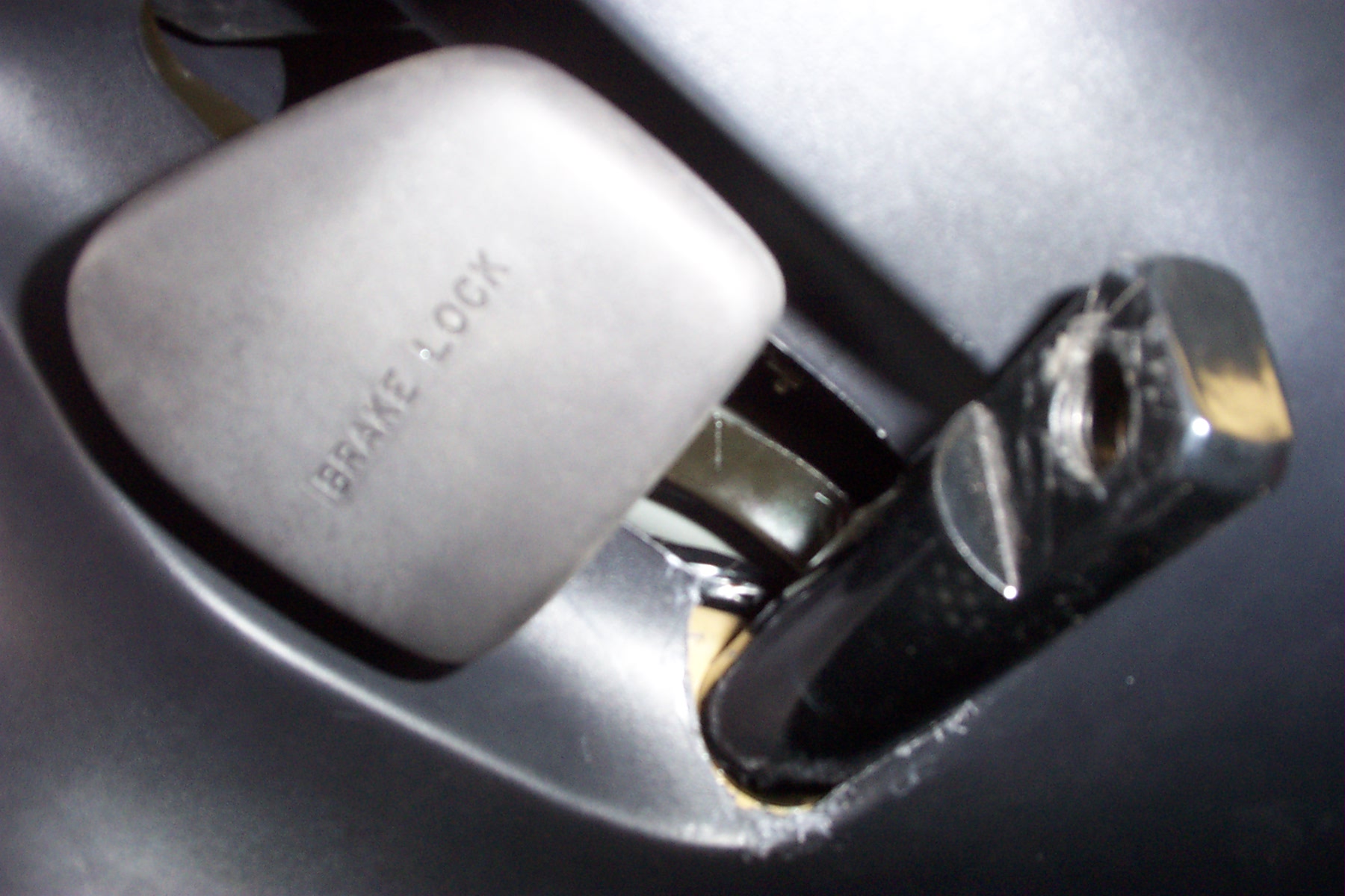

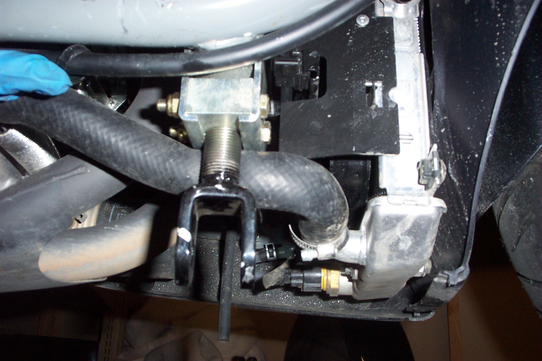

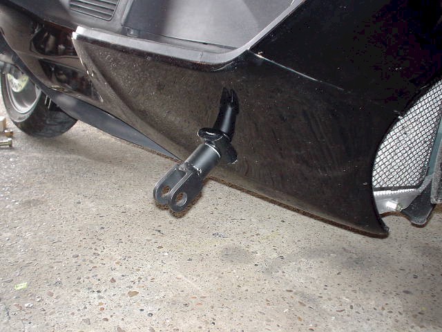

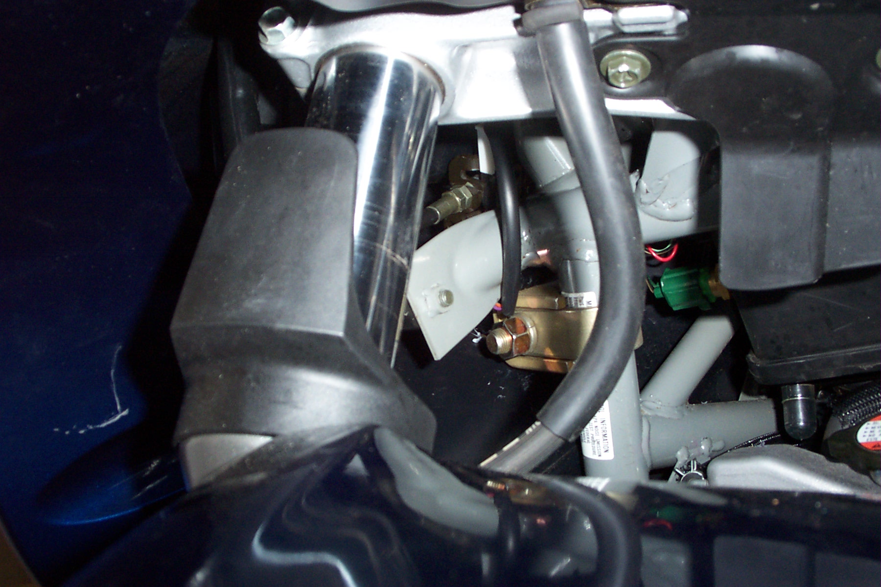

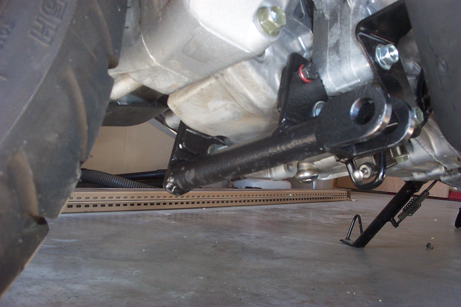

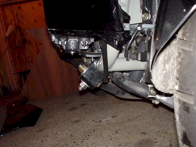

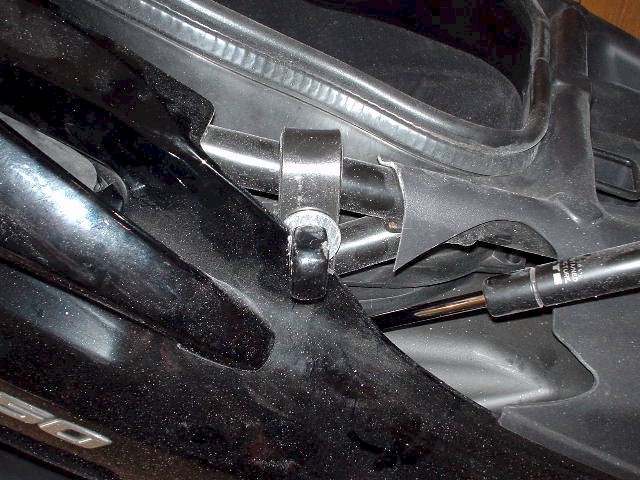

Attached are pictures from Texas Sidecars showing their mounts for a Suzuki Burgman 650. Note that there is a proprietary subframe under the transmission installed were the centerstand is removed.

Looks like a Velorex frame clamp, Motovation frame clamps, one of our frame clamps and one piece of flat steel bent around the frame. In general frame clamps are not a great way to go. The attachment is our full mounting instructions. These mounts are similar in concept to what we do for most bikes. They come standard with our sidecars, we also sell them for use on other sidecars.
