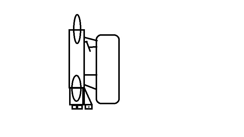

I have a 97 Goldwing GL1500 and a Motorvation II on it. I want to pull my camper and cargo trailer but the unit does not have a hitch. I have a hitch on my bike but if I use it then I would run dangerously wide
I have found in my research that either running the trailer tire in the bikes track or the cars track is the answer most give
I would think using the cars track would be best as you would gain the tongue weight on the car to help on right handers and stability in general
I have seen a few different bikes with hitches built in or attached to the inner most frame rail of the car. In my case if I did that I would be creating 2 more tracks as my camper would now be between the bike and car tire
So unless I am wrong in my thinking I need to fabricate and weld a hitch onto my rig
I would like to here from those in the know, is it considered best to use the rigs tire track for trailers to follow.
would you put the trailer tire dead on behind or offset a little to the inside
and what would be considered a good lead length behind the car for the ball to sit
I will post pictures of the process once I get started

The trailer tows best off of the center of the bike, but as you have figured out you end up with a rig that is way to wide. The more you move the trailer to the right, the more effect it has as to pushing and pulling on the sidecar on acceleration and deceleration. So, the best answer I have found is move the trailer to the right, just enough that the left side of the bike and the left side of the trailer are even. In other words move it over but no more then you have to in order to keep the rig from being to wide.
There are two schools of thought on this, one is to move the hitch on the bike, the other is to have an off set tongue on the trailer. I prefer the off set hitch as when you make an off set tongue on the trailer it is to easy to jack knife when backing up. Also should you ever need to tow the rig with a two wheel bike or a car it just looks odd.

now see this is the kind of info I need. I guess I wasn't thinking about the drag & push that the camper will create when behind the sidecar rather than the bike
OK so I need to find a way to use the bikes hitch. would be easy if I had a receiver, I would just fabricate a offset tube. Hmm I'll have to see what I can do once I get it all hooked back together

On both of my rigs I have the hitch on the sidecar frame and neither one pulls or pushes any worse with or without the trailer that I can tell. Both sidecar rigs have pretty much the same distance between the sidecar and bike wheels so the trailer tracks real nice and in the Winter you can only see one set of tracks in the snow. I did offset the tongue on the trailer a little to get the trailer centered and tracking correctly but that is just me being anal, I do not think it really matters.
Posted : November 18, 2014 8:34 am
Off setting your trailer tow bar moves the mass of the trailer to the left more which while you are still pulling further over to the right, the mass does not have the same effect as it would with the trailer not off set.
Posted : November 18, 2014 8:39 am

I have had this discussion on a couple of other sites and I guess I still do not see how offsetting the tongue, especially on a trailer this small, would make that much difference. To me it still seems like the same thing as having a 2 rail trailer with only one bike on it.
I actually offset the tow bar to the left, port, so the trailer is wider on the right, starboard, side but I know what you are saying.

VLAD, looks like you have a rig about the same size as mine, you don't find running off the bikes hitch puts you at the limits on width on small 2 lane roads or tight bridges. That is my biggest fear, being so wide I don't have room to move one way or the other in an emergency situation. I was thinking about just off setting my hitch by running a piece of 2x2 angle out toward the car and put a brace from the end of it back to the saddlebag mount of even the frame found for the crash bar. sort of triangulate the hitch if you will

Measure your camper. May be you do not need to offset your hitch.

I think my camper is going to be too wide for that. I know it's 2' from center of tongue to the edge of wheel fender
