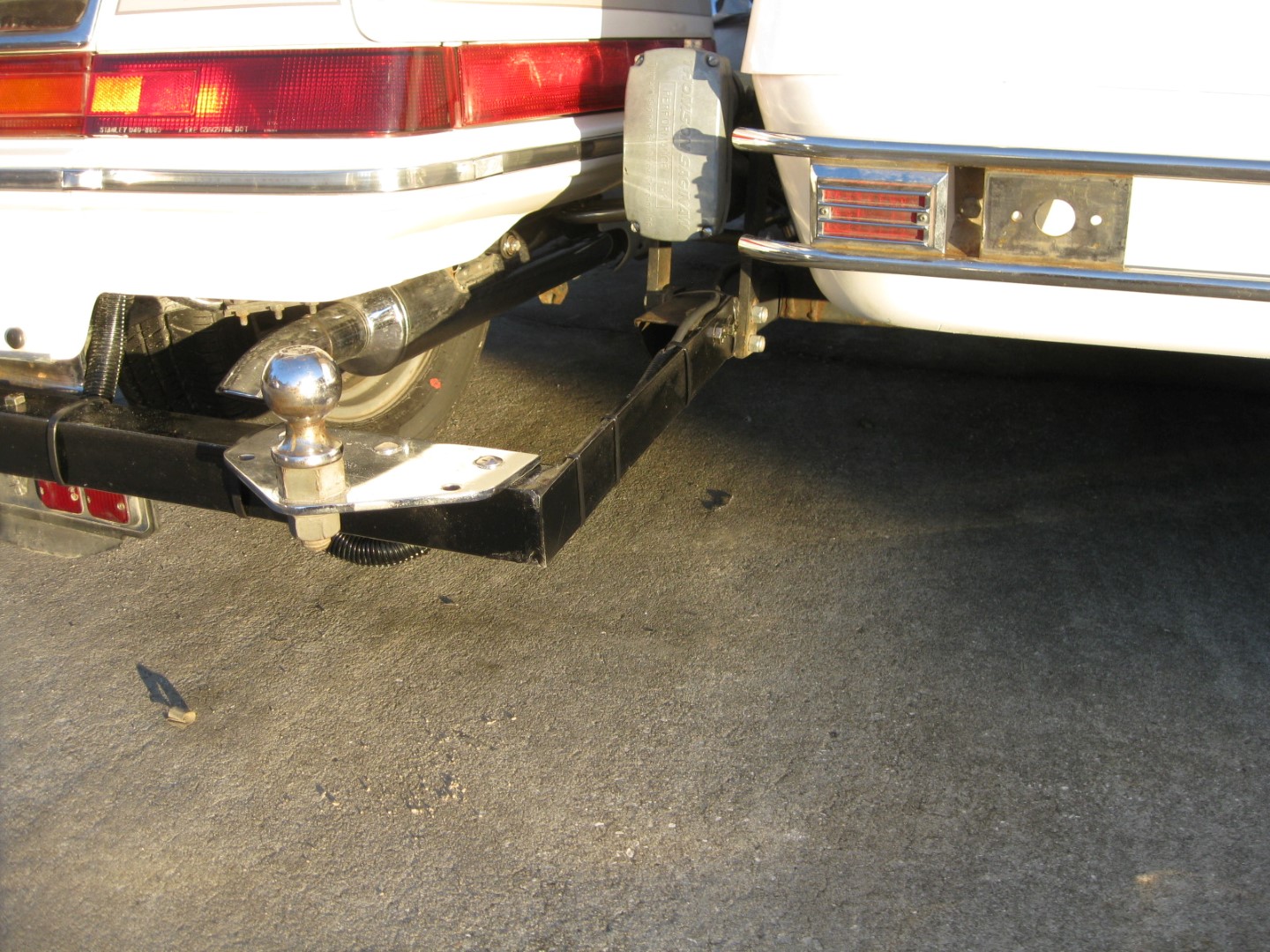

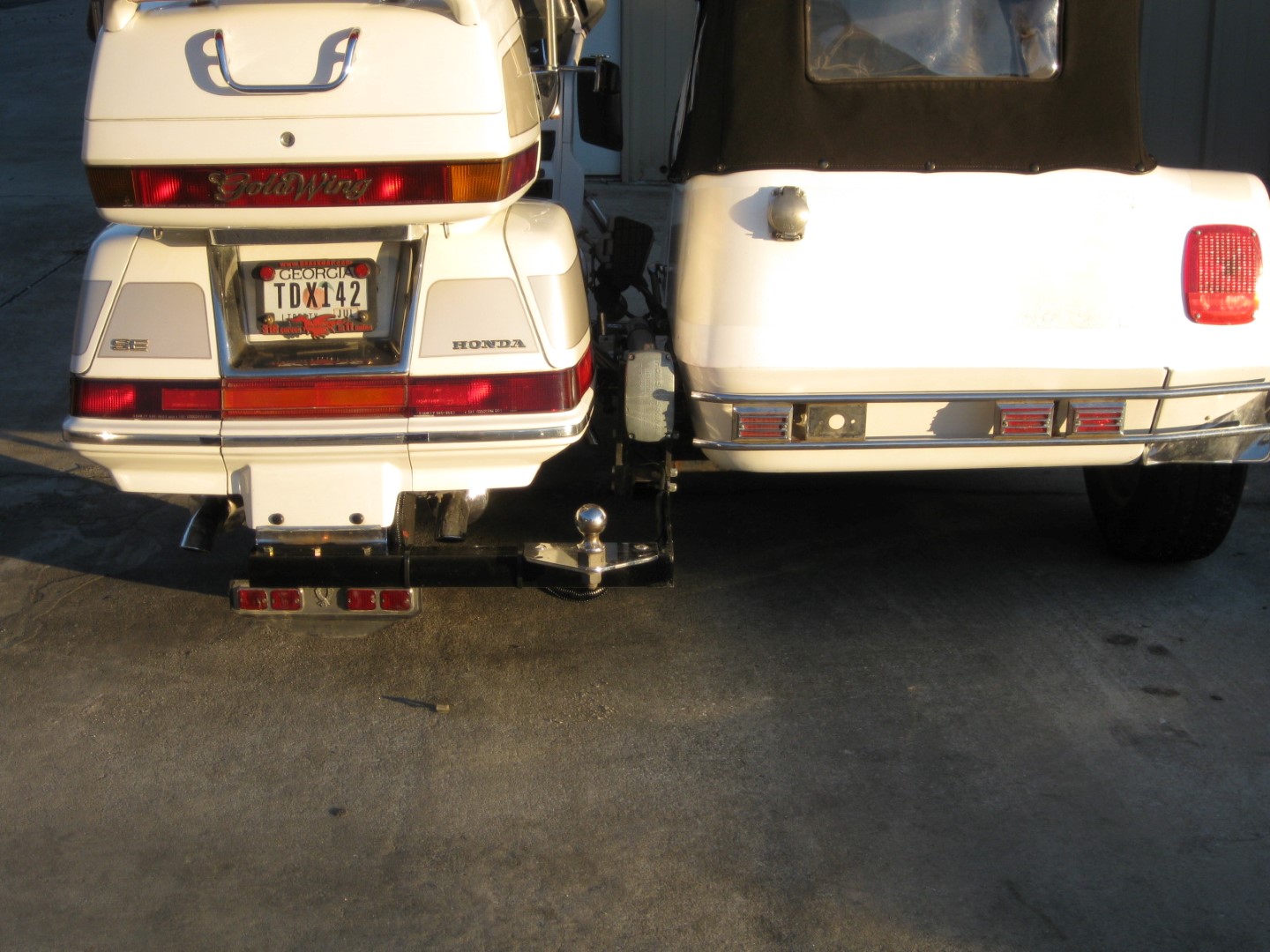

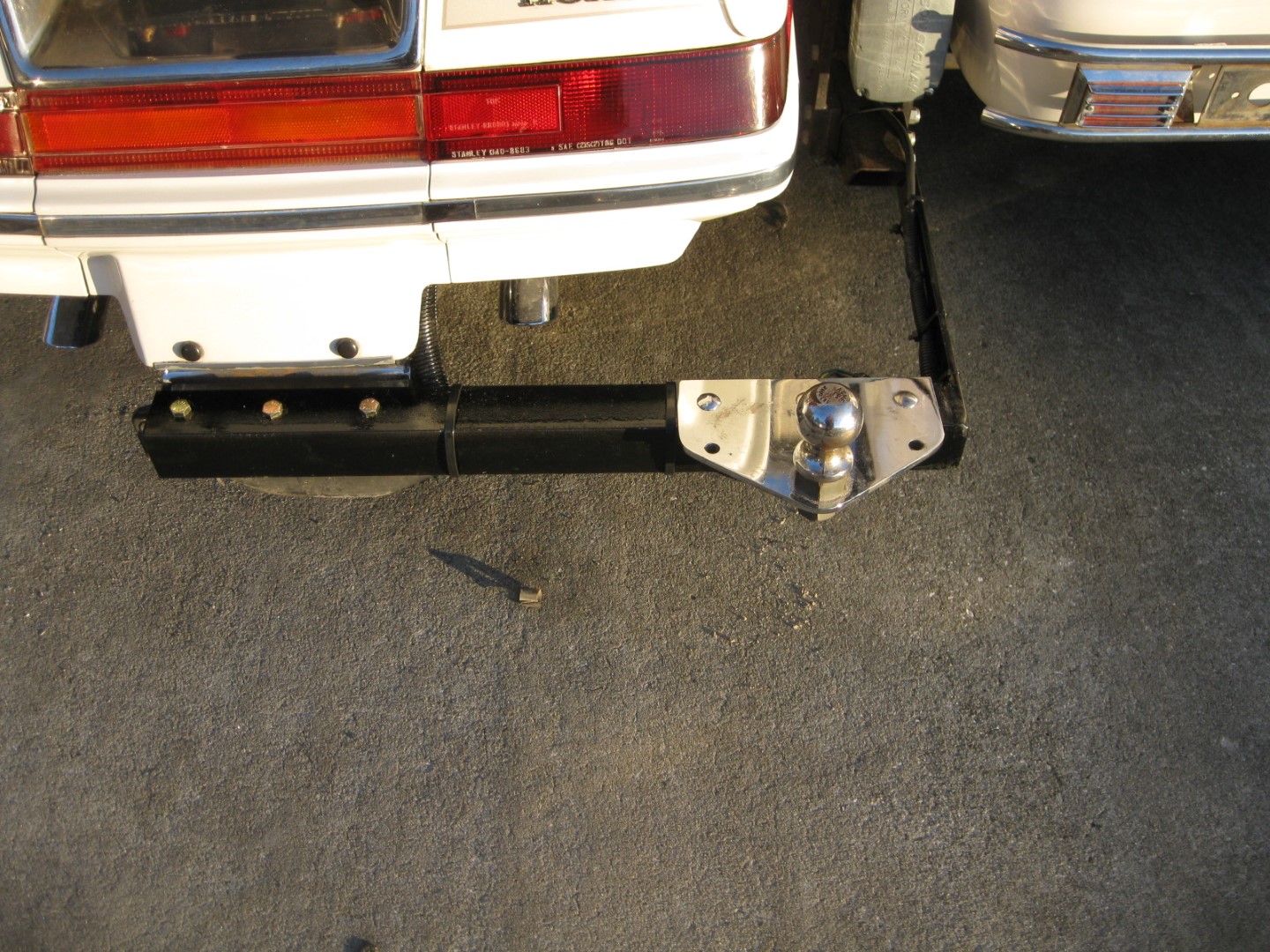

well after considering all my options I decided to go with a offset of the bikes hitch, it is supported by a bracket from the sidecar, I decided that would offer more structure and load control than coming back from the bike like in my drawing a post or 2 up
I can also simply unbolt it if needed

Looks like that will work.

That looks good to me. If you later decided to move back a little you could do thAt but it is nicely centered now.
