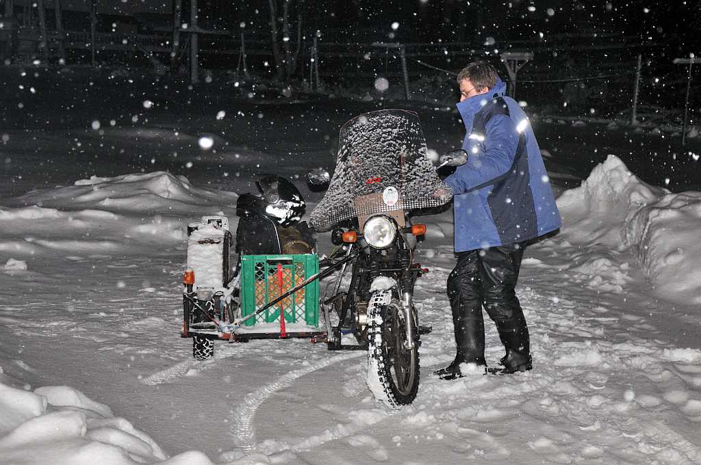

Good to see your outfit roadworthy (well, hauling "junk" anyway). Please post more photos as you continue the project.

SwampFox - 11/3/2011 2:02 PM
Well, it's made partially from junk. And with third wheel it's still my ratbike, so it will continue its rat life, although with any required conservations etc.
Now I have to scratch some fresh "rusty color" from subframe and sidecar's frame and paint it to give it less junk-like look.

Posts: 1932
c64club - 11/4/2011 8:31 AM
...Well, it's made partially from junk....
My "junk" reference was to the fellow commenting your hauling scrap metal in/on your sidecar. 🙂

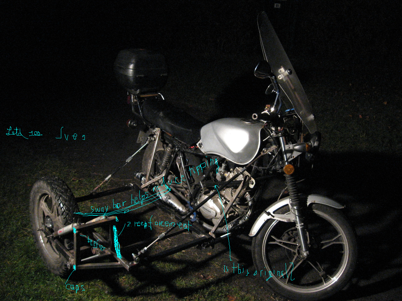

may I suggest that You reinforce the sidecars standing shock frame.
When you paint rat style put something on top of the primer.

Could you say more about reinforcements you suggest? Weld-on some additional struts/guests in construction? I will be thankful if you open one of my pictures in paint and draw your suggestions with lines.

Lets see if the sketch goes out.
it seemed to come out, but you have to download it for to watch well.

Sven, thanks for reply, especially for the drawing. I see that we treat motorcycles similarily 🙂
Without anti-sway bar whole rig tries to eject me to the left from seat every time I reach a bump on the road with sidecar's wheel. But it may take some time before I install sway bar. Now I try to finish whole construction because winter comes in big steps, and my workshop is almost unusable when outside temp reaches -5*C or colder.
That tube, you marked ona a photo isn't original. It's my reinforcement to bike's frame. Here you have photos and description:
http://grzegorski.net/wiki/doku.php?id=en:moto:k125-rama
I made this second reinforcement to standing shock frame this morning. Now I have to weld-on these squares at end of each tube.

The tube caps are intented just for to give some more strenght to the shock frame. In my eyes the angle Shocks/swing is a little low and might be part of the "ejecting action".
Remember tubes rust more from inside then outside!!!!!
So its a good practice to paint inside or better use "Hohlraumversiegelung" / "inner space sealant" a kind of asfalt or recine you normally cure the inside of car bodies with before winter... For to protect the crome from salt I used asfalt paint or a thick wax coat that you could wash off with gasoline in spring.(burn it afterwards, don't spill it)
Excellent accesories for winter were> My spare wheel in winter had trial blocks and spikes which I got in Norway winter 86. / Cutchers blanket made out of felt and soft vinyl over the tank and reaching up to the chest./ heated grips and "Lenkerstulpen"- covers over the handles. / the swedisch sheep skin trouthers (from 1942) you find perhaps still in army shops. / Boots with foam filling.
And my prefered change on the sidecar was a deflecting sheet metal that prevented the snow from hitting the sidecar frame, but would lift the sidecar. => specially usefull when a truck looses a chunk of snow ice and by the way the adrenaline shock rises the body temperature.... you don't make aright turn and flip over on the instant!
Lunch is waiting. I wish you a happy welding time.
But before an important hint. The ejecting action of the sidecar swing is best limited by the sway bar = like the suspension of old VW Beadles or the Superelastic sidecar from MZ. But as short term work arround you can mount 2 rubber blocks as final stop below the s/c swing so the swing has a limited outward travel.

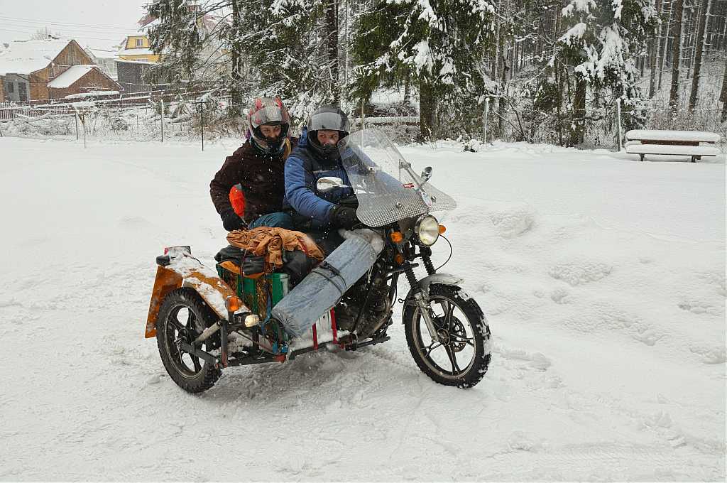

Some update after 1000 miles.
My rig works perfectly, although with this small displacement engine it can reach about 40 mph in really good conditions. I used Heidenau winter tires. K41 3.00-18 Silica on front wheel and K66 90/80-16 SnowTex on rear wheel. It was stupid, because rear tire should be more wear-proof than delicate Snowtex one. But works. 800 miles since i mounted winter tires, the rear one lost about 0,6mm of thread. Tried to change setup - no effect. Simply - rear tire should be much stronger, even for such small rig. The next one will be Heidenau K41 3.25-16".
Hardest works that my rig did:
-75 kg of chicken food in normal (non-mountain) conditions
-few >7ft long steel beams on the same route
-regular transports of coal/wood for my fireplace
-two persons, our luggage, 7% steep hill and 3" of compacted snow - done perfectly.
Yes, I know that passenger should rather sit in sidecar. But with big luggage, whole rig is very stable, additionally I instruct passengers to lean right in right-handers.

Igor congratulations for your fine winter ride.
In winter is where you start to appreciate the rig more then in summer. You notice inmediately when the ground traction gets lost and have still time to correct and adjust and if things become strange you still have a lot of options by wheight shifting and drifting.... I loved riding in the snow. but for now our Summer is at its best... (no Rain since Chrismas and 20-28°C)

Real (snowy) winter become just 3 weeks ago. Sooner there were rains and sometimes ice, when temperatures reached 0°C or less. So I had chance to practice riding in almost all bad/wet/slippery/ice/snow conditions. Also tried offroad/mud riding, just for practice. And in winter I have practiced on big empty parkplace (not so empty, it was full of snow). Some drifts, 8-shaped tracks, braking experiments. With 20 kgs of luggage. We also tried such test - me in sidecar and my passenger tried to drive a rig first time in her life, starting from center of parkplace and trying to do 8-shaped track.
In really deep snow, on compacted snow, I could trigger some traction loses, but it's somewhat simple to regain traction. K41 Silica M+S as front tire is wonderful.

For ballast when riding alone I made the same beginner error. And on my first day I landed 3 times on 140km in the pasture... => better go with more weight in the sidecar. half a persons weight is what I use after many years of riding for a beginner is better more a least 35-45kg.
