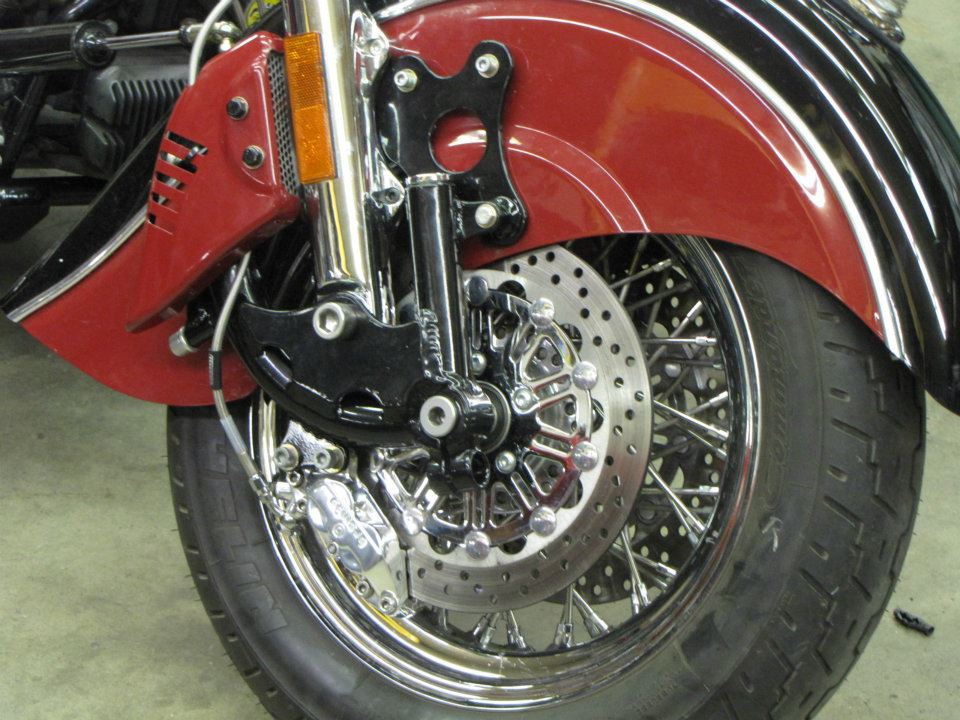

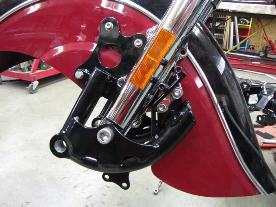

I found this image on the internet. The adapters move the axle of the modern Indian forward. The trees stay the same and the fork angle stays the same, but the trail is reduced. Has anyone thought of making these for the Harley Electra Guides?

They are ugly enough. I would think the Tri-Glide trees might cost about the same without the odd appearance and fender mods.
Posted : October 20, 2012 6:27 pm
Looks like a version of leading links. I agree with Lonnie, they're ugly just like probably all leading links even if they are functional. The triple tree would be just as functional and your bike wouldn't loose any of it's stock appearance.
Posted : October 21, 2012 11:15 am
That's looks like a pretty easy and simple approach, no rocket science. Simple enough for a home builder to fab up with modest tools, which isn't the case with modified triple trees. The idea seems to be good but the execution as shown lacks, way too clumsy, more than it has to be. Seems more billet or plate could give a much nicer appearance than the various tubing.

We call these "leading legs" and make them for a few bikes, mainly bikes where there is not enough room in the fairing for a angle change on the forks. On most Harley's we would go with triple tree's as the best option.

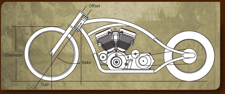

Don't know if it will help any, but take a look at the RB Racing Rake and Trail Calculator here: http://www.rbracing-rsr.com/rakeandtrail.html
