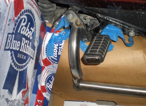

It was a little slow today. The weather was so nice, We ended up doing alot of spring cleaning. But I did sneak out and play a little. I have all the pieces ready for the rear part of the subframe. They just need to be welded now. Here they are mocked up.
Photobucket
Later, W

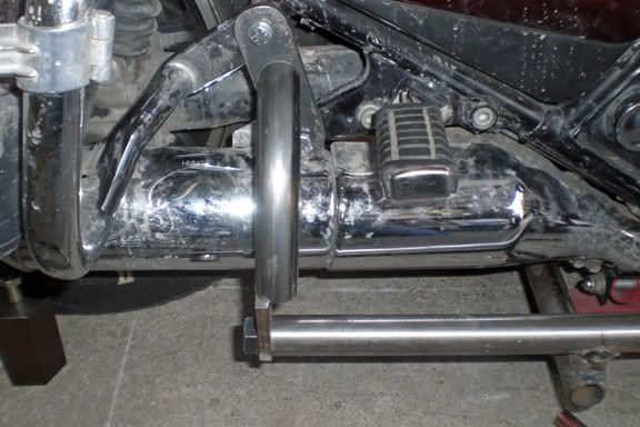

Well, It's snowing. Looks like I'll have to work in my shop today:o) I got everything ready to tack up. have to protect what chrome I have.
Photobucket

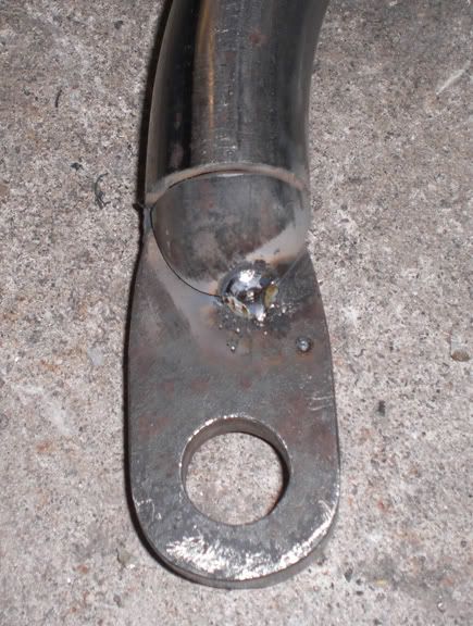

I then made a little cap/gusset for the end of the tube. This was a tricky piece.
Photobucket
Ran into a small snag... One of the bolts won't come out now:o( I'll probably cut off the head and make the hole bigger.
Photobucket

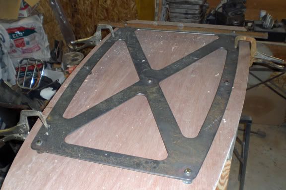

On to the suspension. I have to get this part done, so I can double check my numbers on the width of my frame. And make sure everything will clear the body. I flipped the body over and positioned the body mount in place. I clamped it and drilled it. after each hole I inserted a bolt. This would make sure nothing would move. Here is a quick picture.
Photobucket
All this was done on a ladder. This thing is tall up on my saw horses.
