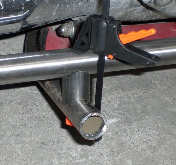

Well I started on the pieces for my subframe. I've never had so much trouble operating a hole saw in my entire life. LOL Broke 2 of them on this one little piece. This is the piece that attaches were center stand used to be. I couldn't get the tube to align up with the bottom bar, so I mitered a piece of tube to connect the two. I'll make a plug to close up the hole in the pipe sticking out.

Your doing a very nice job Wes and it's obvious you been around iron before so I hesitate to mention this but what the heck, when you cut the miters in the pipe and broke the hole saw did you have the pilot drill in a piece of the pipe you were cutting off? if not that would have helped to stabilize the hole saw and maybe saved you the hassle of breaking them, one other thing I would like to suggest is reather than makeing a cover for the hole that you use a plastic cap and use the pipe as a route for the sidecar wires, they would be unseen and protected and with the plastic cap the hole for the wires woulden't chafe the wires.

Thanks for the compliment. It was just a cheep hole saw. I was trying to save money, and it ended up back firing on me. I know better than to try to save on cutting tools. I have a brand name one now. I should get the rest done, without any trouble. I have welding class tonight, So there probably won't be an update tonight:o(
I have thought about running the wires through a tube. But it will have to be a bit bigger to hold everything. I'll come up with something that is neat. There will be a fuel line and battery cables to deal with also:o)
Later, Wes<<
If that tube is 1 1/4" x .120 you can stick a piece of 3/4" od solid stock or a 3/4" bolt in it and weld it up/ A little grinding and it is nice and flat....or leave it stick out and grind it to a point for a midevil look.
They also sell little chrome and rubber end caps at the hardware stores that look cool.
Or put a sight window in it and paint half of it black on the inside of the glass. Then you can make like you are checking your subframe oil.

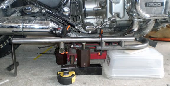

Getting ready to tack everything together. Here is what I have so far. All my little bits will soon become bigger.

I still have the back mount to fab up. I'll get it after I get the rest tacked together. It might have to bolt onto the sub frame?

Well I have all the pieces welded together. After It cools off, I'll clean it all up and re-mount it to the bike. I'll be able to figure out the rear mount at that time.
I used my arc welder to weld this up with. I used 7018 stick. I am pretty happy with the results. I'll have to make a short wrench to get to the bottom bolts, but, I had planned on that.

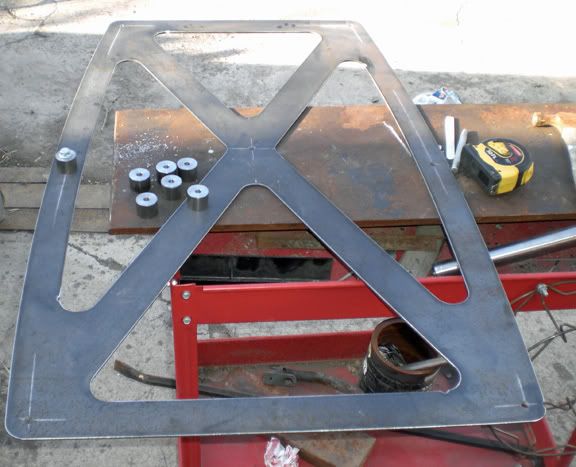

Forgot that Spring break was this week:o) After work, I drilled the body mount and made the spacers that will go between the body and the mount.

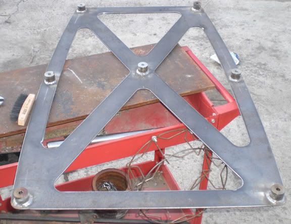

I set up my welder and bolted the spacers to the mount and welded them. I used my arc welder with 7018 rod.

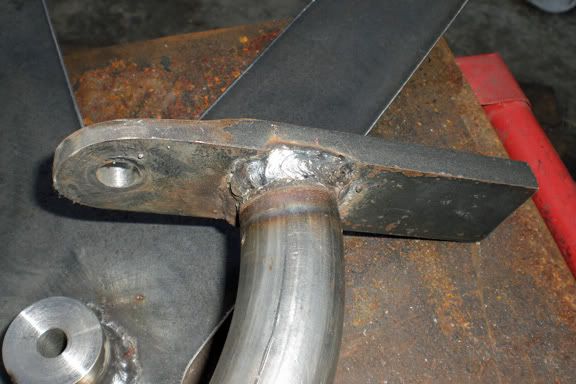

Here is a close up of the welds. (please be kind:o)
