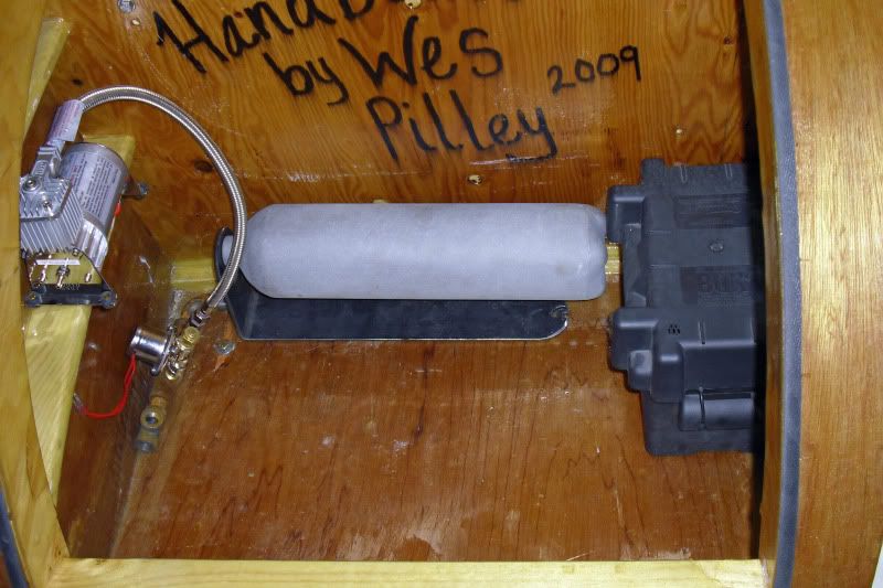

I've been trying to get my garage cleaned so I can work in there easier. It's not done, but, it's bettero/ I figured out the mounts for my air tank last night. I got a good start on the pieces that will be welded together. I'll post some pictures of that and the whistles tonight. I got some 45% silver solder to solder the pieces together with. I still haven't figured out where I want to mount them, but something will come to me:o)

I made a shelf out of an old stainless steel refrigerator door. I cut out the piece I needed and drilled it for the compressor and some mounting holes. The air compressor will mount up here.
I also managed to get a bracket to hold the air tank TIG welded together.
I am planing on a 7 prong trailer plug to hook the bike to the car. I also have some HID lights to mount to the rig. I like to see where I'm going!

I powder coated the air tank Chrome:o)
