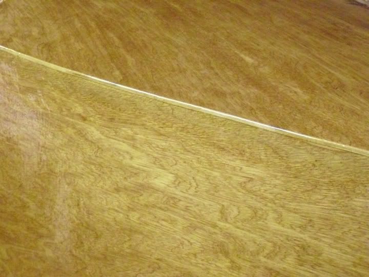

Top's done!!!
Going to try and powder coat the last couple of brackets tomorrow 🙂
Posted : September 1, 2009 4:38 pm
(@sebjones)
Posts: 68
You have done excellant work. The woodwork is beautiful. It may be a sin to cover up what you have done but have you considered coating the bottom with Rhino Hide like they do to pickup truck beds? It would not be as pretty but it would deal with rocks and gravel dings. Just a thought.

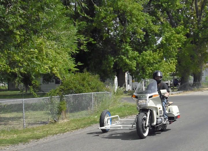

I went for a short ride with the body off today. My face hurts from smiling:o)

Stole one:o) I couldn't wait 🙂 There is a bit of a wobble that I had kind of expected. Around 15-20 mph. It seems to be worse when I am slowing down. I'll check the head bearings.
Posted : September 7, 2009 11:25 am
Looking good!
With the long trail of the GL you may need a steering damper to control the nose wiggle after the car is complete and loaded.
Did you notice much tire scrubbing in right turns with your sidecar wheel lead?
Posted : September 7, 2009 12:52 pm
Thanks Lonnie.
I am thinking of making a dampener that will mount where the fork brace is now. It will bolt on there and I can mount a dampener to the left engine guard. I just have to work out a few details. I will probably even make the dampener.
Didn't notice much scrub. I only went a few miles. Had it up to 50 or so. I think I'm in love 🙂
