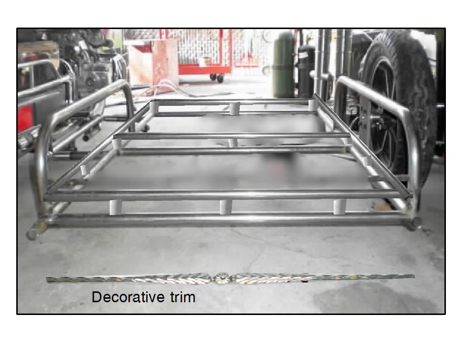

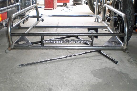

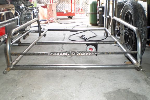

I made some more progress today. My buddy bent up another hoop for me. I trimmmed and tacked it on to the frame. I found some decorative iron last week and am thinking about using it for the space frame idea. Here it is in place. When I weld it I'd have an upright piece of 1/2" round every 5" or so. How does that sound?

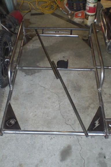

I know that I'm the only one who feels this way but while your current frame is doubtless strong, it doesn't have any defense against "racking". What would it hurt to put in one or two diagonal braces? You certainly have the skill.

Like Al sez, Ladder frames don't have much defense against racking.
IMHO: Diagonal bracing is better than a bunch of small gussets.

Ok, Here is what I'm planning now for the back. I'll add a diagonal brace also:o)I'll have the gussets there also.

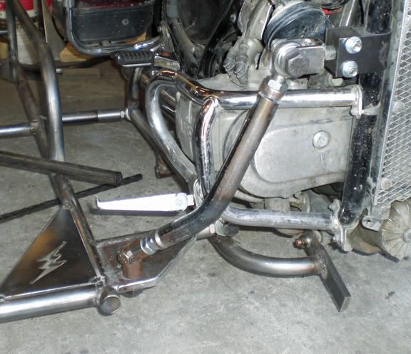

Here's that new mount. I'm happy with the way this one turned out. now to the back ones.
Photobucket
I still have to clean them up some, but I wanted to see if they would work.

Here is kind of what I'm planing for the diagonal brace.
