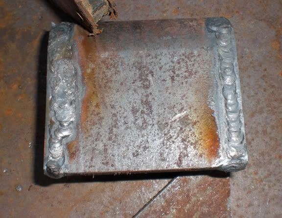

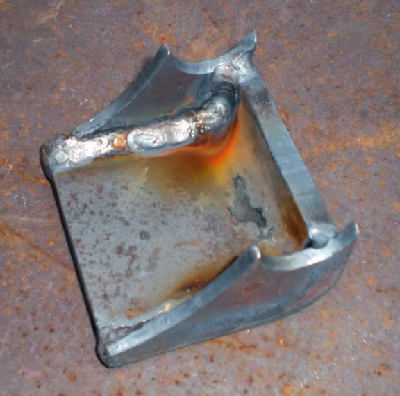

Today I cut out the pieces for the gusset that the rear top mount will bolt to on the sidecar frame. I used a piece left over from the tube I used for the axle mount. I got a little carried away and forgot a couple pictures. Here are the pieces welded together. I used my TIG torch here at home to do this:o)
Photobucket
The inside was a mother bear to get to. I had a hard time getting the torch head in the right position.
Photobucket
After I welded everything. I let the part cool and then attacked it with a poly fan on a hand grinder. It turned out really good. I'll probably fill the couple of low spots that I have.

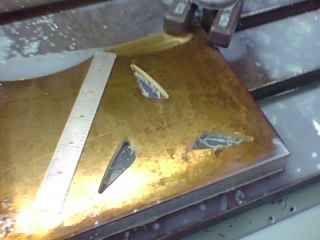

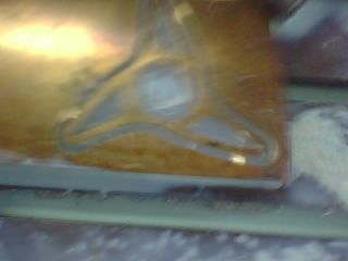

Well I've still been a little sick, I have a cough that is getting annoying. But, I think I'm starting to get over it. It's not too bad today. I went in after work and made the spinner piece that I was talking about a few days ago. The mill was acting up and I had some troubles, but I have something to work with now.
Photobucket

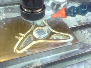

Here is the brass after the first part of the program was ran. I had to mill the center of the spokes out with a 1/8" end mill.
Photobucket

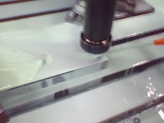

I changed to a 1'4" end mill and cut the center out.
Photobucket
Here I'm starting to do the outside profile.
Photobucket
Here it is done. You can see the tabs that I left to hold the part while it was being machined. I just cut the part free with some Dikes and file the burrs. after I'm done.

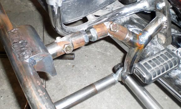

Got to play some more today:o) I had to shorten the rear mount some. The clevis/Eye's that I made I thought were going to be too short ended up being a little lnger that I expected. Here are a few more pictures.
Photobucket
Here I have it ground down to the line. I'm test fitting the piece with a scrap piece of tube.
Photobucket
Here it is all together. I have the bracket welded on and everything installed:o)It is a lot more solid now! I just have to finish welding everything now.
