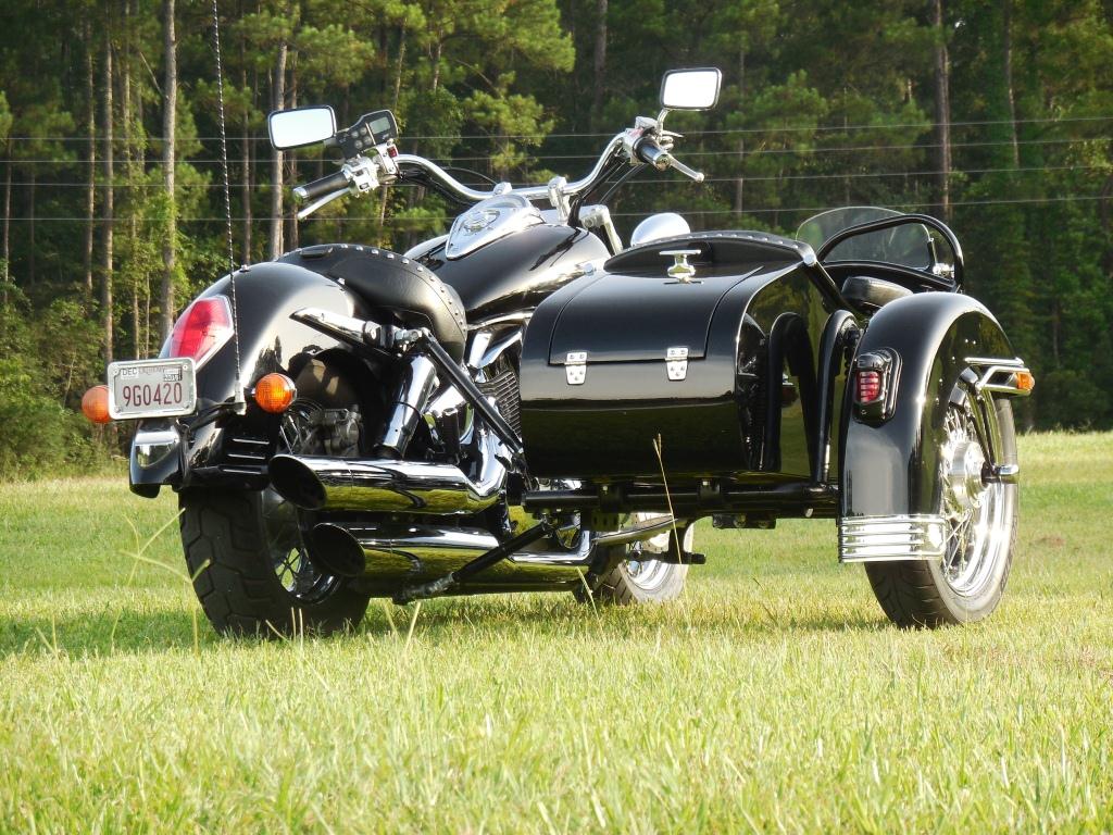

I finished my rig last week and I still have an unacceptable amount of head shake from 25 mph up to about 40. I have tried the directed lean out, toe in and castor, messed with all kinds of air pressure settings and have greatly reduced the issue, it's steady from 40 up to over 90 mph, but still not dialed in.
I have no dampener or altered triple tree and I am told that if set up correctly its not needed but still embraced by some.
The question is: Does anyone know of a person or shop near the Mississippi gulf coast that I can go to for help, the closest I have heard of so far is in Texas?
