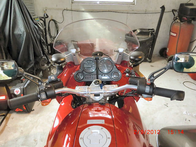

Got the LSL kit from Spiegler installed, what a difference! It uses a superbike style bar that is wider and has less angle than the BMW RS bars. My wrists are now straight and the pull back and width give the steering a much lighter feel.
This pic shows the bars installed

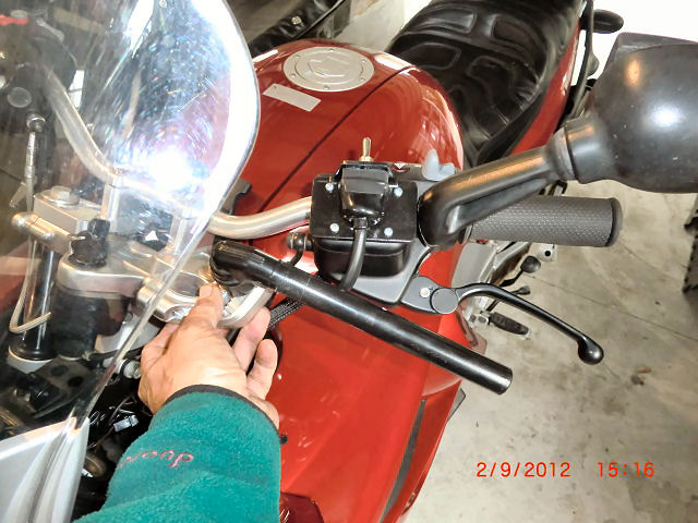

This shows the difference in angle and width from the stock bar. Since the kit comes with a longer brake hose from the master cylinder and requires brake bleeding, I went ahead and replaced all the lines with Spiegler's.

Bobmws - 2/9/2012 6:49 PM
Got the LSL kit from Spiegler installed, what a difference! It uses a superbike style bar that is wider and has less angle than the BMW RS bars. My wrists are now straight and the pull back and width give the steering a much lighter feel. This pic shows the bars installed
Hey, that does look much more "user friendly" for a rig. Very nice.
