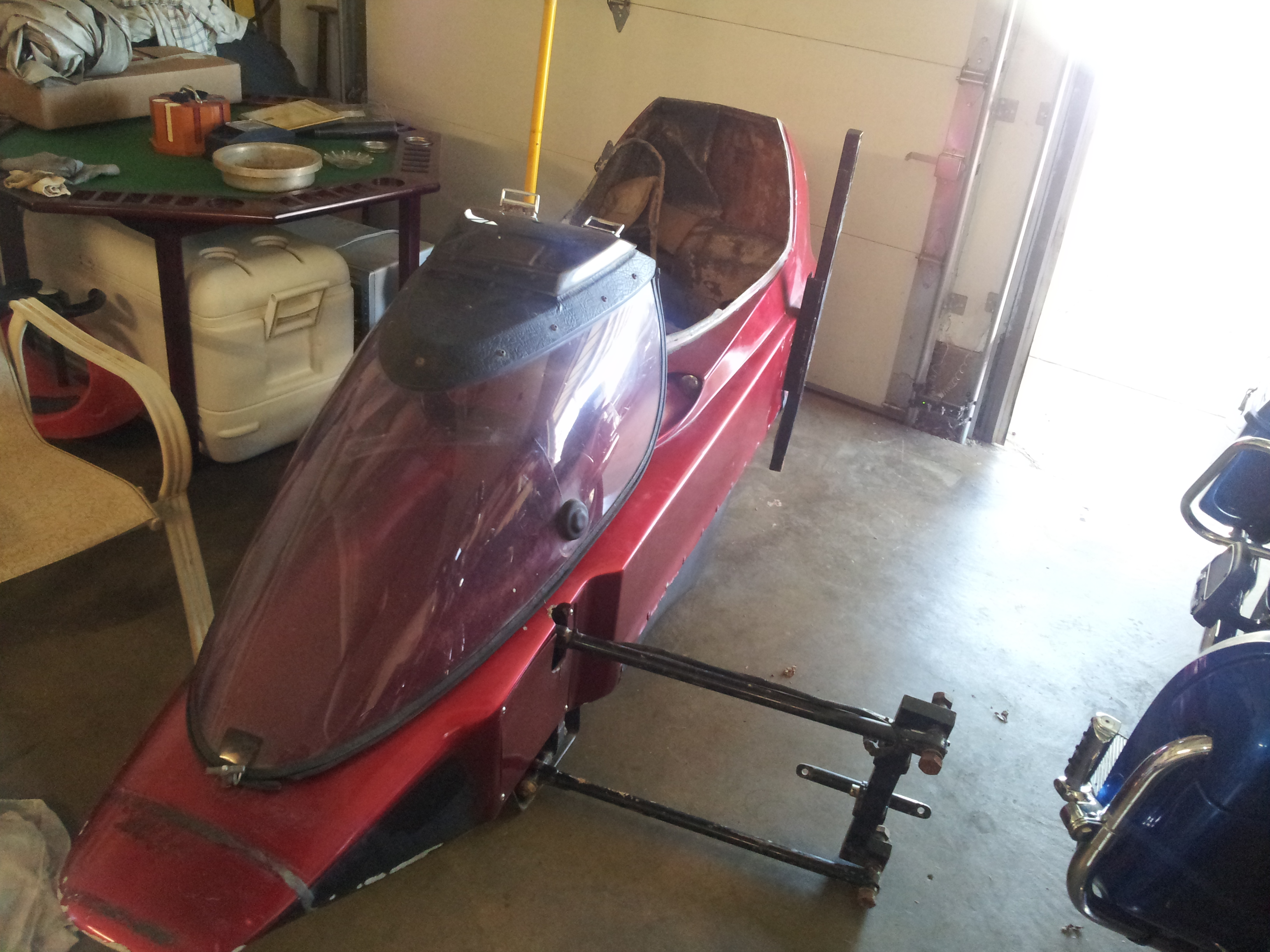

now to the nitty gritty! i recently aquired an equa-lean. i understand parts for these things are pretty darn scarce. well i need to completely go through it because it was in a flood down in southwest texas a few years back.so far here is what i know i need.
seal and hinge between the windshield and body replaced. ( im pretty sure i have a hinge that will work)
tire
wheel bearings
maybe the seat ( not certain on that as i have yet to remove the 200ish pounds of dried rio grande mud out of it, but from what i can see the seat is in bad shape)
misc bolts ( i think everything is there but they are really rusty. flakey rust bad even)
the straps that are on the inside to hold the windscreen bubble locked in place. ( kinda look like rubber bungy cord material with bumps on the end that pop into a bracket)
good news is the frame and body appear to be in really good shape and with the price i paid for the side car, i shouldnt be hurting too bad once all the parts that need fixed are replaced.
if anyone can turn me on to a place to pick up any of these replacement parts i need ( not so much worried about the nuts and bolts as im sure i can get those from a hardware store) i would be forever in your debt. aftermarket things would be fine i just want it to work, and work safely. once i get this stuff replaced, then ill focus on mounting hardware and im sure ill have some more questions for you fine folks

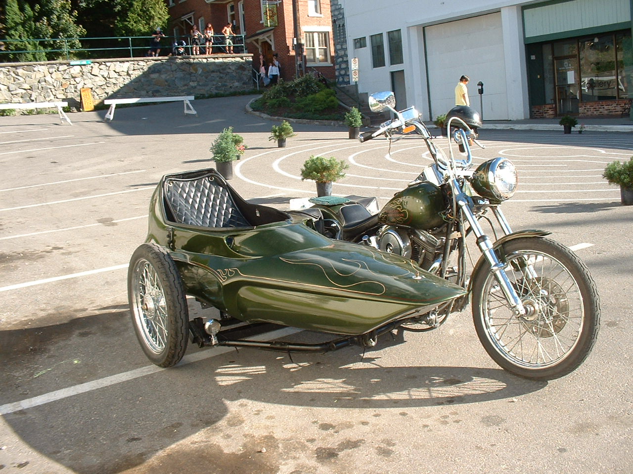

Here's a rigid mounted Equalean seen at a Sidecar Rally in Nelson, BC.
L.
Posted : February 2, 2012 10:47 am

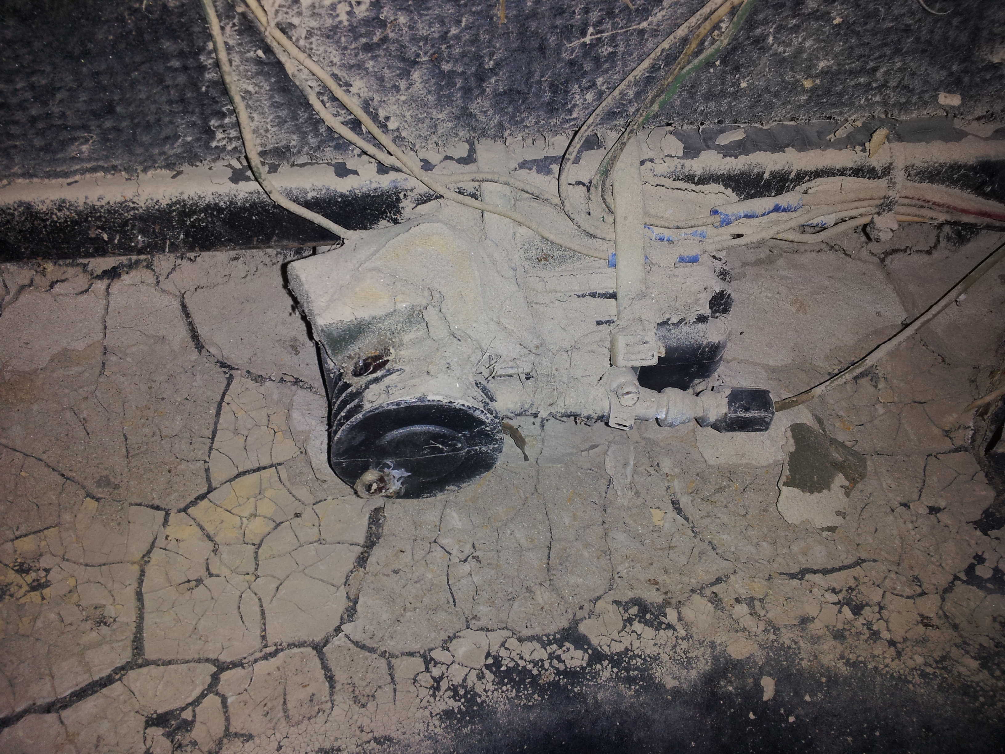

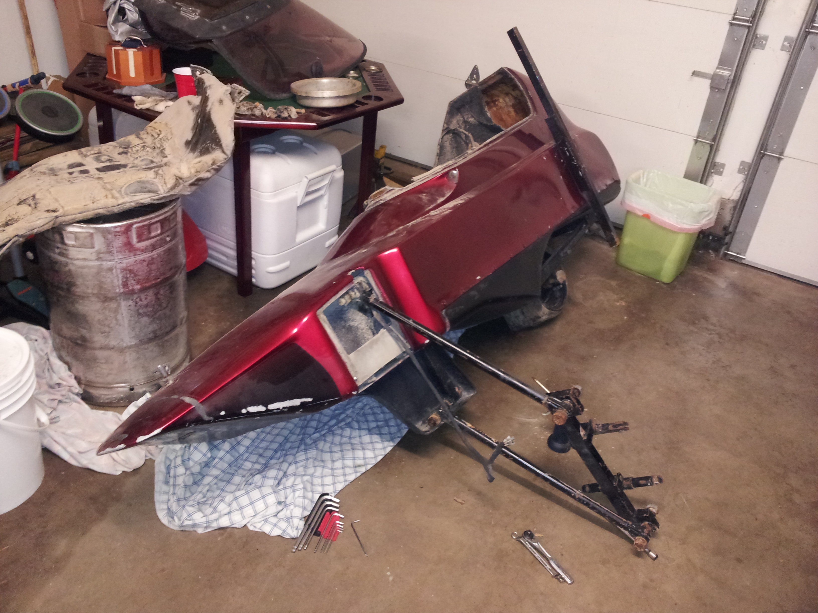

Well, thanks to john, hes given me enough info to feel comfortable with starting tear down. Decided to just go completely through it. Apparently a previous owner had an air pump added for some reason...
Posted : February 3, 2012 4:21 pm

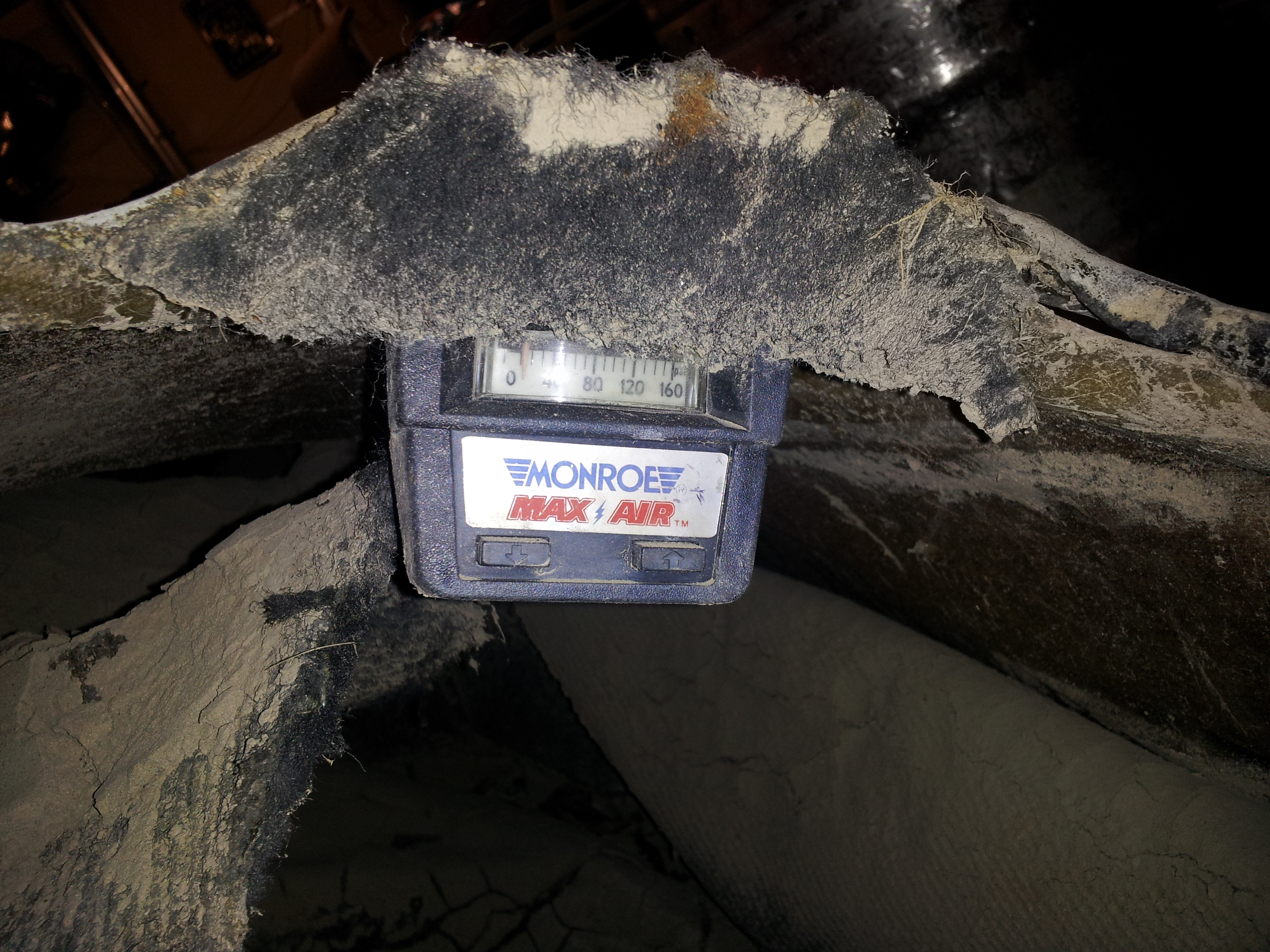

The pump was to adjust the suspension (Monroe air shock).
L.
Posted : February 3, 2012 6:17 pm
I was under the impression the equaleans didnt have an onboard compressor though????
Posted : February 3, 2012 6:32 pm
We have seen the on board air done exactly like yours so I suspect it was factory
Posted : February 4, 2012 5:38 am
