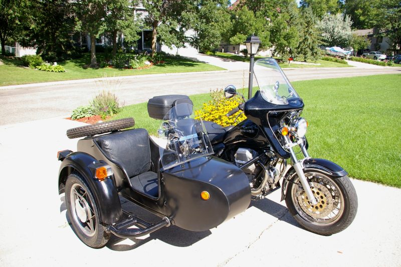

Finally got my Dnepr car mounted properly on my '98 Moto Guzzi V11EV and am having a lot of fun with it. Used Dauntless mounts and they worked great. I have attached a couple of photos for those interested.
My question: I need a new front tire (current front is a well worn Dunlop D404, sidecar has a new D404 on a Suzuki cast wheel). My rig has a head shake at low speed, 10-20mph. Worse on rough roads. I understand this is somewhat normal. I have the stock steering damper adjusted as tight as it will go, but not sure it is doing much. I am considering a Metzeler Block K on the front; stock is 110/90-18, so I think the 4.00x18 Metzeler should fit. Some of the ads I have seen list the Block K as a tire for small-medium size bikes, and the Guzzi is not what I would call small-medium. Is this a problem? Do any of you out there with experience with the Block K think it might help with the low speed head shake?

I've found that the stock Guzzi will barely control head shake on a lighter car such as the 562 Velo. The stock trail front end will probably need a stronger damper to eliminate it altogether.
No experience with the K Blocks but a lot of Beemers use them with good feedback.

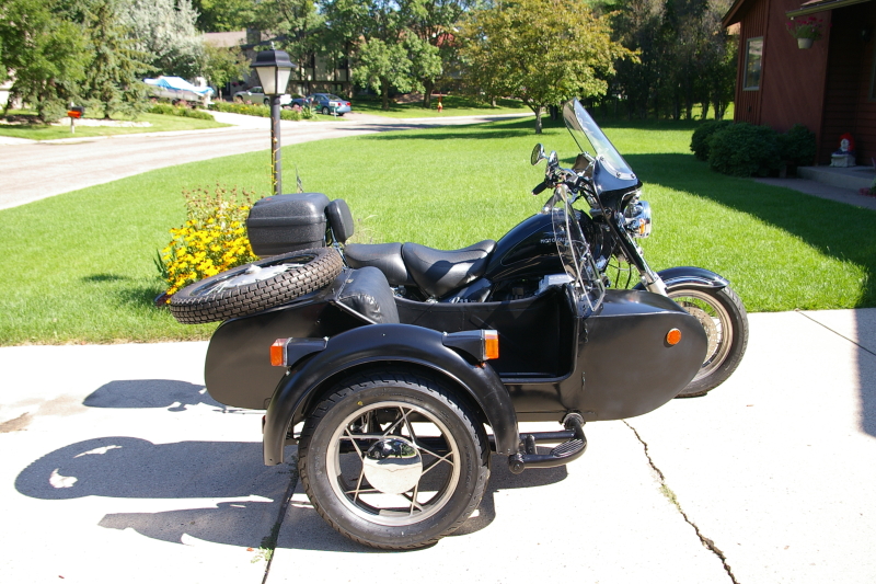

Nice looking rig. What wheel are you using on your sidecar and is it a bolt on or did you need to modify the axle?
Thanks,
Posted : August 28, 2009 6:51 am
The wheel is from a 1980ish Suzuki GS1000. It was a bolt-on, as the Suzuki had a 20mm axle and all the dimensions worked. I left the disk off. Had to use a tube, as the rim was not marked as tubeless. Seems to work quite well.
Lonnie, thanks for the tips about Guzzis. I think I will try the Block K and pursue a stronger steering damper.
Posted : August 29, 2009 3:07 am
Just a followup to let you know how this turned out- I mounted a 4.00x18 Metzeler Block K on the front of my Guzzi rig, and ordered a Matris hydraulic steering damper from MG Cycle in Albany, Wisconsin. Finished adjusting the toe-in and mounting the new steering damper tonight, and found that my head shake problems are solved. The Matris damper is a direct replacement for the Guzzi V11EV damper (which did almost nothing) and is very strong- when I turn it up near the top limit of the click stops, it provides very stiff resistance. Expensive, but well worth it. I set it on about the 70% level on the click stops, and the rig handles beautifully at low speeds and on rough roads.

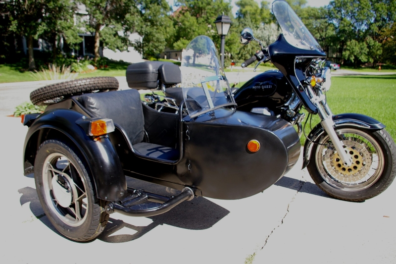

Beautiful rig, Lars! what type of fairing is that on your Guzzi? do you know where I may find one?also did you adapt that windshield on the hack? Im curious what you used, , as I have a small memphis shades on my hack, and my wife would like more wind protection. Thanks alot, Rick.

Bigbikerrick - 11/18/2009 10:49 AM Beautiful rig, Lars! what type of fairing is that on your Guzzi? do you know where I may find one? Thanks alot, Rick.
Looks like an H&H. Harpers claim to be the only source of new ones.
http://www.harpermotoguzzi.com/fairing.htm
Posted : November 19, 2009 1:31 pm
The fairing on my Guzzi is one of the last made by the old Swanee Aerofoil company. They went under in 2001, I believe. The H&H fairing that Sidecar Mike provided a link for appears to be almost identical - must be made from the old Swanee molds or something. I've been riding with this fairing for about 9 years now and continue to appreciate it. A reasonable amount of air flow to keep a big guy cool, but no buffeting due to the center vent design.
The sidecar windshield is one of the old Moto Guzzi Classic windscreens sold for the California series that I cut down to fit the Dnepr. I took about 4" off the bottom, bent the reinforcing ribs to form mounts, and fabricated a center brace. I like the look, but it doesn't fold down like the Ural-Dnepr windscreens do, so the gas mileage takes a hit.
