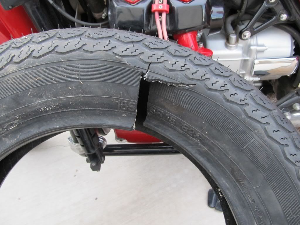

 OUCH!!!  Pago, I hope you don't mind if I cut and paste a portion of the story and the pic over for quick reference.
 ... So I bought the [155R15] tire and took it to a local shop. I warned him that this may/should work, but we needed to be real careful, as some had to use extreme pressure in order to seat the bead. He said "no problem" and said he would be real careful. I was watching/helping him mount it, and he got interrupted several times. So when he went off talking on the phone I went next door to a machinist shop as I had business there. Shortly thereafter, we heard a POP/BLAM, and the building slightly shook. Then a whole bunch of cursing.
Went next door, and the tire guy was holding his very red/swollen hand up in agony, bouncing around and cursing up a storm. The tire looked like this:
We got him loaded up on advil to combat the swelling, and cleaned the cut. He was a big muscular guy, and was very very lucky. Nothing broken, but badly bruised and swollen.
So. Yes, it can and has been done; BUT..... (emphasis added)
