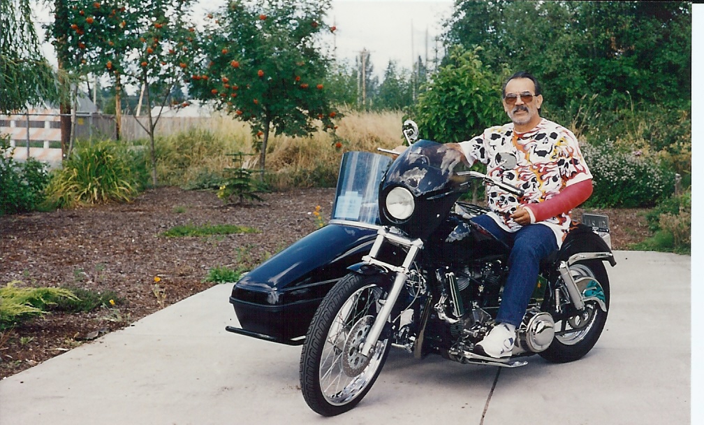

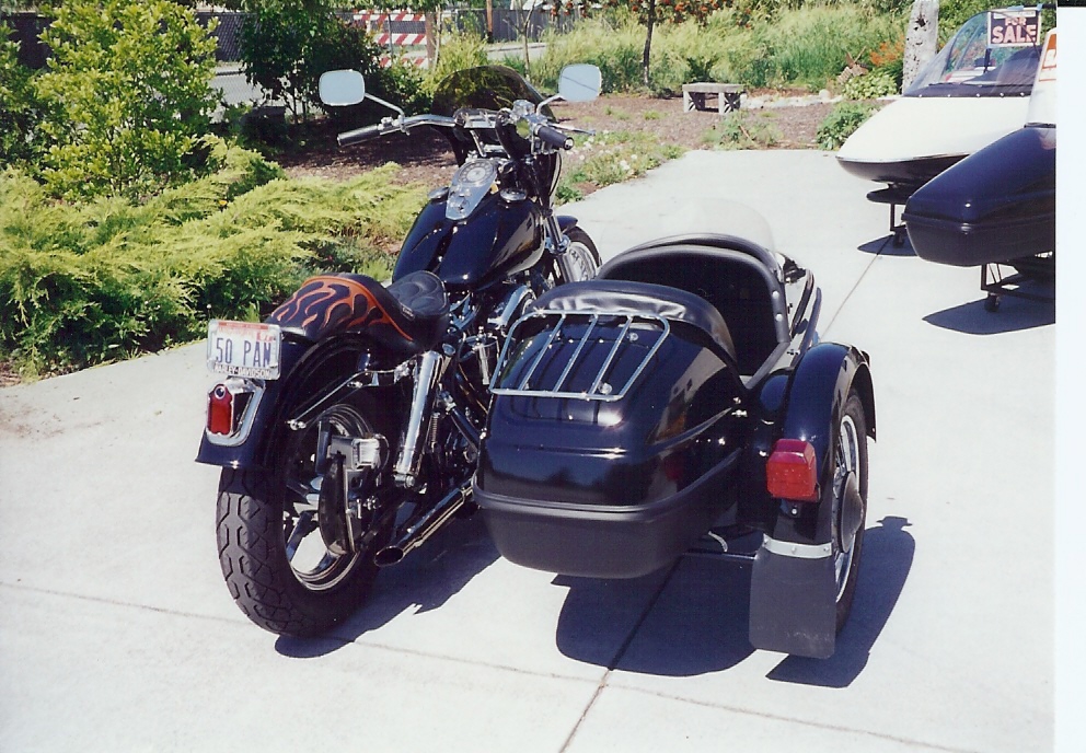

On a '50 Panhead/562 rig I had in the past, an oil slick kicker pedal caused a shredded ankle when my foot slipped off and I caught the rear mount clamp of the hack on the way down. Like a lock kneed kickback it took quite a while to heal up.

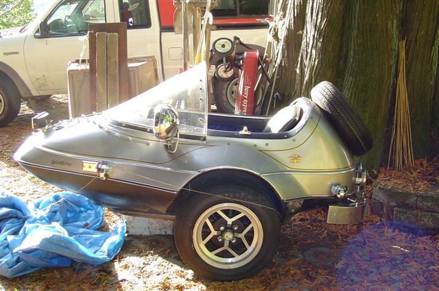

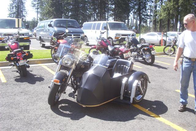

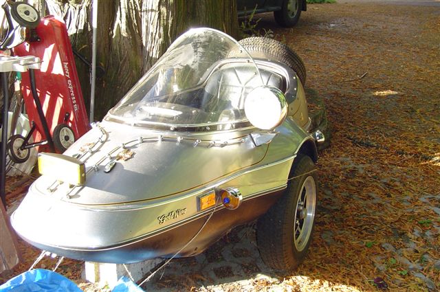

There are a few lefties around. We had a nice CSC Companion leftie in the shop a few years back that we sold to a guy with a Harley Kicker, and here is a CSC FS I leftie.
The scarey part of lefties (for the monkey) here in the US is when the driver pulls out to see if there is room to pass. By the time one is far enough into the oncoming lane to see if it's clear, the hack is in harms way.
L.
Posted : November 28, 2011 7:12 pm
