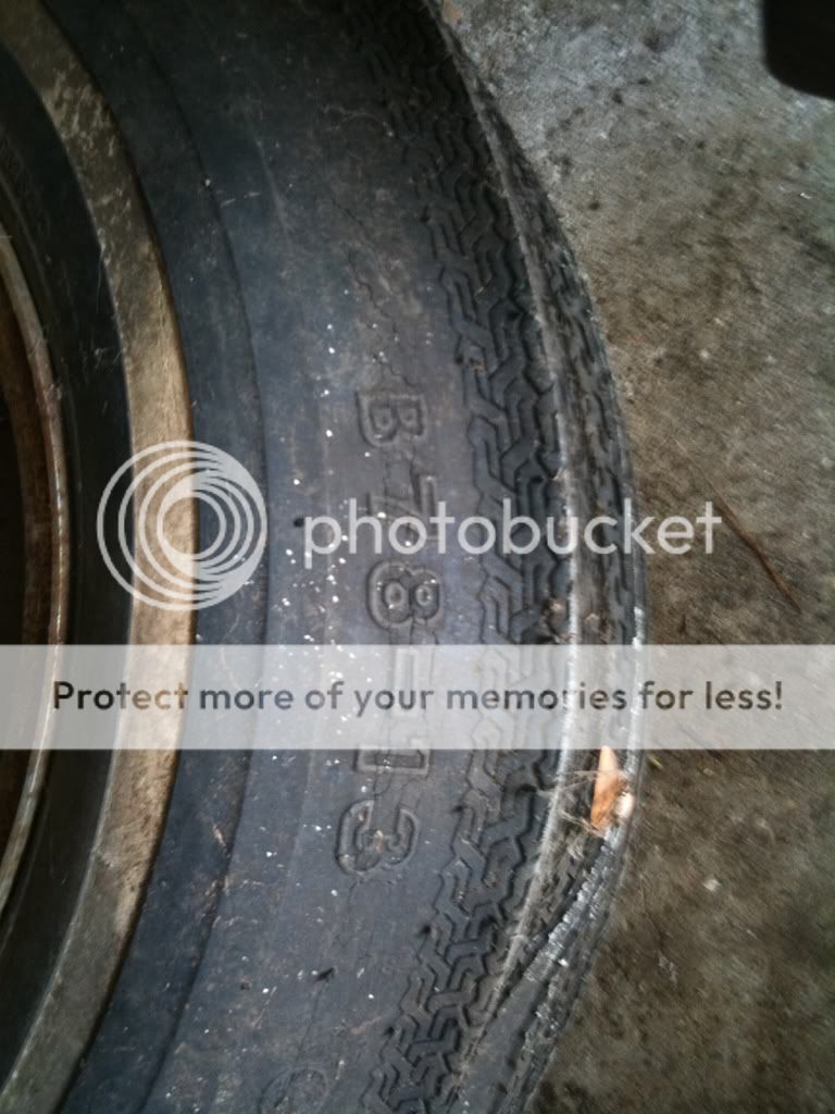

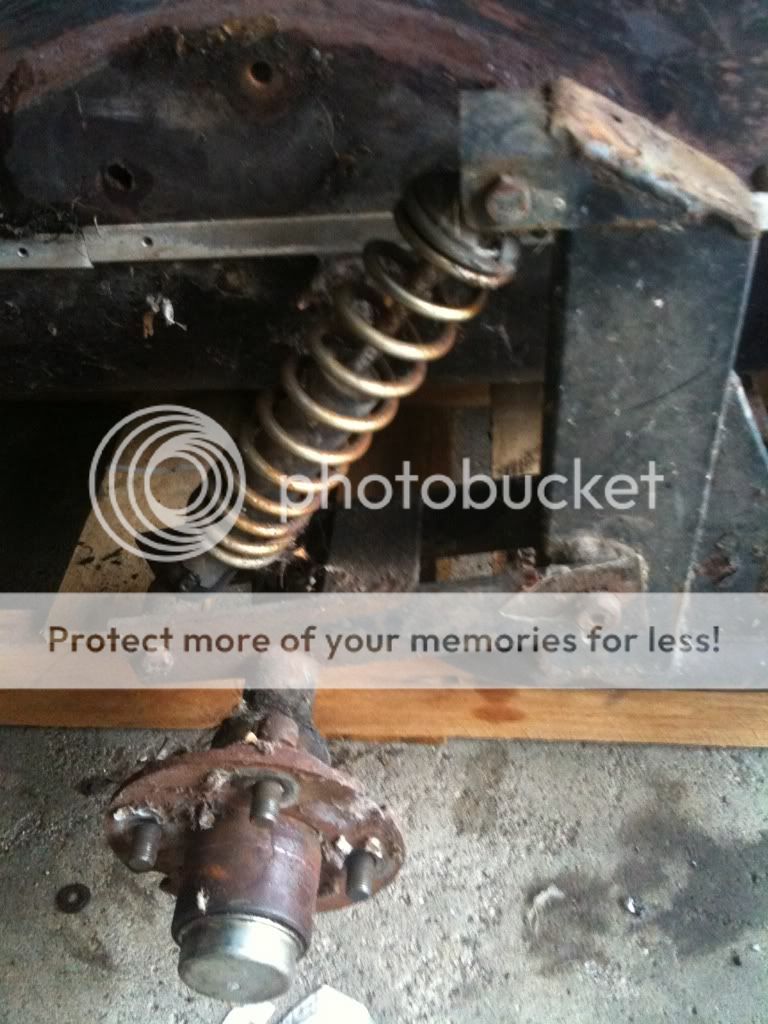

1. The wheel rim needs to be either replaced, or rechromed or otherwise refinished. I'm considering replacement. The rim I have is 13-inch with 4 bolts. While looking up rims on-line, there are a few more numbers to consider. As an example, I see a 13-inch, 4-100 or 4-110 (as well as others). What does the 100 and 110 mean? Is that the measurement of the hub hole in millimeters? Distance between studs? Stud diameter? What is the wheel off-set?
Photobucket
2. Can I mount any 'ol 13-inch tire on the wheel or do I need to match the original as close as I can? Radial or Bias Ply? Does it matter?
Photobucket

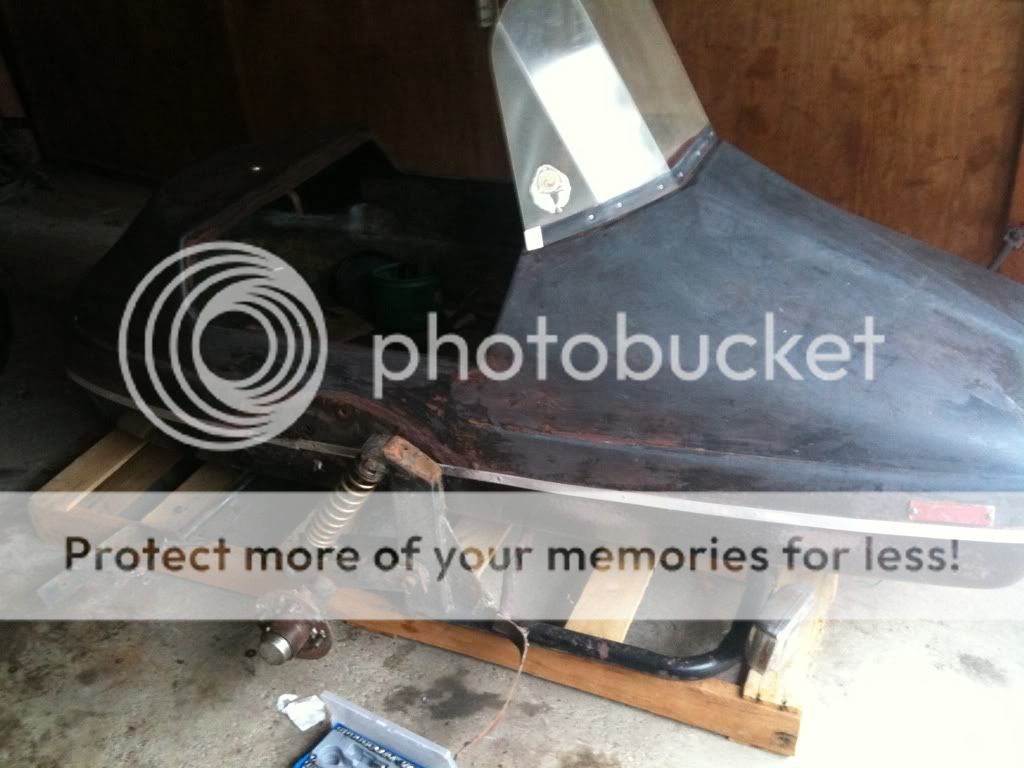

3. I don't know anything about the shock, so I'd like to replace it. How does one go about sizing a replacement shock as far as strength? Is an air shock an option?

4. Going to replace the wheel bearings too. No questions here other that if anyone knows of anything unusual about this hub, I'd appreciate it.

If you can find a short air shock, you can give yourself some easy ride adjust. We used to use a bicycle hand pump on the Hitchhiker. About three strokes took you from very soft to very hard.

Looks like a standard 4 on 4" trailer hub with 1" axle stub and Timken bearings.
Measure the offset needed from wheel mounting flange to the swingarm pivot point. Do the same with a mounted replacement wheel. A 13" high speed trailer wheel/tire assembly will work just fine.

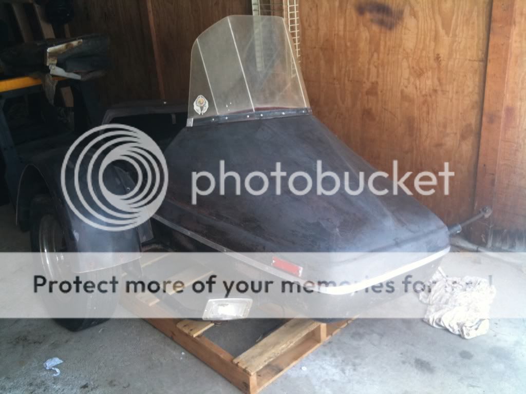

OK, got the tub off the frame and have removed the windscreen, reflectors, brake light and other misc nuts and bolts. Fender and tub are at the paint shop while I ready the frame and tug. Found that GL1100 air shocks are the right length. Handy as the tug is a GL1100 and consistency of parts, IMHO, adds to the elegance of the solution.
Windscreen:
It's rather cloudy and has paint on it from a PO's ham handed paint job. Can this be cleaned up? Replaced? The creases in the screen are all pretty straight. Would it be difficult to get a lexan sheet of similar thickness (3/16th it looks like) then use heat and a straight edge to make my own?
Posted : March 7, 2011 4:27 am
Windsheild doesn't look all that bad. Find yourself a tube of Flitz Polish and follow the directions on the box.
Posted : March 7, 2011 4:33 am

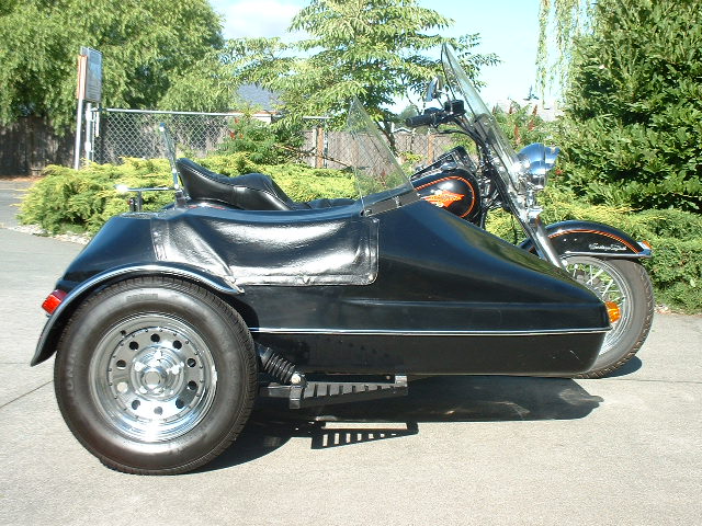

If you do end up needing a replacement, yes, you can bend it your self or I can look up where I had a replacement made in original size. You might also think about how high or low you want it. I cut mine and contoured it some to have a lower one for the kids, but my wife likes a higher shield. I've got a local guy who is going to make me a higher one as soon as I get off my duff and measure how high my wife would like it.
Here is what it looks like with the short windshield.
DFW Ride for Kids
Posted : March 9, 2011 6:24 am

It would appear that there was a change to the fender configuration in the years between your car and mine. My fender is much bigger and covers the shock. Also, my shock angles to the back, not the front.

Yes, I notice the differences you're talking about. My frame is also made of square tubing rather than the round in yours, but it all looks similar and has the same tub. You probably already know that Texas Sidecars (now in Leonard, TX) inherited/bought the molds for this model, but they had a fire at some point that damaged the molds and have chosen not to redo them. If you do need something for yours, Bob at Texas Sidecars might be able to help with that.
For lighting, as you can see, I wired up a basic $20 driving light going forward and ran the wires underneath along the frame to quick connects to the bike. I started with 100 watt, but changed to 55 as it seemed to be too bright for those in front of me. I used some surface mount oval LED taillights on the back (surface mount so that I only had to drill holes big enough to run the wires inside), but realize I don't have any pics of the back.

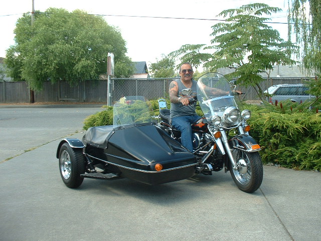

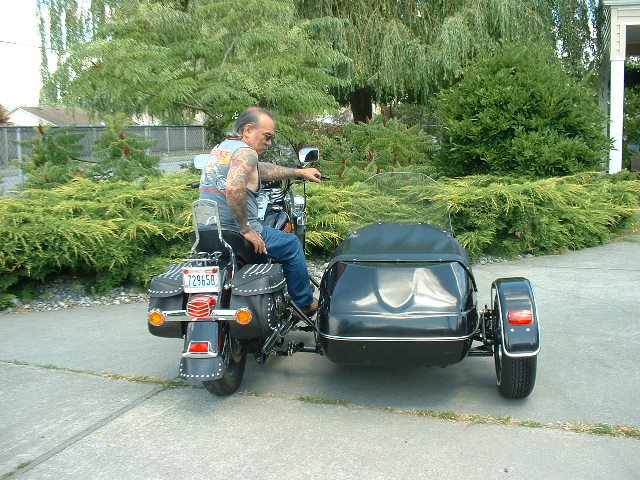

Here's one of the last Texas "Twinstar's" made. Note that the shock/swing-arm is set up different than the Gemini. Frame is square tubing and it used a trailer fender.
Posted : March 9, 2011 9:26 am

Same frame & shock setup (different shock, though) as mine. I removed the chrome trim piece around the middle when I painted it all black. On mine, the wheel has an exagerated natural negative camber that I wish wasn't there or was decreased a bit, but it appears that the block on the frame that mounts the wheel assembly was made that way from when it was assembled. But, I'm guessing you've seen every kind of combination imaginable with all the rigs you have seen and had a hand in.
Looks like someone did a nice job on the taillight in the fender. I keep thinking about putting a turn signal out there to go along with the running/brake lights I mounted on the rear of the tub.
