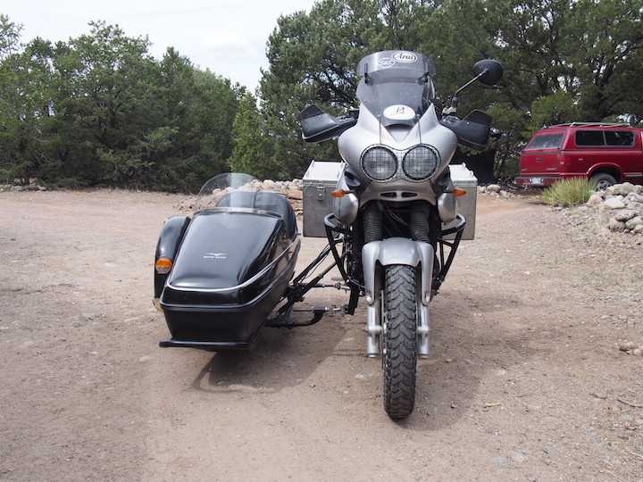

Who installed your car on the Triumph? Any pics of the mountings? Thanks.

I installed the sidecar to the Triumph myself. Can I post photos here? I haven't read up on that, or on how to do it on this forum.

Here's the sidecar attached to the Tiger.
