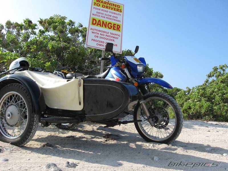

It is not too heavy, but for off road work you will need more ground clearance. I have a DR 650 with a Ural hack. It has the ground clearance and the ruggedness. Think about Russian roads.
As for power, it has always had enough power, Butt, and this is a big butt, getting a larger rear wheel sprocket is a plus. Not because the engine doesn't have enough power, but because of control tractability. Off road there will be occasions when you will want to go real slow so as not to bounce your bottom frame or engine on rocks. The lower drive ratios allow you to do this without slipping clutch, especially if it is on an up hill.
I tried sprockets of 4 different sizes and am happiest with a 49 tooth rear wheel sprocket. The original only had 42. I tried 43, 46, 48 and now at 49 I am where I want it to be. Your killer kaw will have similar ratios so I would recommend going at least five or six teeth larger with a 200 pound sidecar or heavier.
Get a more comfortable saddle too.

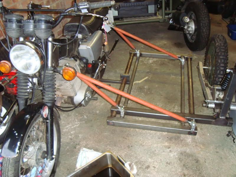

KLR isn't too strong for offroad sidecar? If there is no need for passenger tube on sidecar (only for luggage or dog) there is simple "patent" to gest frame stresses way lower than with classic triangulation. Try to mount lower points of upper struts as far from bike as possible, like in my setup (not my idea):
If I made it standard way with the same materials, tube walls etc, it would bend&brake after first few miles. This way made, and I could get 100pounds on sidecar and ride in any terrain that engine could haul it.

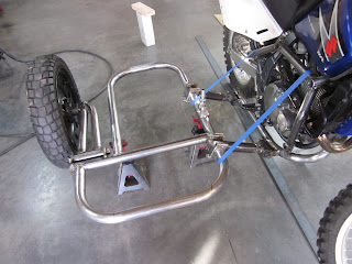

Compare upper photo with standard upper struts mounts (upper struts represented by blue bands):
standard rig
and think what forces try to bend the sidecar in my "big triangles" setup comparing to standard one.
That was my inspiration for first rig:
mz
Slightly harder to get right geometry (toe-in, lean-out) because od four struts to regulate and because change in one parameter always make chanke in other, but you could make it one time and eventually re-setup in case of some error. But this design includes all elements that I would recommend to you for "heavy duty - light weight - small cost" offroad rig. Excellent triangulation, one lower mount, square tubes, simple design&build, two-sided sidecar swingarm. Velorex (especially used one, older) can have 15mm axle, that can be too small for offroad. With two-sided swingarm, you could use even 12mm one with better effect. If you use 15mm axle for 2-sided swingarm, it will be far more than enough. http://www.advrider.com/forums/showthread.php?t=680239 - here you have whole thread about this sidecar. Cheap and robust one.
Finally something like this:
mz2
I don't know how experienced you are, but you always may try to fabricate your own sidecar. That was my way and I'm really happy with that. I'm also cheap/poor - my whole rig costs less than typical sidecar alone.
