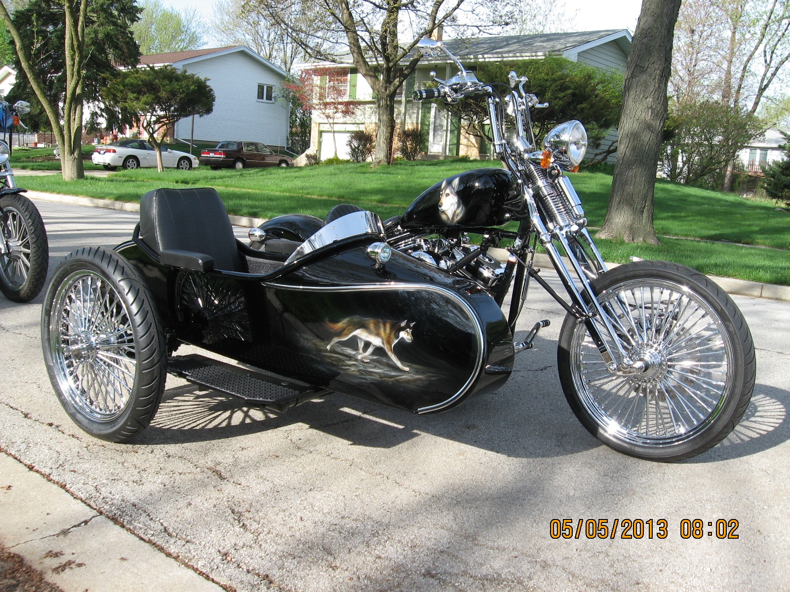

Here is a picture of my rig needing a new damper.
It is dedicated to my riding buddy who passed away.
But his spirit and image still rides with me

I would start by rather then covering up a front end shake, fix the problem. First the sidecar mounts must not flex. From what I can see the lower rear mount looks almost like you went with two upper rear mounts rather then an upper and a lower rear mount. The 4 mounts should be as far apart as possible. With the upper rear mount set as high as you have it, when you go to fine tune the aligment which might help with a front end shake. When you adjust lean out, you change your toe settings. With the upper rear mount as high as it is, when you lean the bike out to fix a pull to the right, you end up at the same time decreasing your toe setting causing more of a pull to the right. Also springer front ends tend to not be the most solid front ends. Make sure that the springer front end is in good order, You can lower your steering effort by changing the lenght of the rockers on the springer front end.
If you do end up adding a damper, Clamp it to the non moving part of the springer front end, near the top. The other end can go to either side and attach to the top of the engine. Go with the VW damper. We make a kit for Sportsters done this way. It works well.
Posted : May 13, 2013 5:14 am

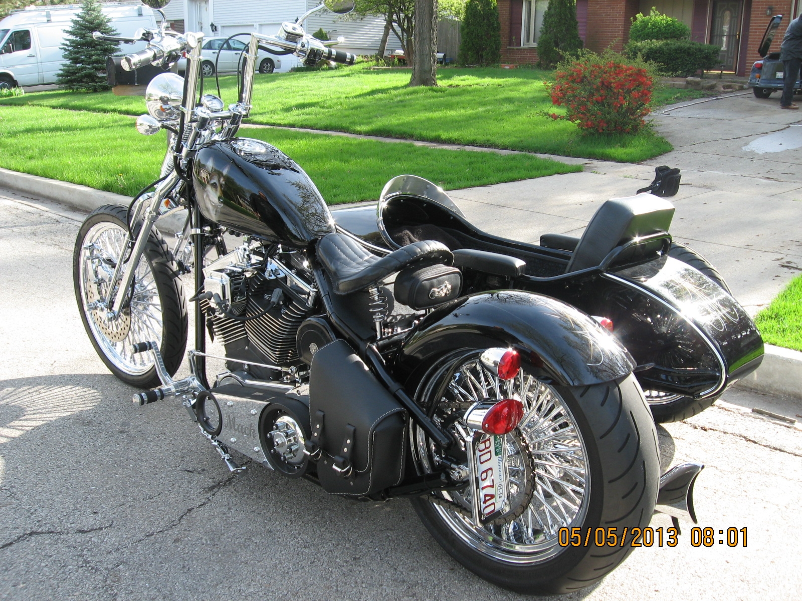

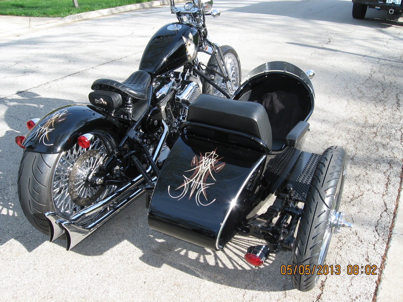

For whatever reasons, in most times I wear a belt and suspenders...lol lol lol...so---that being said----the rig has 3 rigid mounts at the bottom, 2 at the bottom frame rail and 1 from the lower down tube.
What are seen in the pictures are the 3 lean out adjusters, 1 at the frame back bone under the tank and 2 at the rear frame top wishbone.
The rigid bottom mounts were not able to be spread out to agree with the length of the sidecar because of interference of bike components...hence the 3rd lean out/rigid mount at the top wishbone of the bike frame.
It was pulling to the left and I adjusted to bring the bike towards upright--but--I haven't test ridden it yet--will check the toe in as you noted. Will also rethink the VW damper per your suggestion. I prefer to leave the rockers as is.
I'm thinking of installing a front fork brace...I have a brace and the fork legs have provisions for it.
