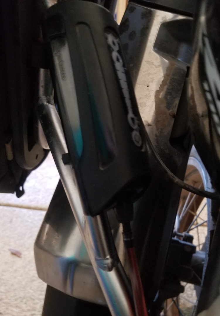

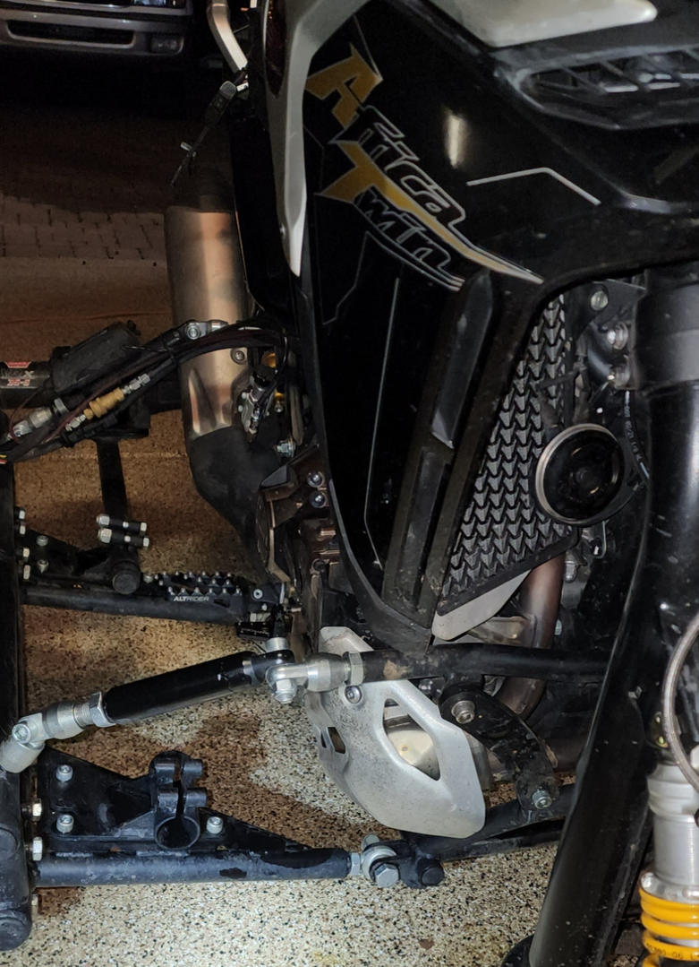

@miles-ladue Though the left arm of the swing arm, rubber grommets, is the way to go...  I found mounting the reservoir unit on the upper rear strut of the sidecar mount to be convenient.  Just needs to be up high enough for gravity to assist when it opens the valve.
Had the one on the solo AT mounted on the RH side luggage rack; worked well.
Current location on the rig... Just above the brakeline quick release.
