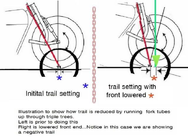

ALSO See pic below.It shows negative trail in th eright side picture but shoudl relay the idea anyhow. No, you do not want to rteduce trail too much. Negative trail is not controlable..if you want to feel what negative trail is like run your rig up and incline , put it in neutral and coast back down backwards. No self centering effect at all...not good. The more trail is reduced the less self centering you will get.
