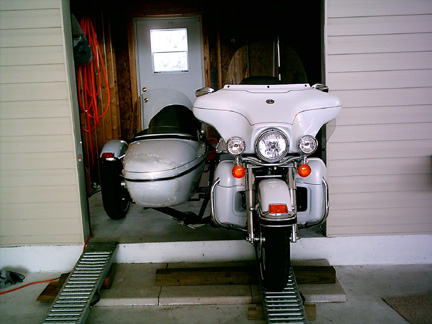

Well as I said before the Belt looks very much on the Light weight side considering it was bought from HD as a complete Rig- and the bike is an Ultra Classic.
So How did I get the rig - 6ft 4ins into a 6ft garage door - easy - Picture enclosed!
Paul

Although the 2003 and later belt is somewhat narrower than prior belts, it is made from stronger stuff. They seldom fail in actual use and, if you have a steady hand on the throttle, you won't put any more strain on it than a solo bike.
I'm not really concerned about mine. Kits are available in the aftermarket to convert a belt drive HD to chain drive. The down side is that chains are a bit on the messy side snd a little noiser than a belt. That could put your mind at ease, I guess. If you were to change to chain drive, you could easily gear the machine any way you want without modifying the primary ratios. I estimate about $350 for parts with two sprockets and a #530 O-ring chain if you do your own work. (I do)
BTW, don't you mean a six-foot wide biue and a six-foot four garage door?
Looks good.

No the Garage door opening is 6ft and the Rig is 6ft 4ins- just needs a bit of manouvering!
