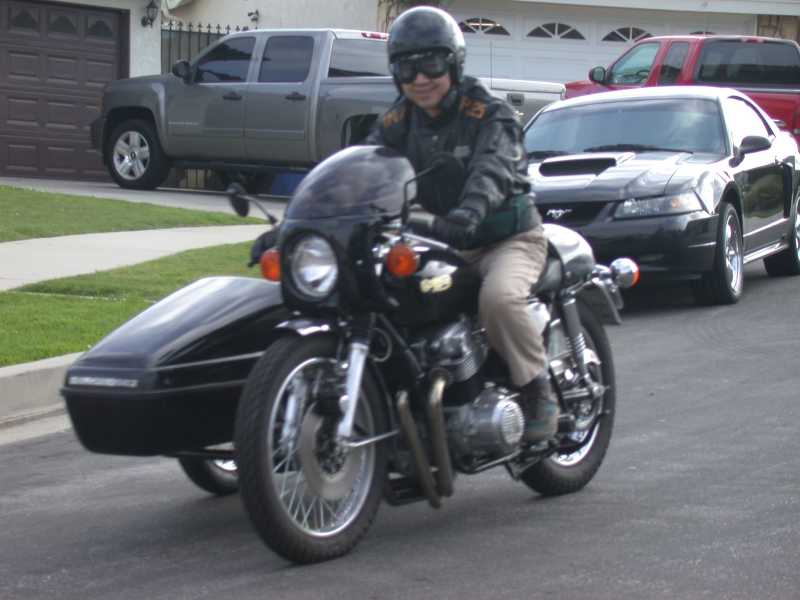

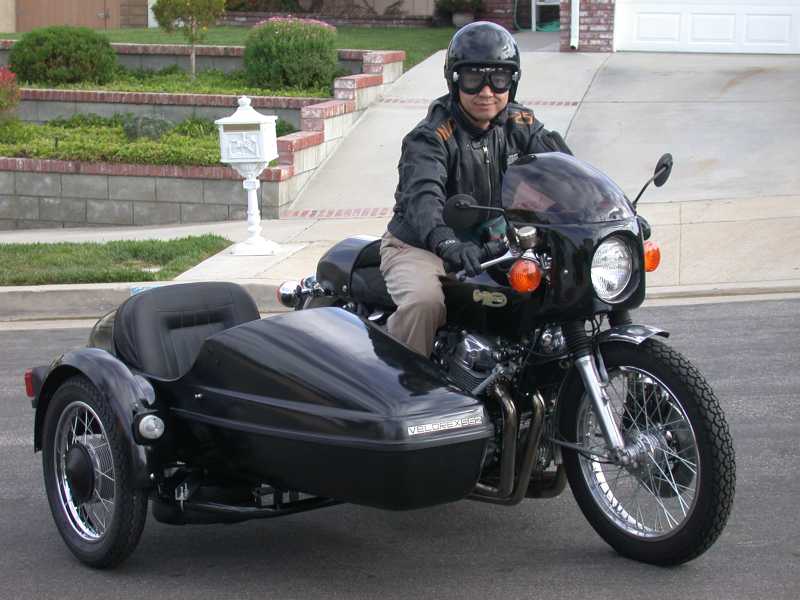

Hello,
Thanks to the kind help from forum members, I had my first sidecar experience today!
That's the good news. Bad news is that the rig had severe steering osccilation at low speed and steering is very heavy.
I understand I should install steering damper and somehow reduce the trail..
Does any one have ready-made solutions?
My rig is '75 CB750K + '90 Velorex 562.

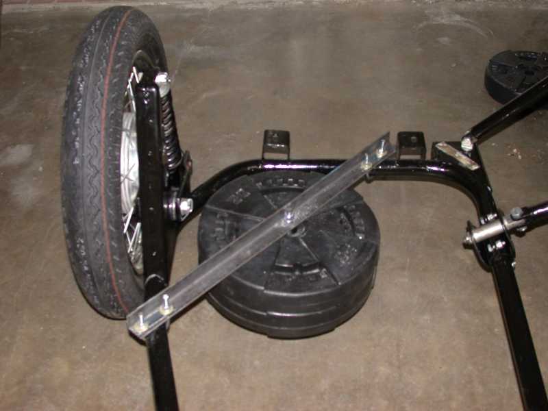

I mounted 40 lbs ballast to the frame.
The rig seems to go straight at speed (~30 mph).
I uploaded pictures to skiri251's album.
Is there any way to attach pictures from the album to the posts?

Pretty rig! You can add a steering damper and it will mask but not cure the oscillation and it will make steering even heavier. Here are a few things you can try to improve your handling.
Check your mounts-bounce on the bike and on the sidecar and watch for movement or flex. Some rigs do have a wobble or oscillation at certain speeds but a loose or flexible mount will also cause this.
experiment with tire pressures. Check your tires for wear. Mismatched or worn tires can also cause this and sometimes a slight change in tire pressure front or rear can fix it.
Make sure the alignment is good and be sure and check it with the shocks compressed as if you were aboard the bike. Steering effort and wobbles can be affected by changes in alignment. Mark your mounts so you can tell where you started, then change one thing at a time and see how it affects handling. You can always put it back to your original marks if you don't like the changes.
You may be able to slip the forks up in the triple trees and/or put a taller profile tire on the rear and lower profile tire on the front to reduce steering effort by making the steering angle steeper. You may be able to both control the wobble better and increase your leverage for reduced steering effort by fitting wider handlebars
Check the basics and try the cheap stuff first

I slid the fork tubes in the triple tree about an inch and increased the front tire pressure to around 36 PSI.
Big difference.
Now the wobble is less than annoying.
I could run up to 50 mph with no fear.
It goes straight.
The rig goes right on acceleration and goes left on decel but just barely.
It's manageable.
Thanks!
I like the look better now. With lowered front end, it looks more like sidecar rig.
Happy happy, joy joy!
