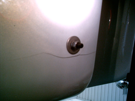

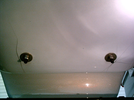

I took delivery of Harley 2007 FLHTCU and Ultra Sidecar- all new Kit-about 6 weeks ago- and a few days ago I happened to be looking under the sidecar and around 3 of the 4 seat bolts there are cracks in the Fibreglass. I can post a photo of the cracks.The Dealer has said bring it in and we will Photo it and speak to HD. Has anyone else had this problem?

I don't know what caused the cracks but I have a 1997 Harley sidecar and there is no crakes in that area.I wouldn't back off Harley they look like cracks that would only get worse with time.

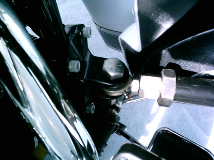

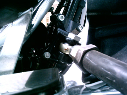

Hi John
Thanks for your comments-I am glad you don't have Cracks on your 1997 Sidecar- I may post a friends comments who's a development engineer what he thinks but will wait for the dealers/HD comment first.

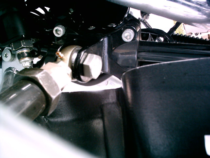

I am enclosing 3 pics of the lower fitting you asked for- hope its the correct one-if you want higher defination pics let me know as I had to reduce these to get them on the forum.
Paul

Hello,
I took delivery of a 2007 TLE (Standard) HD sidecar on January 4, After seeing your pictures just now I went out to the garage with a mirror and examined the underside of my tub where the seat bolts go through. I have no such problem.
Also, I previously owned a 1980 TLE and a 1989 TLE and had both tubs off at various times to do painting. I had no such cracks in either of those tubs. If I had, I would have repaired them myself since I had no warranty on the used sidecar units. I recall very clearly having no such problem.
I presume that the dealer did the installation of the sidecar on your machine. Frankly in my case, I didn't want to spend the money to have the dealer do it so I took delivery in the crate and did the installation myself. I also wouldn't let them wash my car, but that's another issue. LOL.
Your sidecar is fully guaranteed for two years and unlimited miieage the same as all HD motorcycles beginning in 2004. Your problem was probably caused by overzealous tightening of the seat bolts either at the factory at Tomahawk, WI or, more likely, by your dealer. It could also have been caused if the crate was dropped from a height but that's just a wild guess. It's just this sort of thing that the warranty is for. It had to have happened after the unit was painted since it would have failed their Q.C. checks at the factory. We know you didn't do it, for sure!
Were it mine, I'd be going for a new, color-matched body. It's a really easy installation, by the way, only six bolts, not counting the seat bolts in question.
Please tell us what the dealer says. I'll be pulling for you.
Good Luck!
Posted : April 18, 2007 8:29 am

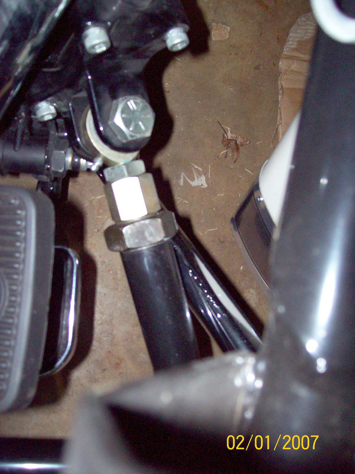

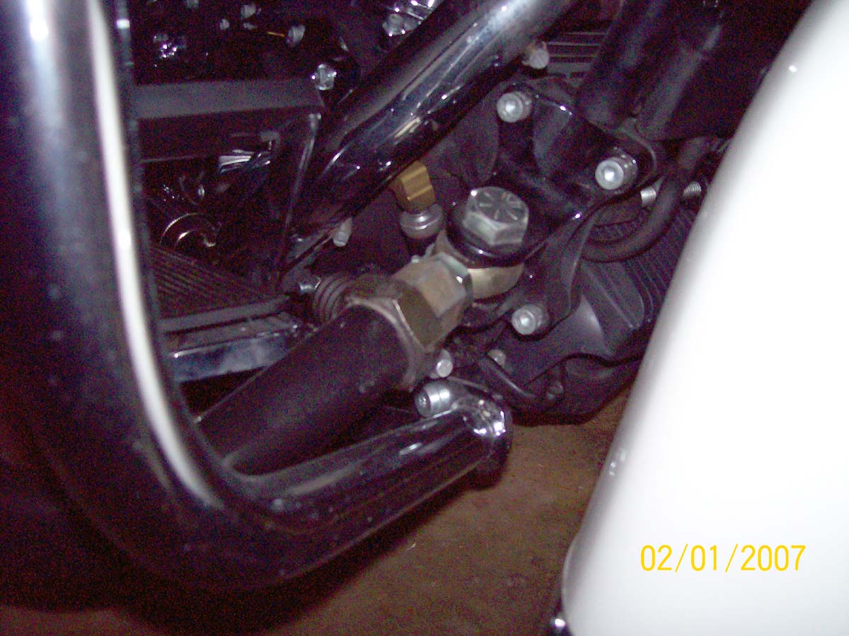

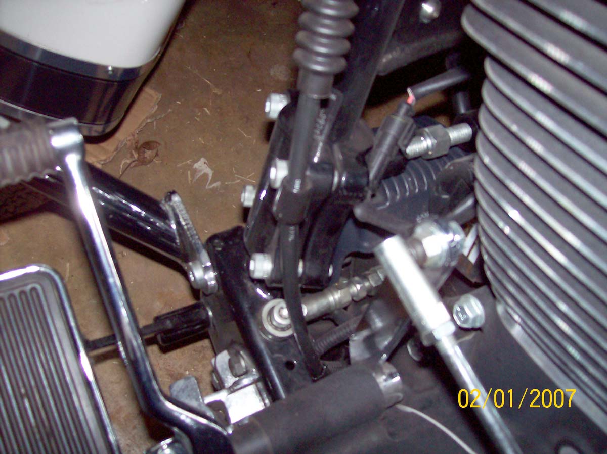

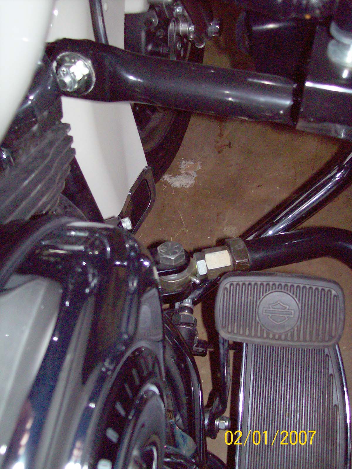

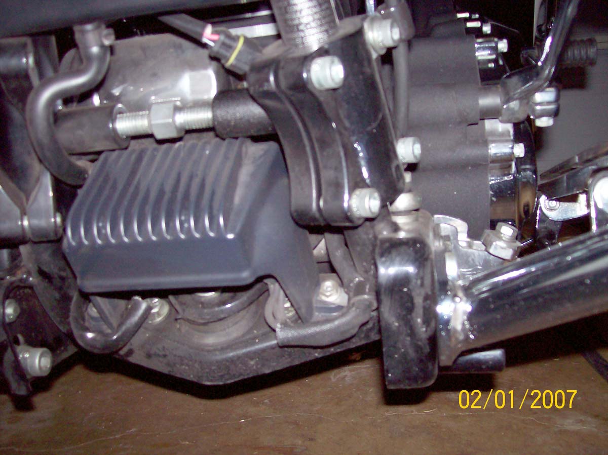

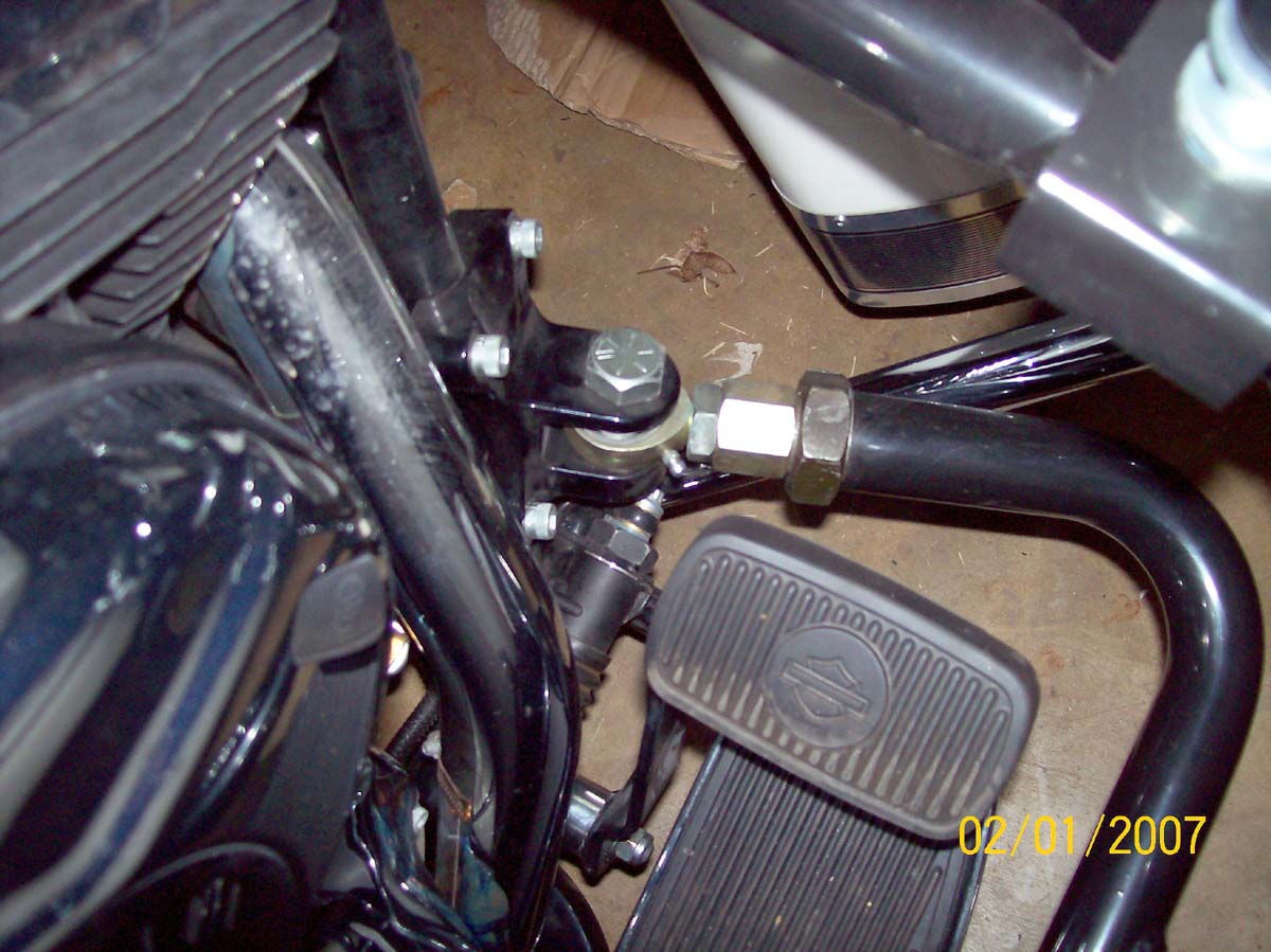

Here are some pictures that I have in my computer. With credit to RD.
Posted : April 18, 2007 8:42 am
I would like to thank you this is what I needed.

Hi GNM
Glad your 07 Tub is OK- Its usually me who draws the short straw- I am handy to have around so you don't get the problems.
The dealer has now replied to me- he has forwarded the Photos to HD for them to approve a new Body -so fingers crossed, that I don't have to go into negotiation mode- so its looking hopeful.
Your comments about how it possibly could have happened- another clue- it was stuck in the factory for the whole strike period.....
As you are aware there is a 3 month order period for a sidecar, but that doesn't stop me using it in the mean time.
Thanks for your comments.
Paul

Hi Paul,
I think your problem is very clearly a warrantable issue. I would think that the factory would want to have your original tub back for analysis to prevent this from happening in the future to someone else. I believe they will authorize a new one for you and, as I said, it's an easy changeover, probably not more than an hour and you can use the other one in the meantime.
Yeah, anything that is special ordered will take time. I ordered my sidecar on October 13, 2006 and it arrived on January 4, 2007, almost 90 days.
I'm sorry that you are having this problem but I'm certain that they will warrant it for you.
Keep us posted!
