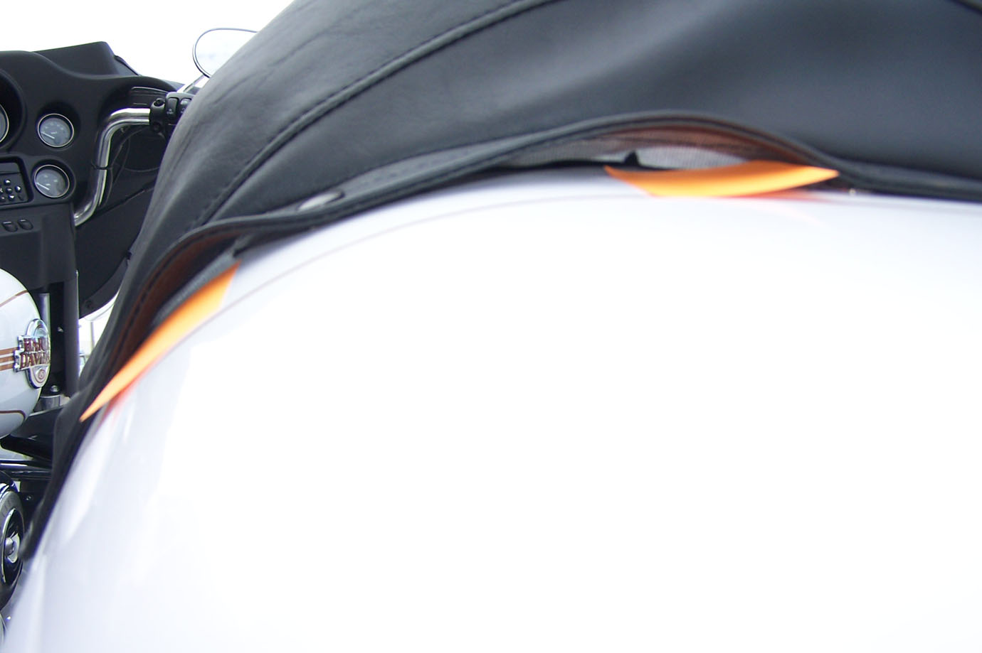

My Bike has the stock setup- so thats why I am surprised at the surging- I presume I have a different engine to yours.?
I enclose pics of the Tonneau cover- not the best of Fits anyone else have this problem.
Paul
