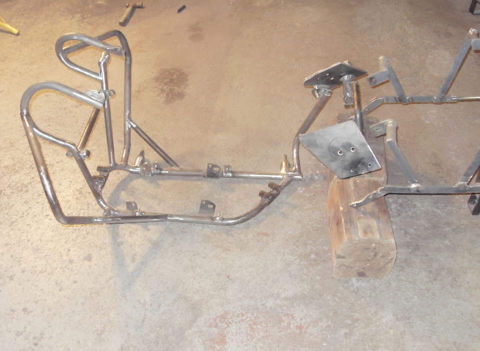

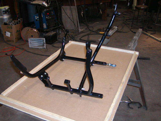

The idea is to define as many attachment points as possible and then connect the dots with the actual subframe. The steering head area is important and a good attachment point but you may have to jump through some hoops to make it happen.I don't have Honda dream here to look at but you get the idea. This type of delima is not uncommon with today's bikes as more and more are going to aluminum perimeter type frames with engines either as stressed memebers or haning off the frame above etc etc.
Crashbars typically are not a good attachemnt point as Lonnie mentioned although where they attach may or may not be sufficient as one on the subframe mounting points. Spreading the load is the key. You may end up with a subframe that almost looks like you built another motorcycle frame but so be it.
See attached pics
Posted : November 18, 2010 1:29 am
