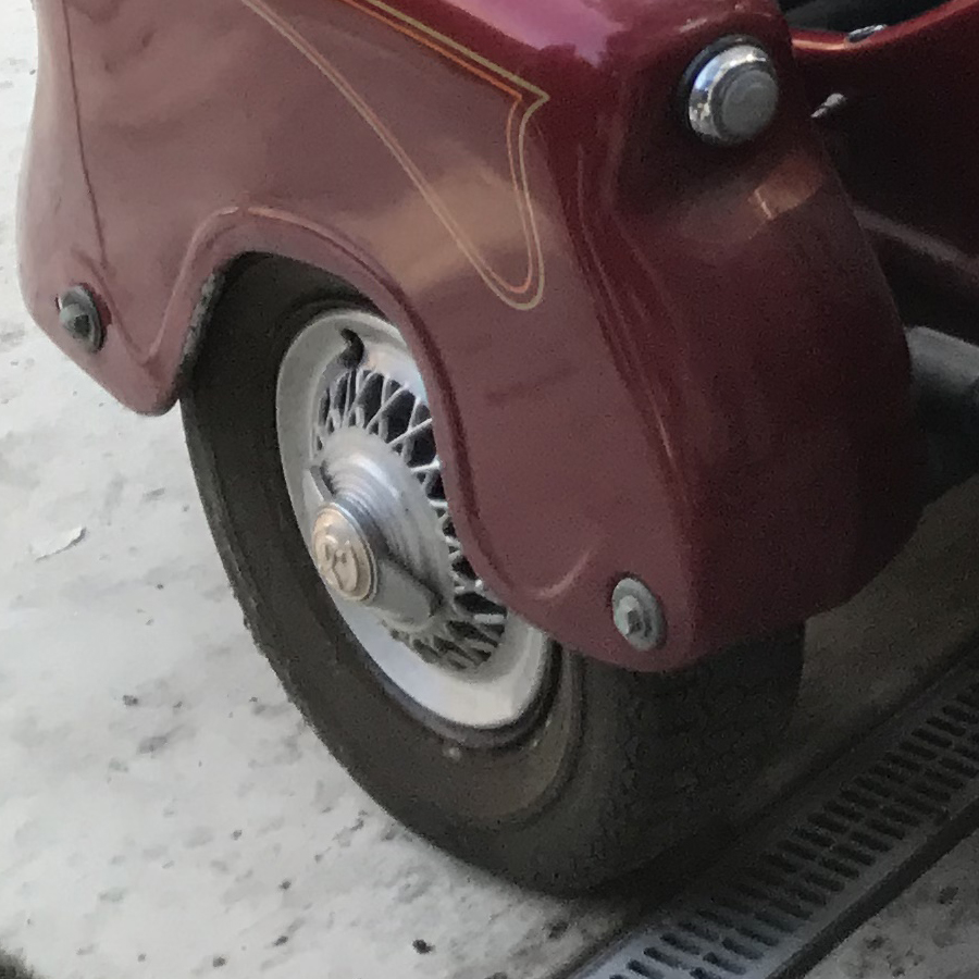

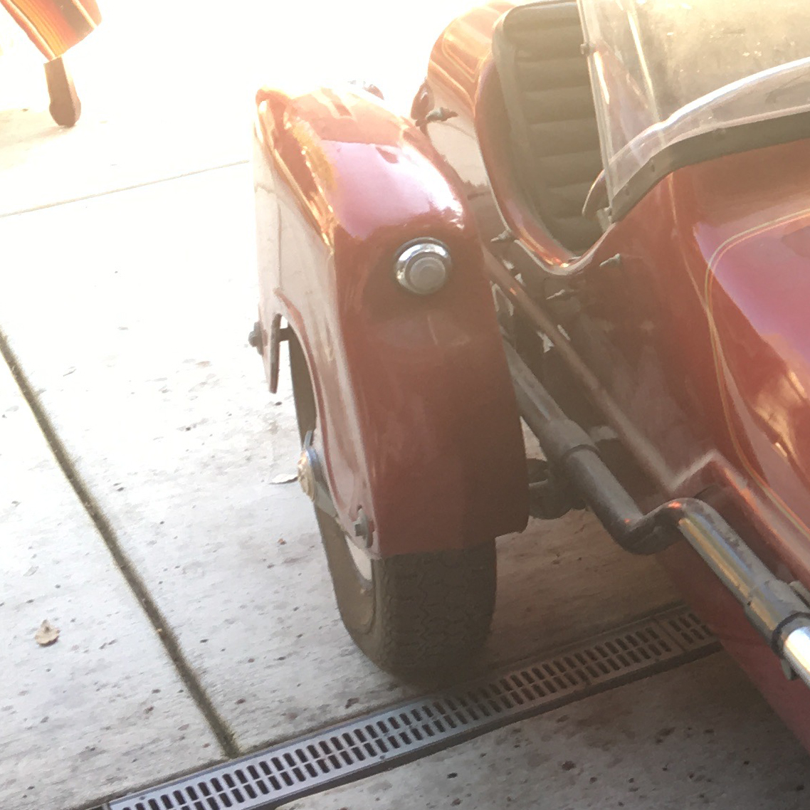

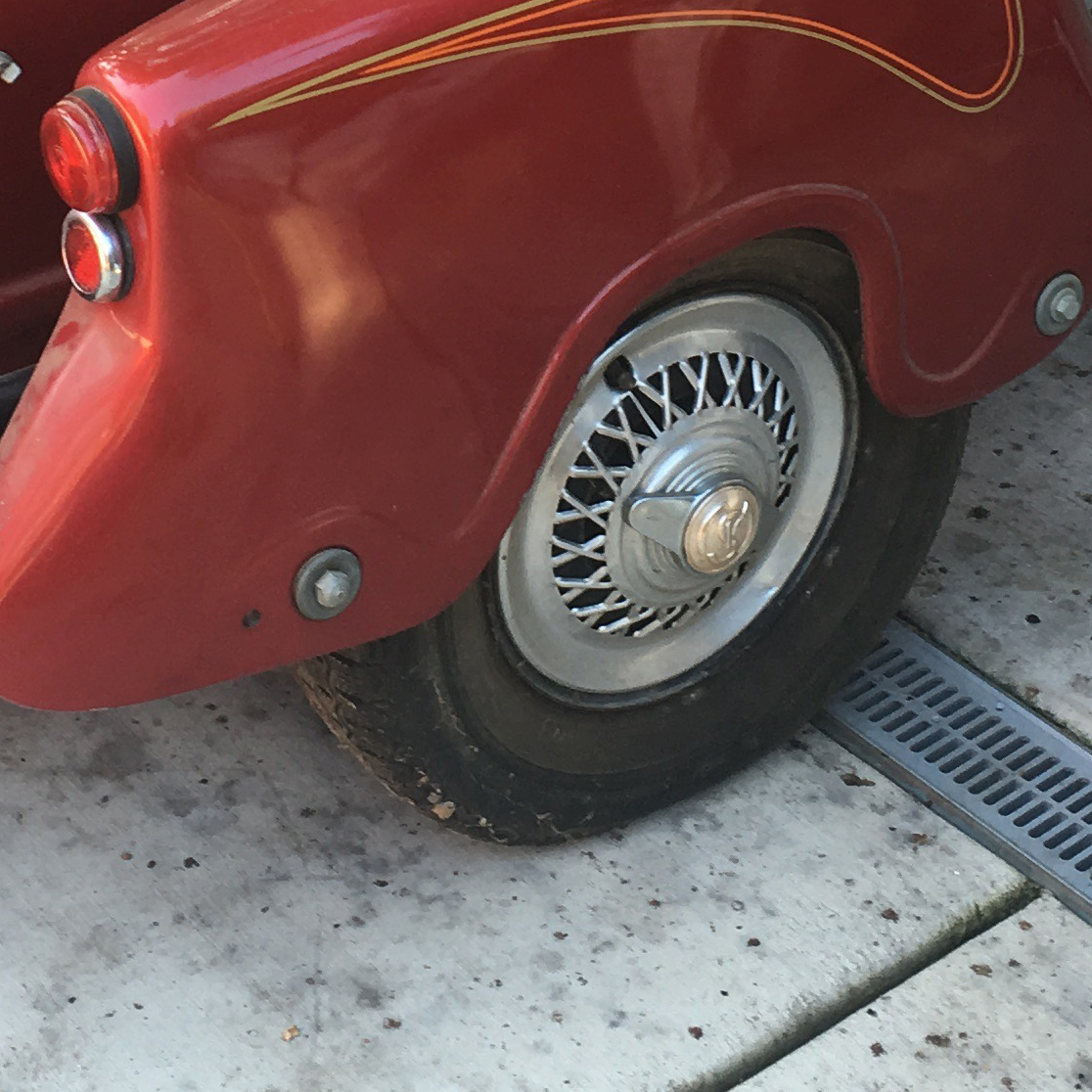

A 1.45 x 10 ? Sorry, you sound like a troll. Do you have a picture of this alleged tire?
Because, readers, a 1.45 tire would be a width found on a bicycle, and not a "fat tire" bicycle either. And a 10 inch diameter? Really, post a picture if you would have us believe this.
Maybe, just maybe, I might believe you if you said it was a 145x10. But not a 1.45x10.

You're likely right that it's a 145. I'll post a few older pics now and get a photo of the sidewall next week. Thanks.

If you want a 145R10, there are a half dozen eBay sellers that ship various European tires that fit old Mini-Coopers.
Or you could buy that steel-belted radial from Camac that sells for $70 shipped on eBay.
But I think I'd go for the Vredestein Sprint Classic. Costs a little more ($92 from Performance Plus Tires) [LINK] but it's a nice looking hunk of rubber.
Bear in mind that a 145R10 is the same size as a 145HR10 or 145SR10 or a 145/80-R10.
