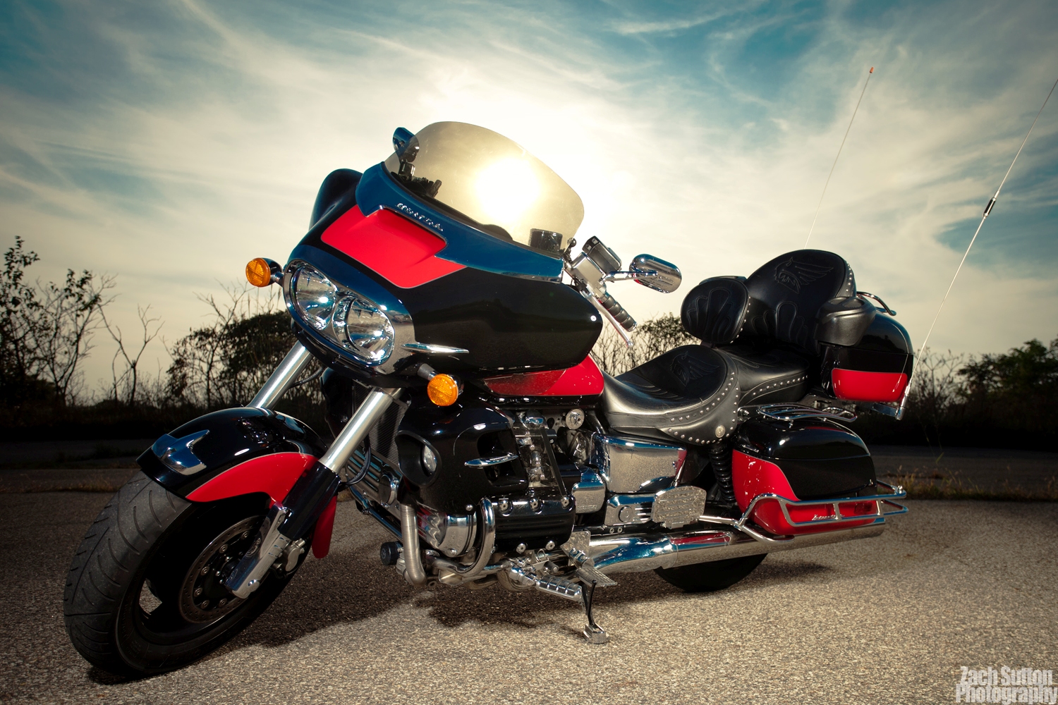

I have a 1999 Valk Interstate and need a Sidecar so my puppy can ride along. Will travel anywhere east of the Mississippi to pick up if the deal and sidecar is good.

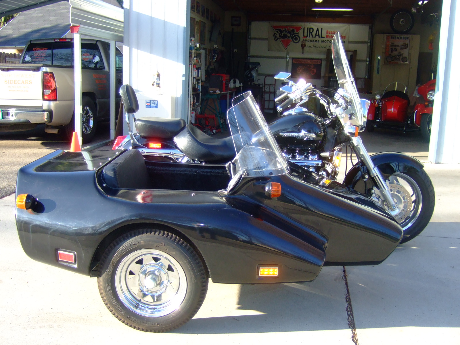

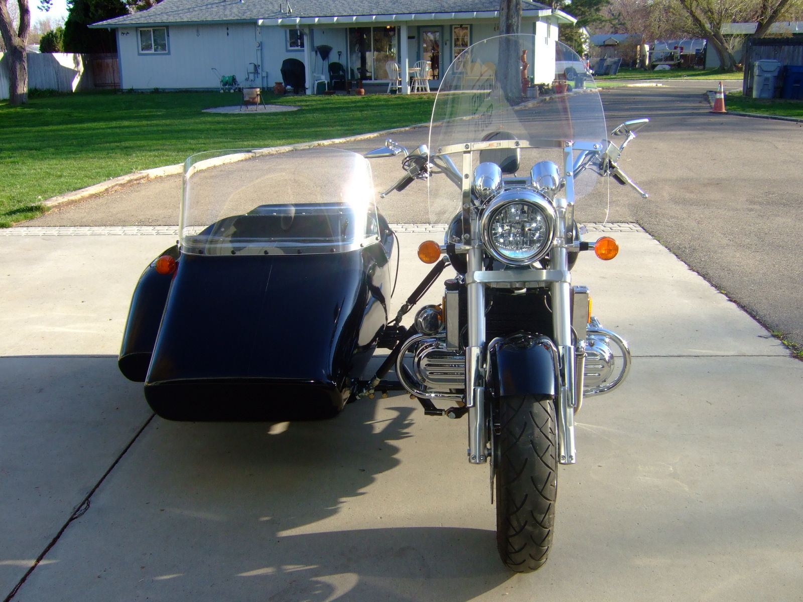

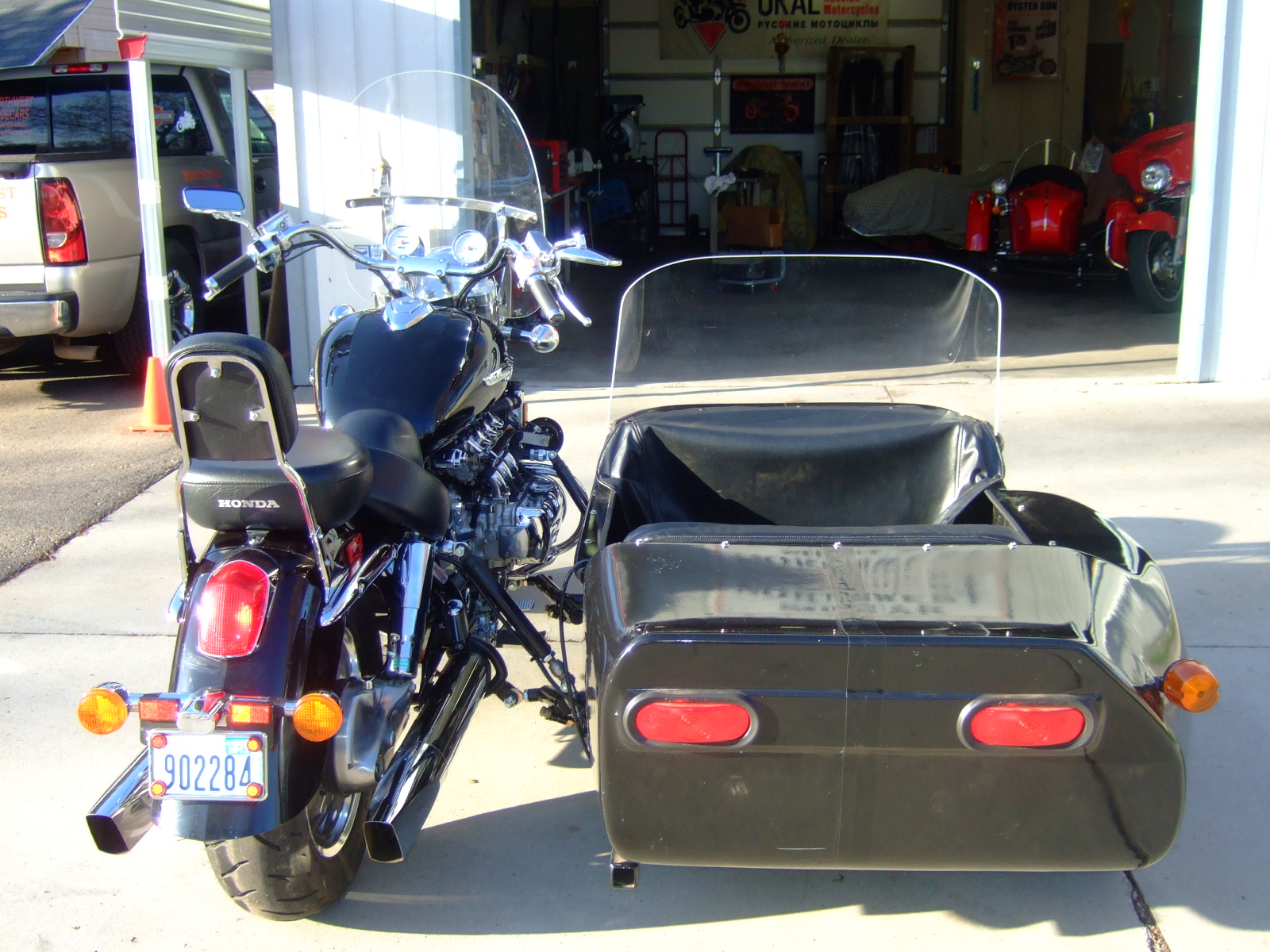

Here's a Kenna double wide we mounted to a Valk. Good match, great handling (and room for more dogs than the Single).
