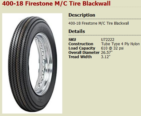

This is as much a question than a suggestion. I have a couple of those Firestone tires found on a lot of resto-builds. Personally I think they look hideous on those builds, but thought they might be ideal for sidecar duty?

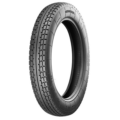

The Heidenau square tire you want is the K28. Pic---->

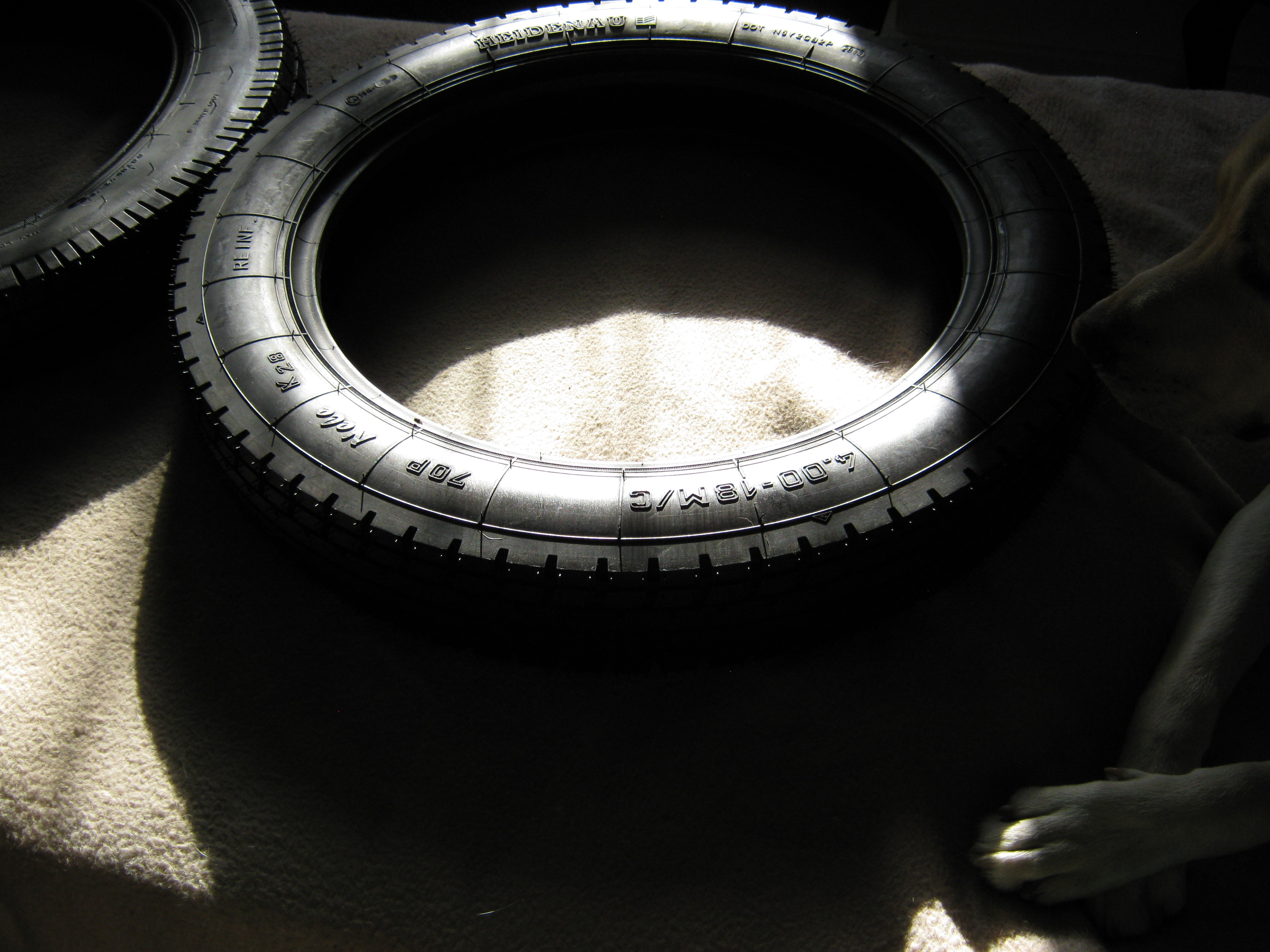

Has anyone ordered a Metzeler 4.00 X 18 Block K and the tread width is only 3.50?Is this just a typo or are all of them like this?Referring to the pic the tyre on the left is the Metzeler Block K 4.00 X 18 and the other is a Heidenau K28 4.00 X 18.
