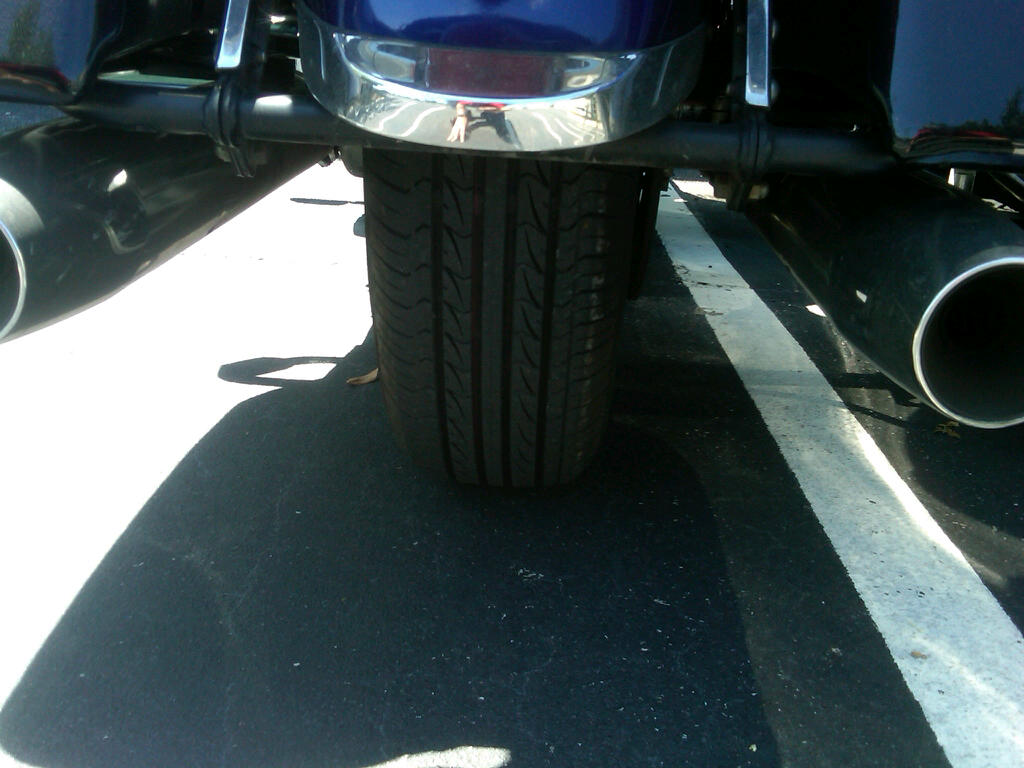

I am running a nexan 165/80/15 tire on my rear. Had no problems installing it and so far (2500miles) no issues and tire still looks brand new. IMHO rig handles great with great traction on wet pavement

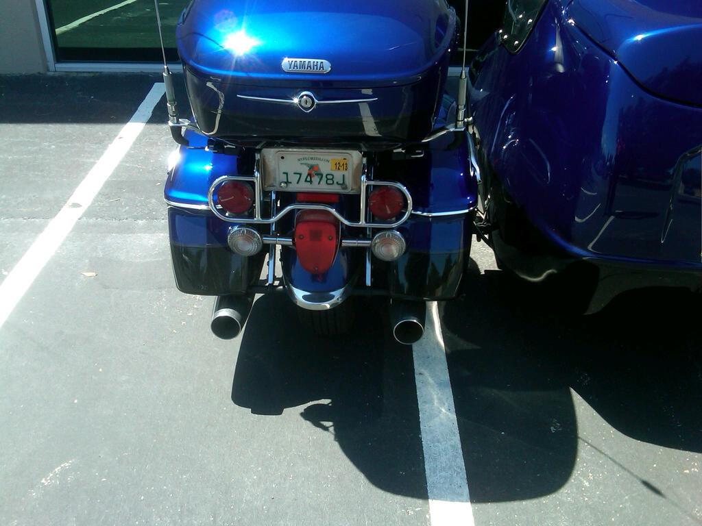

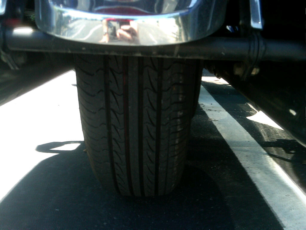

(@petebooth)
Posts: 25
Only just saw your post. Attached are a couplke of pics showing installed tire
Posted : May 15, 2013 6:15 am
(@Vlad1996)
Posts: 7
Looks awesome and thank you for sharing.
