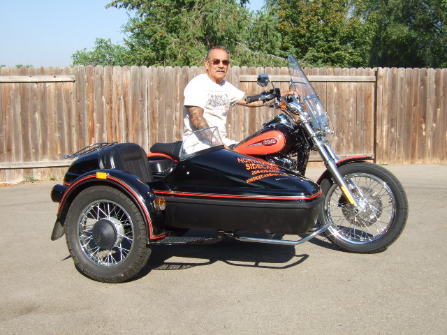

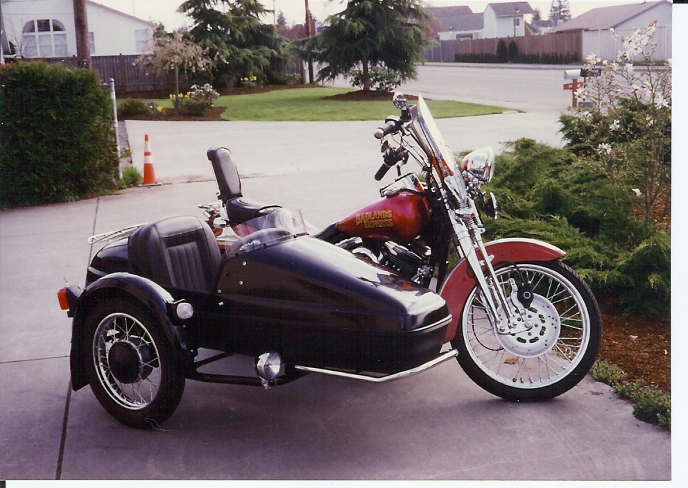

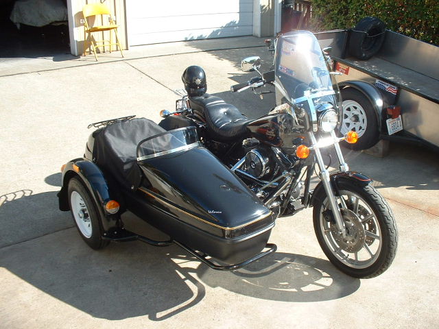

I've put tens of thousands of miles touring with my Velorex sidecars on Harleys (Cruisers) set up for Touring. Never have pulled any spokes out. and never used (or needed) the sidecar brake.
I use a combination of the OEM mounts and propriatory mounts of ny own design.
Having sold and mounted hundreds of the Velorex cars through the years I still feel they are the best bang for the buck of any sidecar presently in US the market. I only stock two models now that are the most popular, the 562 Cruiser and the 563 Tour model. Both come with all factory accessories and gloss black finish. No list of added $$$$ extras to jack the price up.
Not perfect but a good value. Not made for the big touring bikes but great for anything from large scooters to middleweight Cruisers.
Here are a couple of my personal past touring rigs with Velos. I have a full dress Harley touring bike now so it needed a large heavy car. Ergo; a Liberty.
