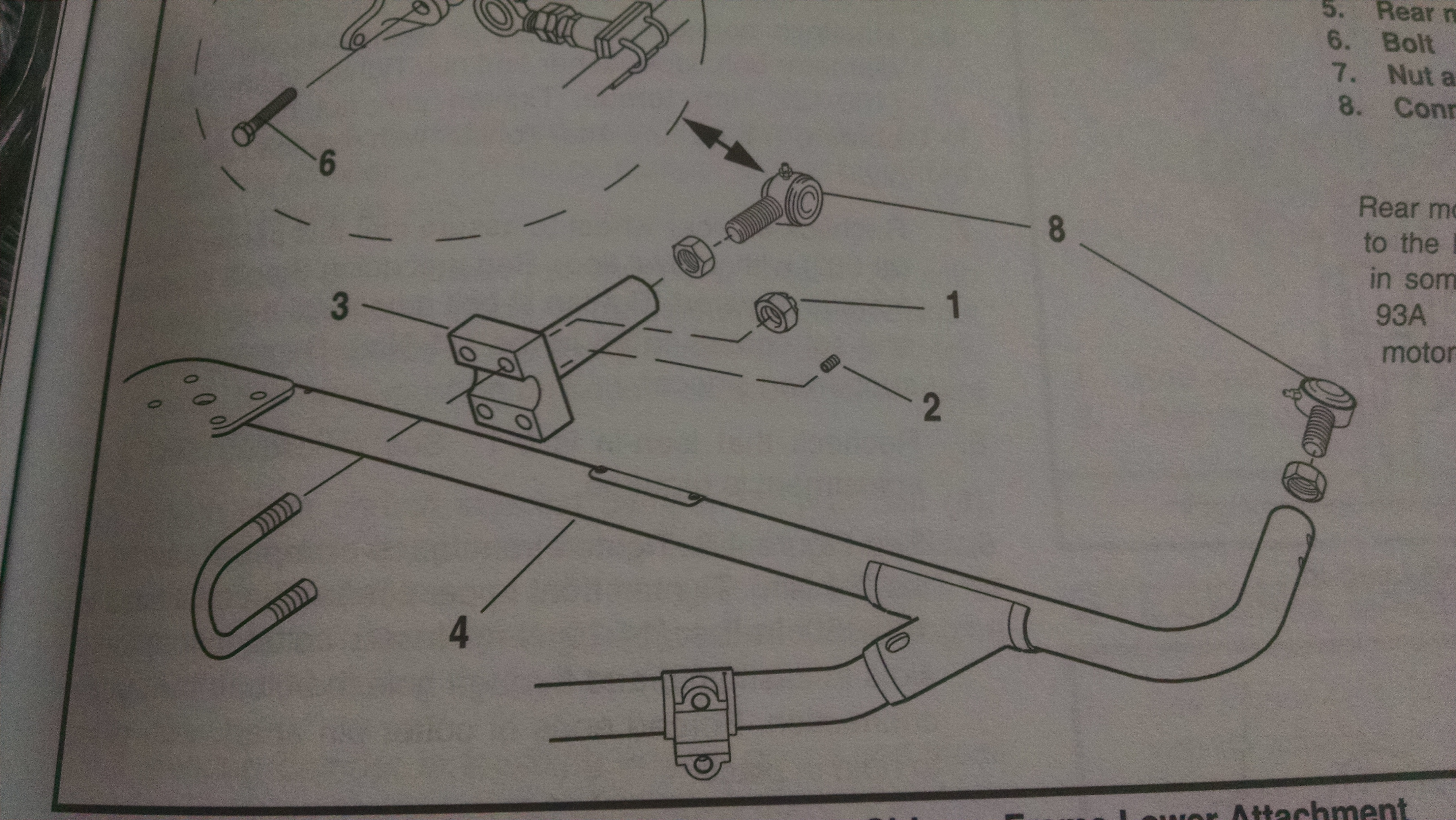

I bought a 91 Ultra w/sidecar. Ordered service manuals for both. The manual for the sidecar said the toe in difference in the front should be 3/4 - 1" smaller than the back. Mine is almost 4". Manual does not tell how to change the toe and I've read it at least 5 times thinking I missed something. And yes it is a Harley Davidson manual. Can anyone tell me how to make this adjustment?

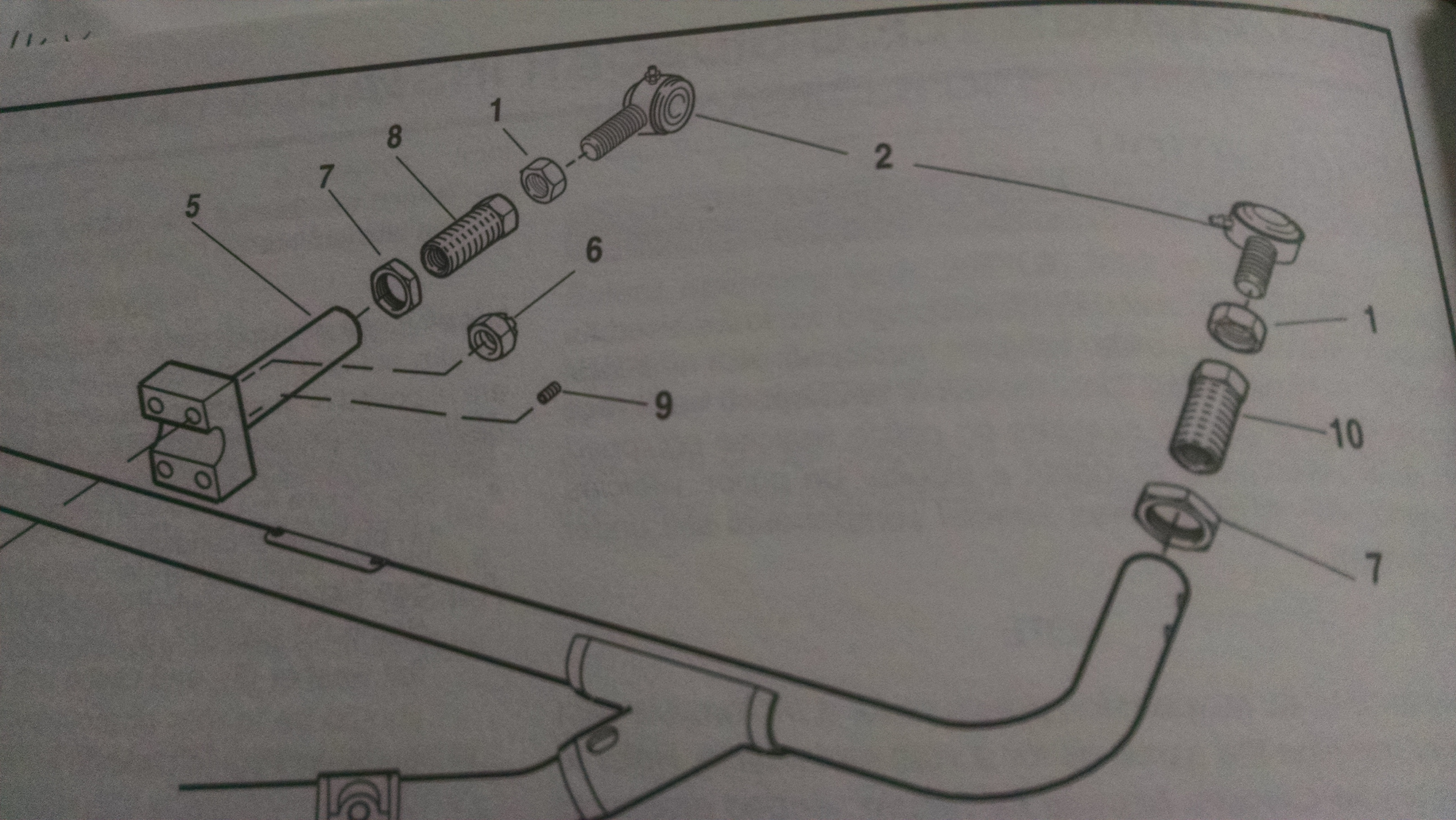

Is it also a 91 sidecar? If it is an older Harley sidecar, you will have to take the sidecar off to adjust the rod ends on the lower mounts. Newer Harley sidecars have adjusters on the lower mounts that allow toe-in adjustment without taking the sidecar off. That started maybe around 2002 model year sidecars. It sounds like you will have to screw the rear mount rod end further into the sidecar frame tube and maybe screw the front rod end out of the sidecar frame tube. Some combination of those should get your toe-in back to where it should be. You may also have to adjust the front brace after that to get your lean correct. Attached are pictures from a newer service manual to show you the difference.

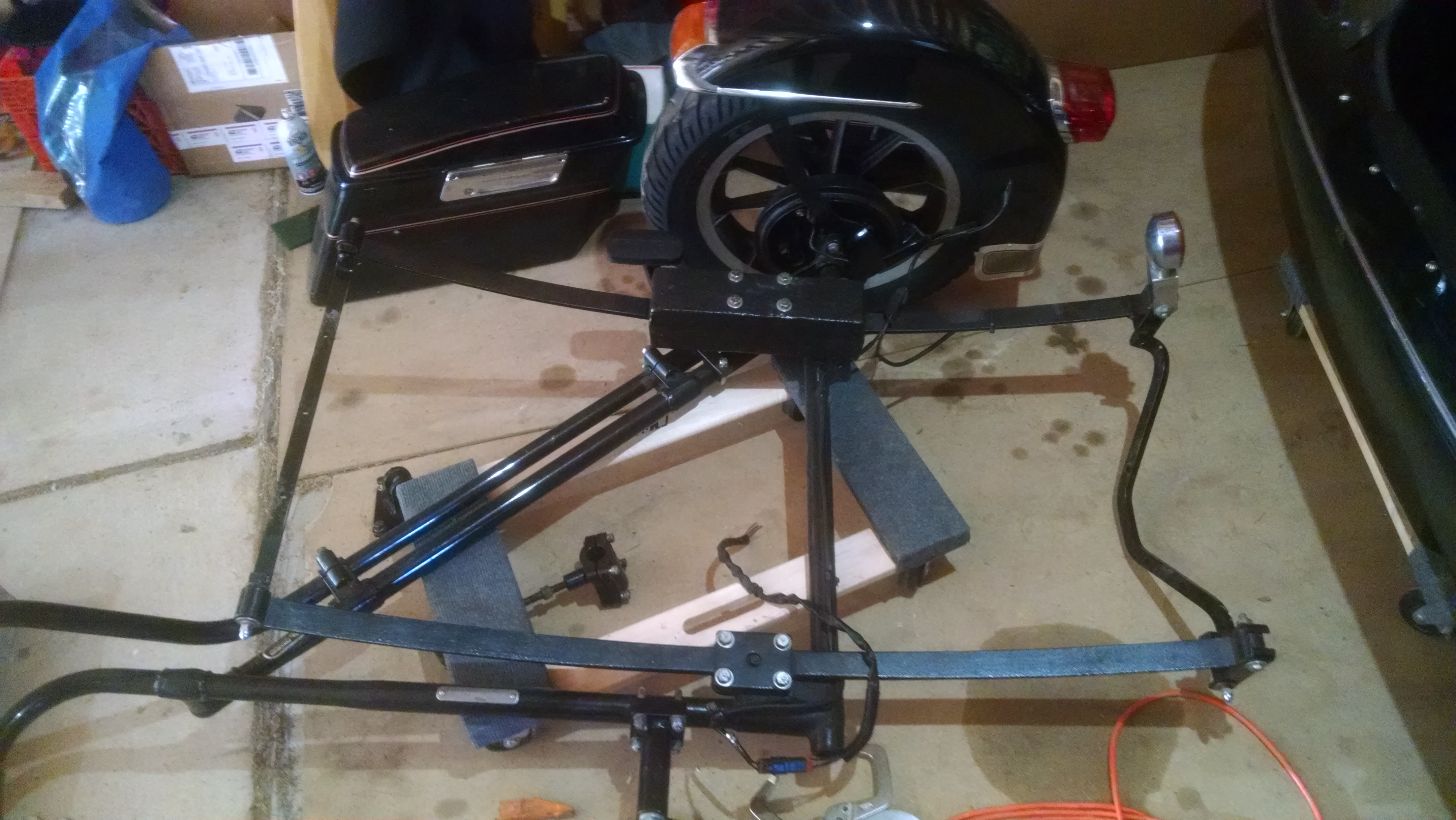

Dave, looking at the pic of your chassis, are you talking about setting level at the crossbar that your wiring goes across?

Yes, it is the rear frame crossbar that should be level. There's no good way I know of to put a level on the wheel on the drum brake Harley sidecars so using the frame is the way I did mine. Here's a picture of my old Harley sidecar that I had before I got the Lak frame. The frame crossbar that is approximately in line with the wheel needs to be level and that should make the wheel plumb.
